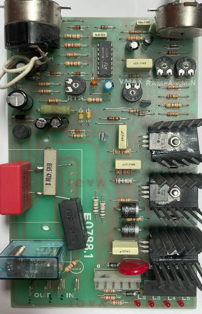

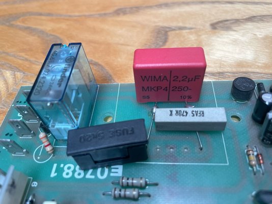

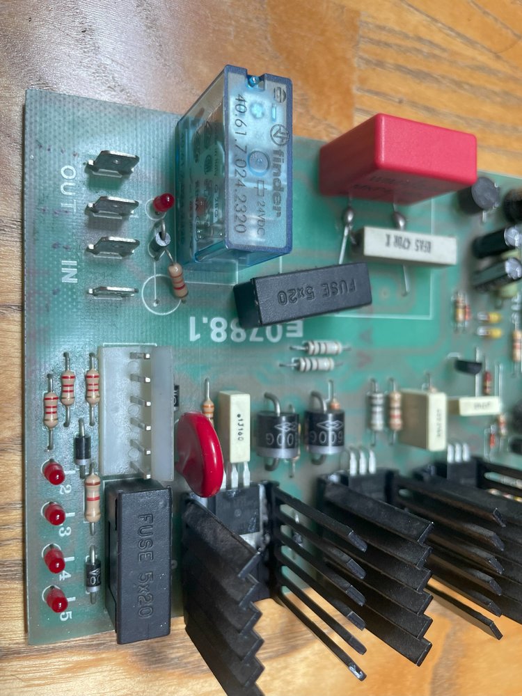

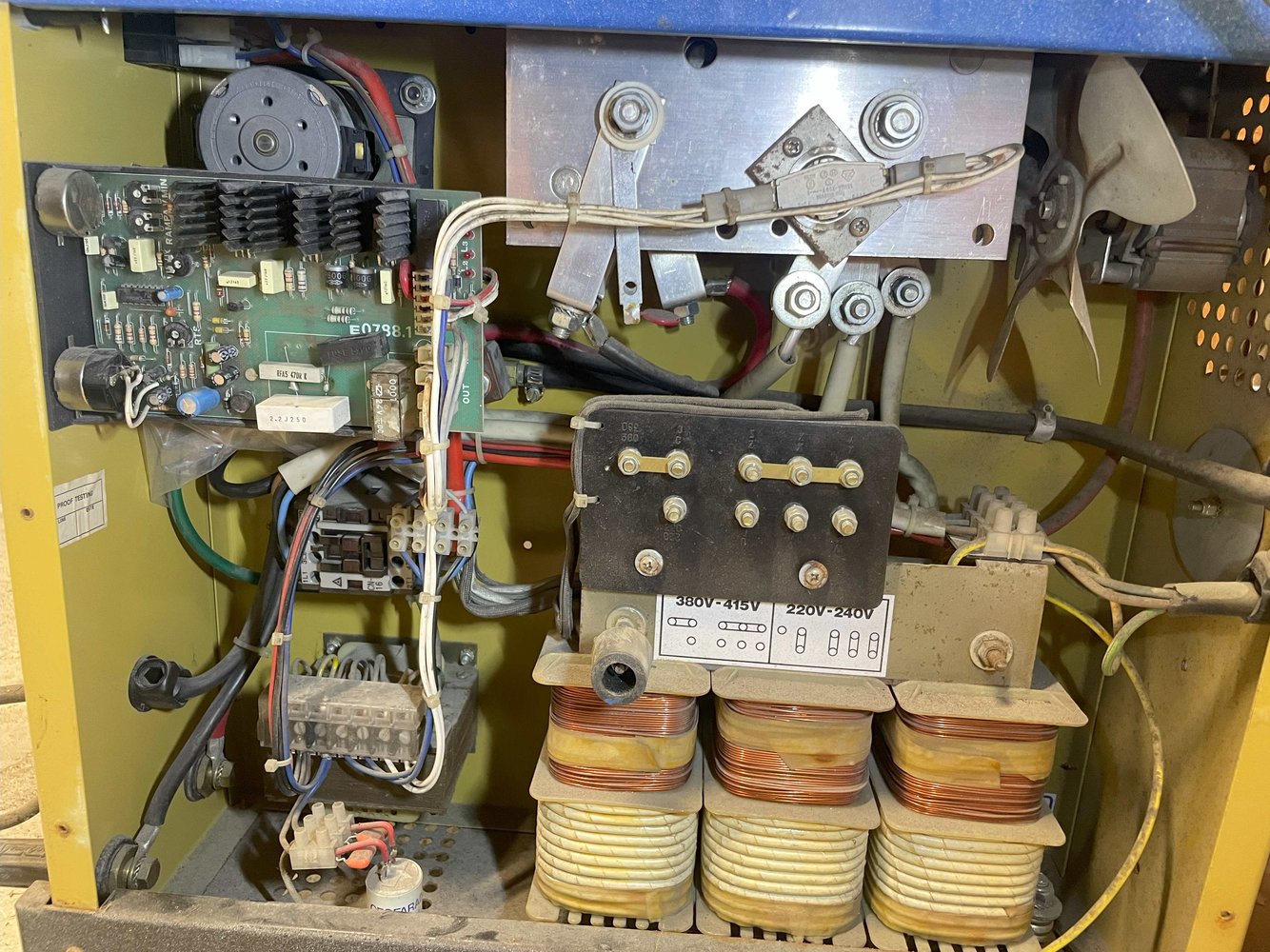

Assuming that the circuit diagram in Post #6 of this thread is more-or-less applicable to your newer PCB:Have the PCB on my desk and the welder is at home. So powering up the PCB should be possible without the welder itself. I do have an adjustable PS here but only DC. To power up the board I would need 24V AC on Pins "IN" to the right. Correct?
Sending 26v AC from an external supply into the PCB is OK, and I assume you have measured the same AC voltage on the secondary of the auxiliary transformer in the welder?Input 26V AC (same as from Welder) which should be fine when rated 24V, correct?
LED4 lights up. When shortening the trigger posts (Pin 5 and 6) LED3 comes up and the relay buzzes. Assume a missing load of some kind.
Rectifier WL02 output measured is 32,7V DV.
Diode 1N4001 to left of the rectifier gives same result (0,6V) from both polarisations. Unsoldered it and tested good. Replaced it (using IN4004) and got the same result when soldered in. So this must be by design.
Both black caps on the top left just over the rectifier are pretty warm.

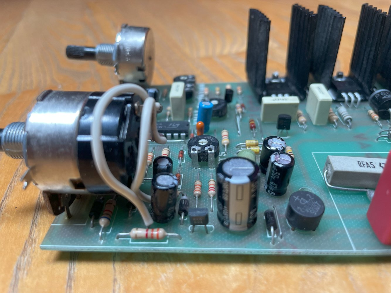

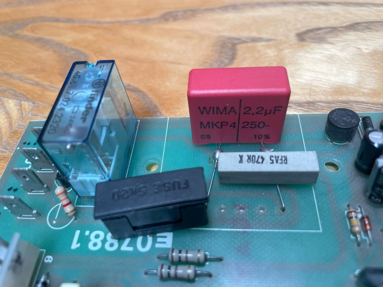

Found a presumably faulty solder joint at the 2.2J250 cap. Reworked it.
NOW PCB is back in the machine and I get a click and an arc every time I press the trigger. BUT yet I don't get wirefeed. TBC I'd say.
Hello Hutcho, yes it's off and I removed the switch from the equation by unsoldering one of the two white wires that sit on the back of the potentiometer.Don’t suppose you have the spot timer on at all - just a thought

the tags marked "IN" and "OUT" to the right are for AC power that feeds the small on-board transformer, and for the relay-switched output to the coil of the contactor. It is possible that in your case "IN" is the low-voltage AC from the secondary of the off-board auxiliary transformer, bottom left under the contactor. You could trace the wires from the secondary of that transformer to the board, or trace the tracks on the board from the two AC inputs on the small circular rectifier ( marked with "~" ).Clarke 250T Blowing PCB fuse!
When closure of the torch trigger switch is simulated, the 24v relay should simply "click" closed; it should not buzz. The only load that a relay has is current through the contacts, and the operating coil does not know or care about that.
Seeing about 33v DC after rectification of a 26v AC supply implies that there are smoothing capacitors, which raise the voltage from RMS towards the peak value ( x 1.414 ).
As voipio wrote in Post #12, that 1N4001 diode is wired across the relay coil, to suppress reverse voltage spikes induced when the relay is de-activated.
Capacitors should never get warm. You could check them for short-circuits, but may have to remove them from the rest of the circuit on the board to do this. There is a 220 Ohm wirewound resistor nearby which may be getting warm.
As Hutcho suggested, the "On" time of the relay may be influenced by the variable Spot timer. The On/Off switches on the back of timer potentiometers have been known to fail.
With the PCB back in the machine, does the contactor close every time you press the torch trigger? Do you get welding voltage ( from about 15 to 30 v DC ) between the MIG wire and the work return cable?

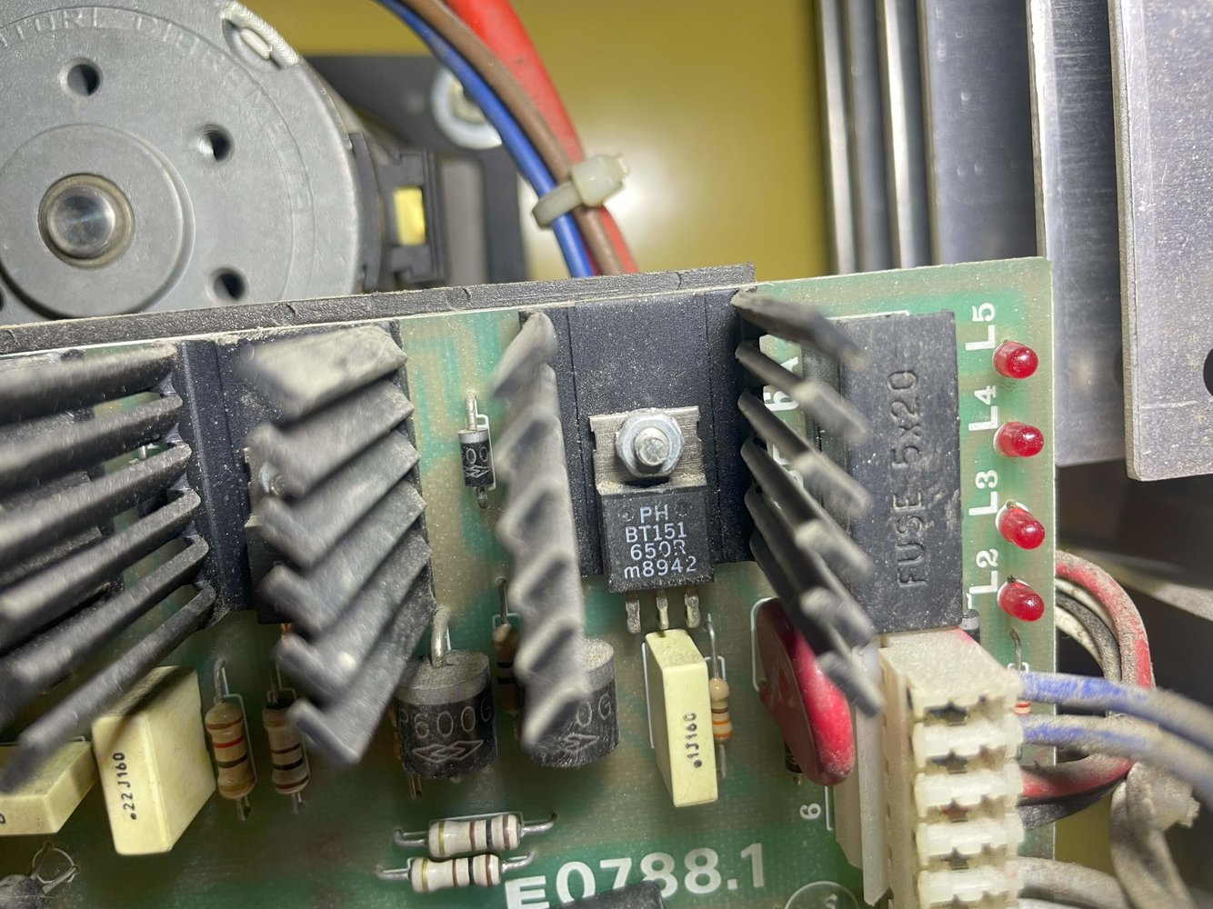

Power for the wirefeed controlled rectifier comes from a separate winding on the main welding transformer, via the two blue wires on Pins 1 and 2 of the 6-pin board connector.

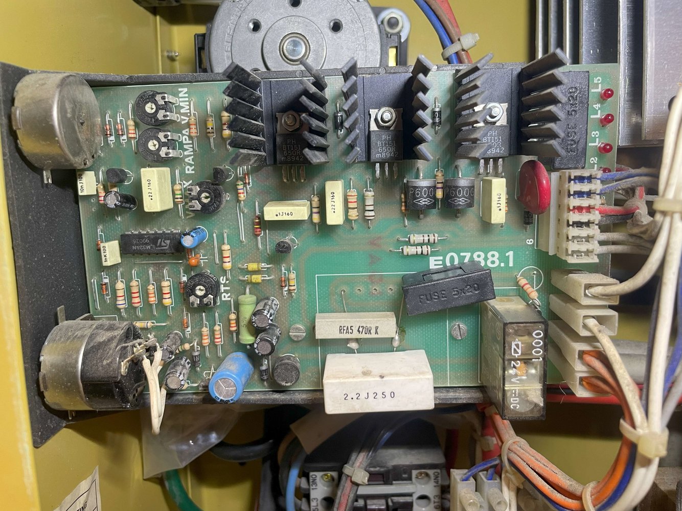

* no nothing is not exact. The PCB is powered and LEDs light up as before. They are connected to the plug pretty direct so pressing the trigger triggers LED L3 (pin 5) , L4 (pin 6) and L5 (to pin 1) light upon power on whilst L2 (pin 4) stays off. -> so this should tell us that the torch trigger itself works and the board is not even triggering the feed motor. Correct?Hello eddie, first of all MANY THANKS for your help and sharing off your profound knowledge!
No luck today:
* unsoldered one of the two white wires on the back of the spot welding timer to take this switch out of the equation and (like the day before) pressed the trigger.

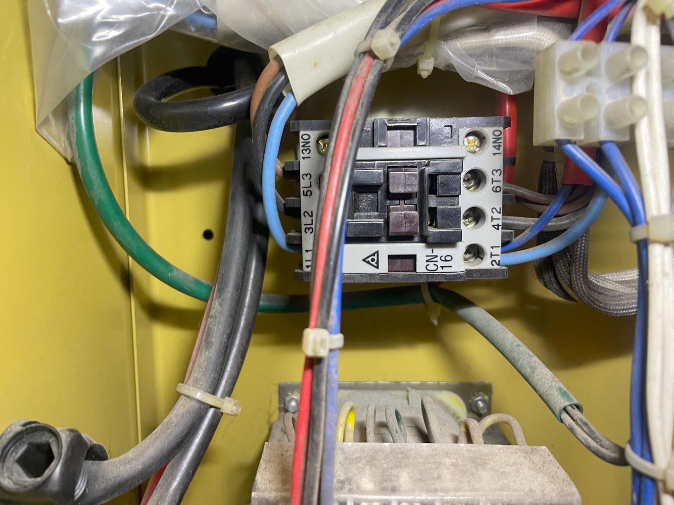

* main contactor "pulled on" each and every time.
* I can also confirm that I got an arc but NO wirefeed. -> So far "welding" part seemed to be fine.
-> All of a sudden "trigger press action" stopped and now I am back where we started... press trigger, no nothing. Feels like a thermal issue...

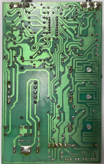

Hello Eddie,The capacitors appear to be part of the 24 - 26v AC supply coming in on Pins 1 and 2 from the external medium-sized transformer, which replaces the small on-board transformer that is used on other versions of this board. I do not have photos of both sides of your board so I cannot trace the exact wiring. The rectangular "2.2J250" component looks like a metallised-film/polypropylene mains noise filter capacitor, a "WIMA-type" capacitor, and these often fail.
As Hutcho pointed out, the Spot Weld Timer circuit, which holds the relay on for a preset, variable time after the torch trigger switch is pressed, does play a part in the reliable on/off operation of the relay. Do you ever use this Spot feature? If not, then one way to bypass the intermittent relay On/Off problem would be to alter the circuit so that the 24v relay is simply switched directly by the torch trigger. Many hobby-level welders do this, with the relay coil, at 12v or 24v DC, switched directly by the Eurotorch trigger.
The existing circuit has the trigger switch wires on Pins 5 and 6, then some debounce components and the LED indicators, the Spot timer, the ZTX601 NPN Driver transistor, and the relay coil. The ZTX601 is a 160v, 1A, 1W component, available on eBay UK. It is in a TO-92 case outline, so when looking at the flat face, the pins from the left are Emitter, Base, Collector. Datasheet here:
At rest, there will be about 20 volts across the transistor from the Collector to the Emitter. As an NPN transistor, it will conduct when the Base goes positive with respect to the Emitter. When conducting, the voltage across it from the Collector to the Emitter will drop to almost zero ( like a closed switch ), and that voltage will then go to the relay coil and operate the relay. By monitoring the rise in Base voltage, with respect to the Emitter, you can see if the transistor is being enabled into conduction every time the torch trigger is pressed. Then checking the falling Collector to Emitter voltage will confirm if the transistor is actually going into conduction.

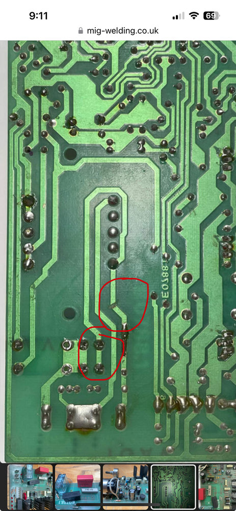

Ok I can see the fuse is bridging the track now - sorryIs this track cut ? Also has the relay got enough solder ? I can’t tell from my phone .

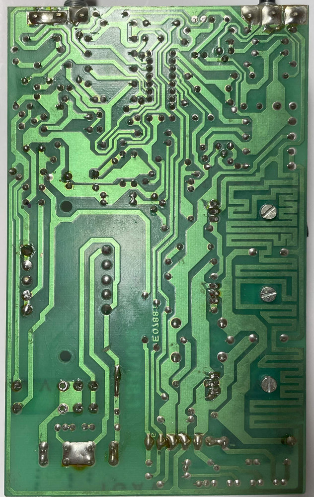

I replaced the Darlington transistor and the rectifier that came in today. Didn't resolve the issue.To check for an intermittent contact failure, you could try gripping the left & right or the top & bottom edges of the PCB with two hands and twisting the board.
The "buzzing" relay - does it sound like 50 or 100 Hz ? If so, maybe something is shorting or dropping half of the AC cycle in the supply from the auxiliary transformer.
If the buzzing is slower than that, it could be a failure in the Spot Timer circuit.
You could remove the ZTX601 Darlington pair transistor which drives the 24v relay, and replace it with a pushbutton switch that joins the track locations for Collector to the Emitter. Pushing the button would simulate the transistor conducting, and the relay should pull in reliably and consistently.
