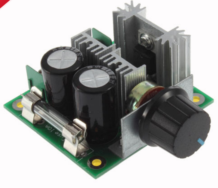

Good idea! I have soooooooo many unfinished projects but I fancy a go at this.You could buy a cheap speed controller from eBay. I've got one for a future project, putting an electric drive on my feed screw, and it seems to work quite well. Cost under a fiver I seem to recall.
Yes it did - http://www.ebay.co.uk/itm/New-12V-4...574988?hash=item2ef6d3db4c:g:r5kAAOSwXeJYHa4u

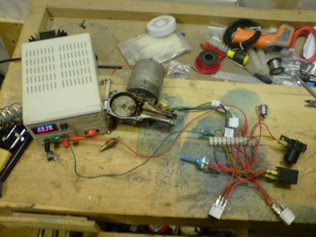

That's what I'm thinking! Or a PC PSU with PS_ON shorted, or one of the many laptop supplies I've got lying around!Now you just need to dig out an old CB psu and yer awayMight even be room enough inside CB psu for the sm controller making it nice and neat.
To be honest, your suggestion of a CB PSU might be the easiest as I'm not sure what switched mode PSUs and a PWM speed controller will think of each other...
Anyways - if you have to find a voltage, then 12VDC is the easiest one to find![]()
