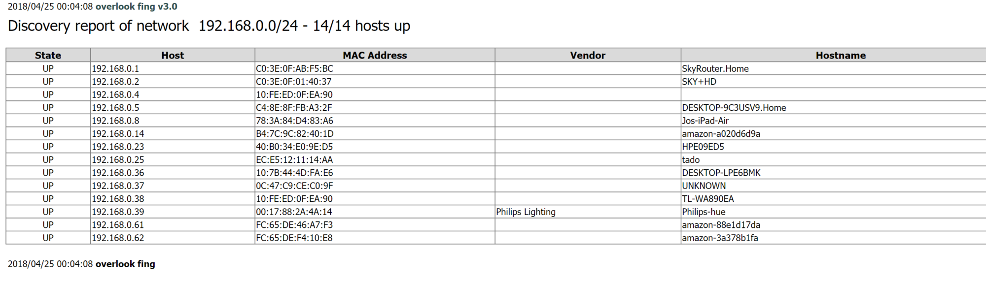

You may have done it or not as I can't tell from the thread but I put instructions to easily establish if it was just name resolution or windows deciding it was on a public network as happens from time to time. No comprehensive but aimed at an unknown level. As far as I can tell it was not attempted but as it is now instead of diagnosing, it is working but potentially unreliable. So as the things I said were based on built in tools I would way you had the tools all along.I had and have turned bits on and off unplugged and swapped but couldn't get to the end of the problem.
At the moment its working but for how long?
Problem is What goes away by itself can come back by itself.
Not enough hours in the day.
At least now if it disappears from the cad machine again i now have the tools to see whats going on.
EDIT> once again thanks for everyone's time and input, very much appreciated.

Not necessarily. Try and ping it
Windows boxes are usually workgroups unless joined to a domain. Workgroups don't mean much at all.
Ping printer by name on a PC that can see it.
Then watch the ping result for IP
Ping it by IP on the cad machine
If it answers you have connectivity (barring firewalls on ports)
You could them connect / map the printer by IP.
However, modern Windows will occasionally decide it is on an unidentified network and filter connectivity so make sure the network is identified as home or work

I discovered that:-
The printer was showing on the network to other pcs with ip adress i could use to acess the print server config settings and would print.
The cad machine was showing the printer as offline, and the properties box gave an incorrect ip address. ( i presume an old ip address that had not updated)
The cad machine would only see the devices directly connected to the switch it was also connected to (NAS units) but although not showing anything else on the network i still had full interconnectivity.
Previously i have on odd occasions lost access to the printer (via cad pc) that is simply restored by power cycling the printer.

So in the above that would typically be pinging your router, easy first test to make sure ping working
So if pinging bob works from everywhere else but....
Then you ping the printer by name say it's called bob, on the affected machine
If pinging bob doesn't work then pinging bob's IP does then there is a problem with name resolution
Now sometimes if a windows box (not on a domain) can't reach the internet it decides it doesn't know what network it is on and decides it is public
When it does this it turns on a load of port blocking that is not on if it thinks it is on a home or work network. You just have to look at the settings and choose home or network. Due to the daft dumbed down interface in later versions wrapped on top of the old style settings boxes I would say use help in your version to navigate to it.
Re the properties box showing the wrong IP
Chances are you are using DHCP and potentially the address changed and everything else picked it up. This would not normally stop you editing the port settings for the printer and putting in the correct IP manually. Obviously this can again break by future DHCP changes
