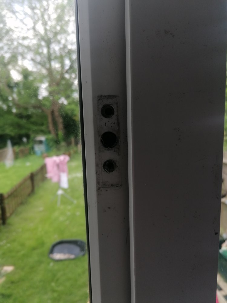

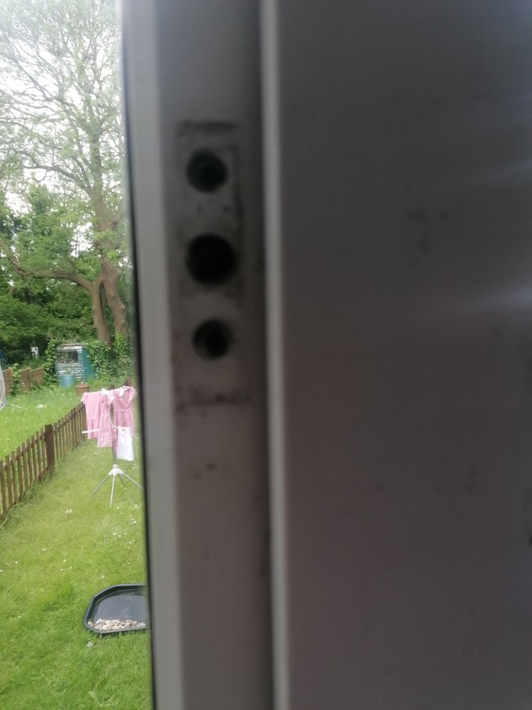

Are you sure you cant grip it up with a rivnut? It will leave a lip on the outside of course but not a lotit is not actually the window frame metal, there is a floating metal plate behind the upvc
Self tapper.I replaced a broken handle on a mates bedroom window today but the top screw would not tighten up, the threads are gone basicly in the metal plate that hold the handle on. The bottom one is fine. So I need a easy fix as I aint taking the window apart to repair it unless I really have to. I did think a pop rivet may do the job.
no its different, it has a lever that throws over and 2 pins one at the top corner and another at the bottom corner. very old windows by the look of themwhat you have inside is the lock mech
and you see where your screws go
which you can buy and refit again to older upvc windows
Same as my mums - installed by one of the iterations of Diamond Seal in the 1990's.no its different, it has a lever that throws over and 2 pins one at the top corner and another at the bottom corner. very old windows by the look of them
