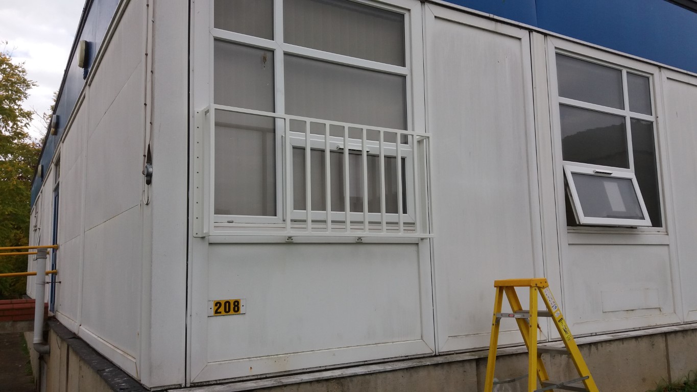

One of our hospitals has had a daytime break in into a drug storage room attached to one of the wards, cheeky gits just climbed through this window which was open and tried to screwdriver open the storage lockers, luckily non of the staff walked in on them.

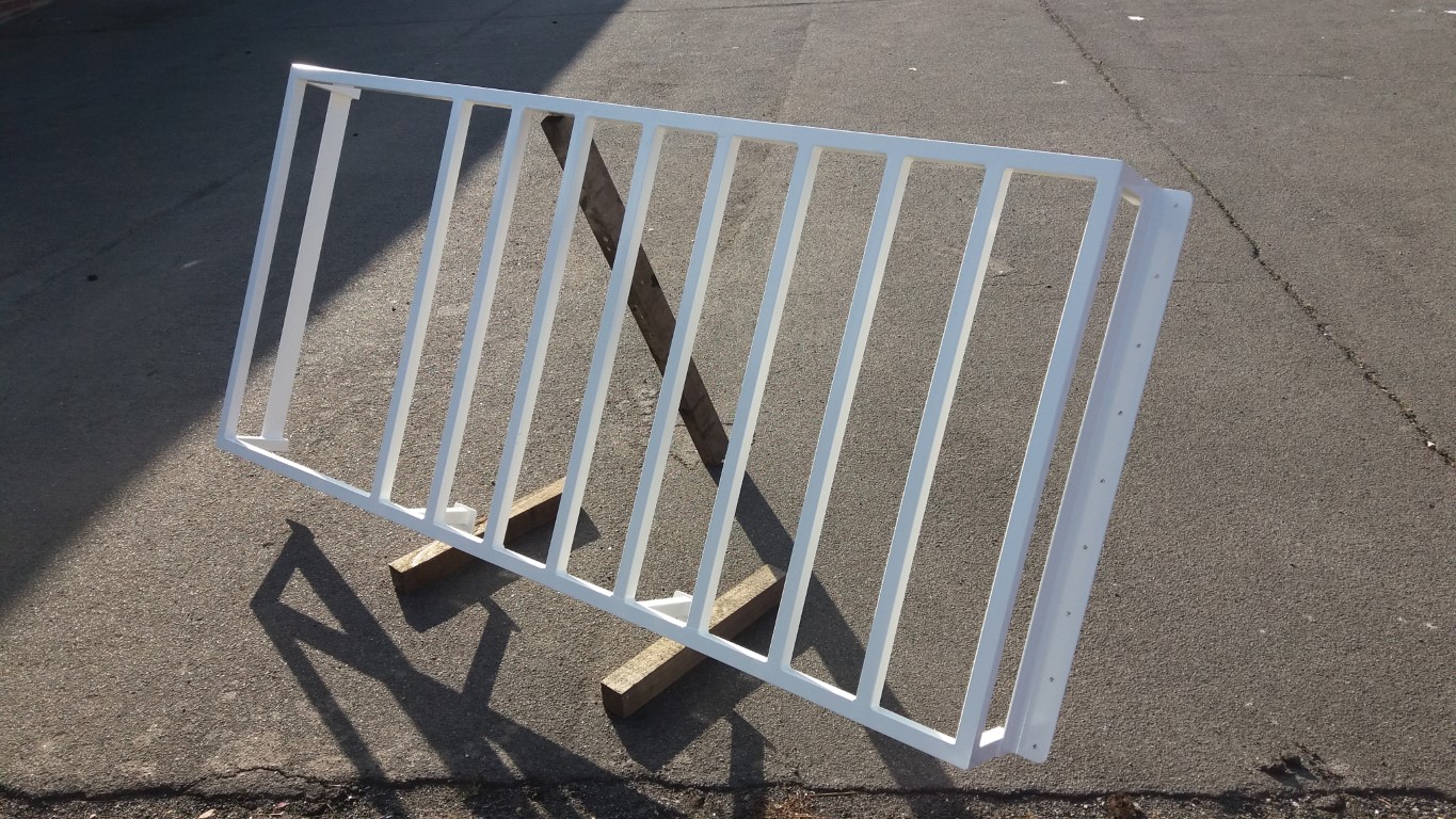

So a grill was asked for, made from 25 x 25 erw mainly because I already had some, and powder coated white, made so that the window can still be opened as they use a portable aircon unit in that room and poke the outlet hose out of the window

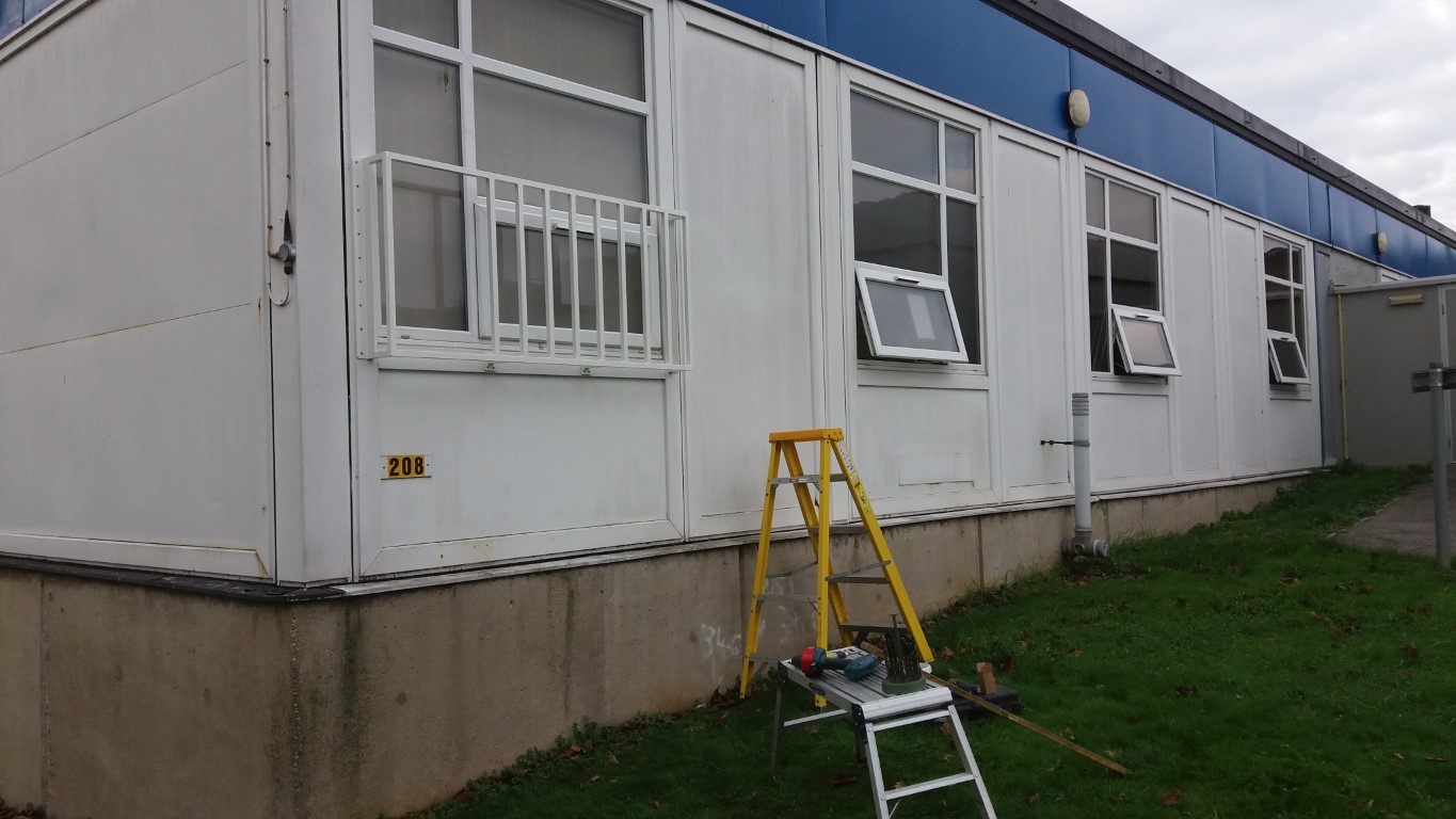

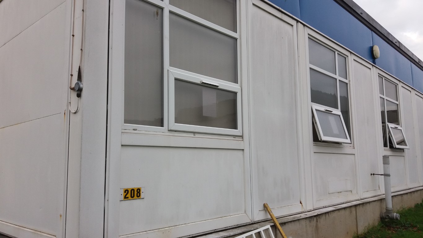

And fitted, the window framework is steel so I used stainless steel self tapping security screws, "put plenty in" they said, so I did.

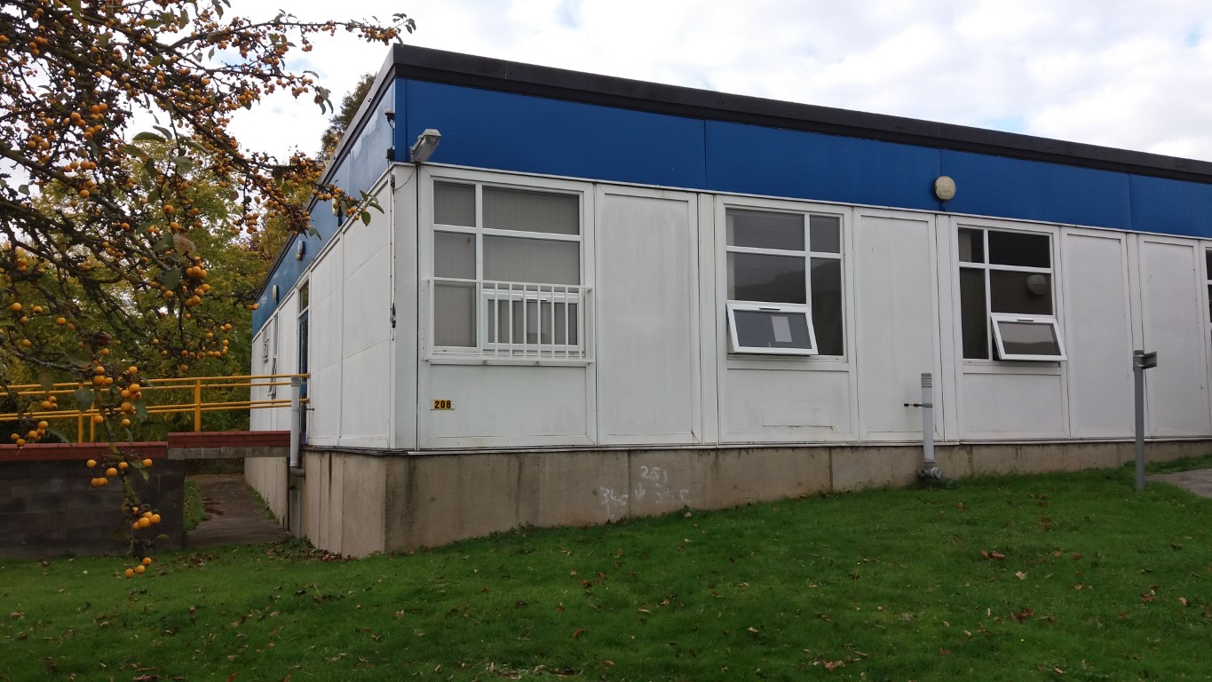

And from a distance, blends in quite well but visible enough to be a deterrent hopefully
