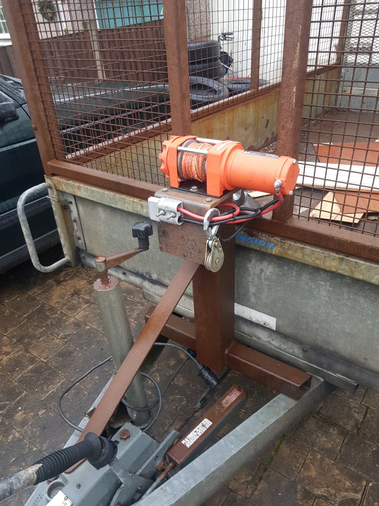

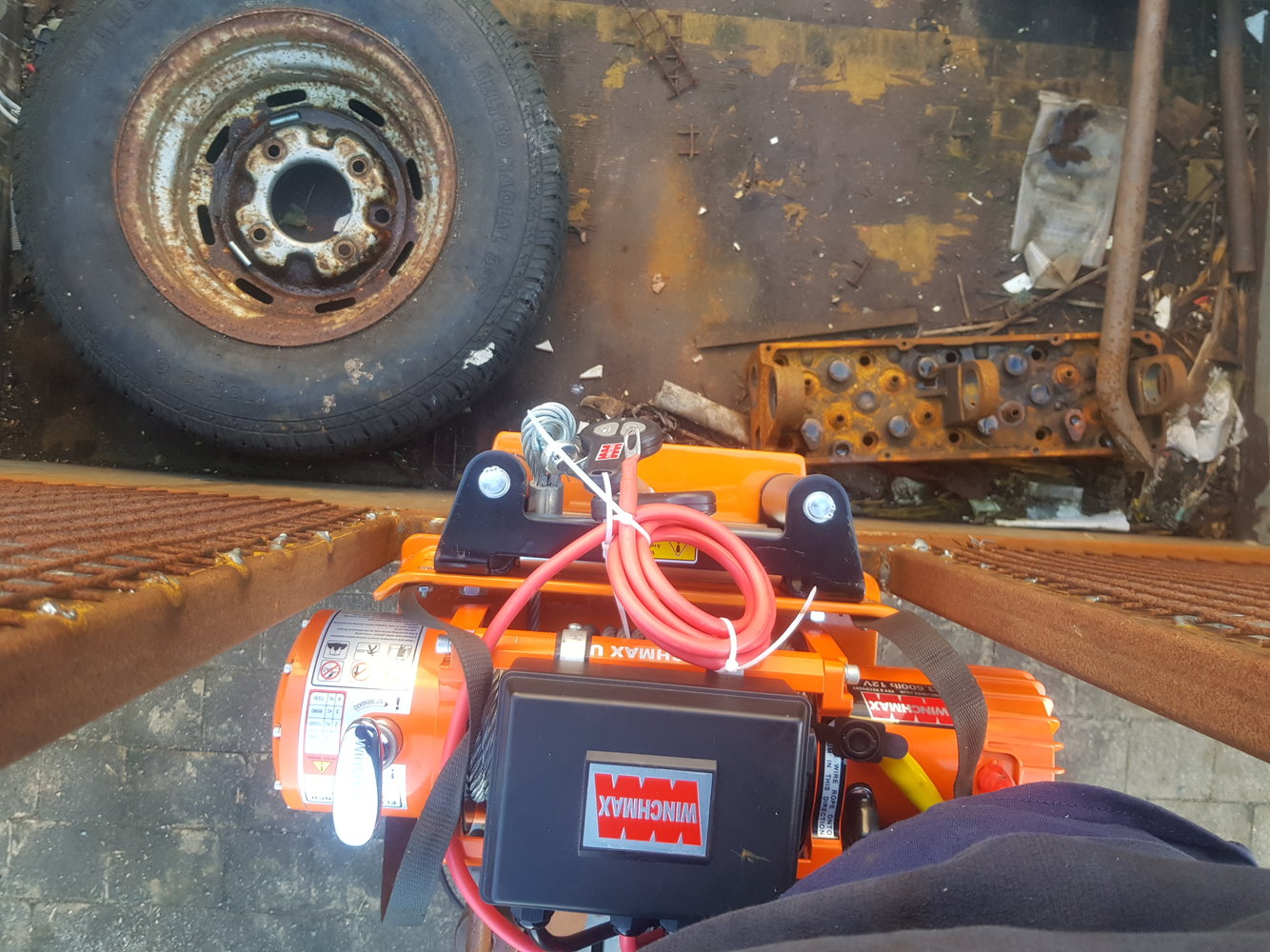

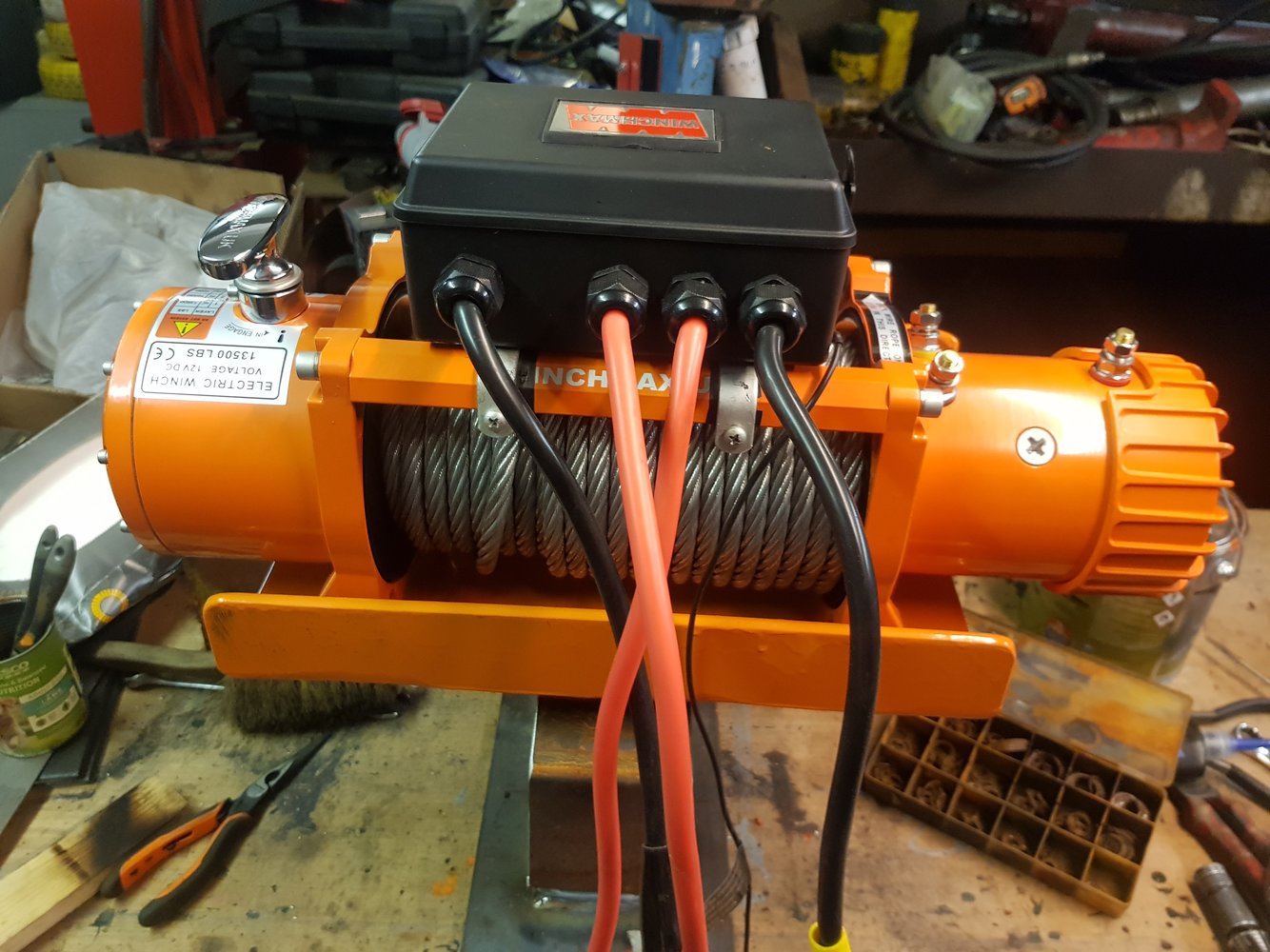

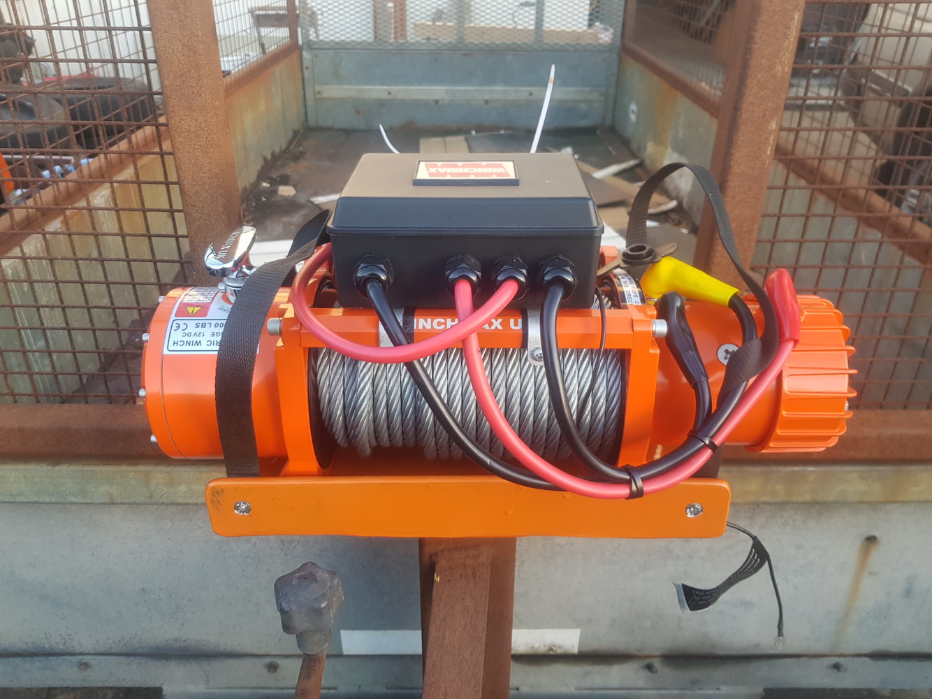

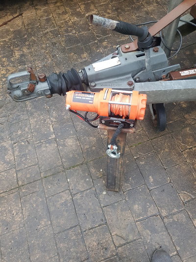

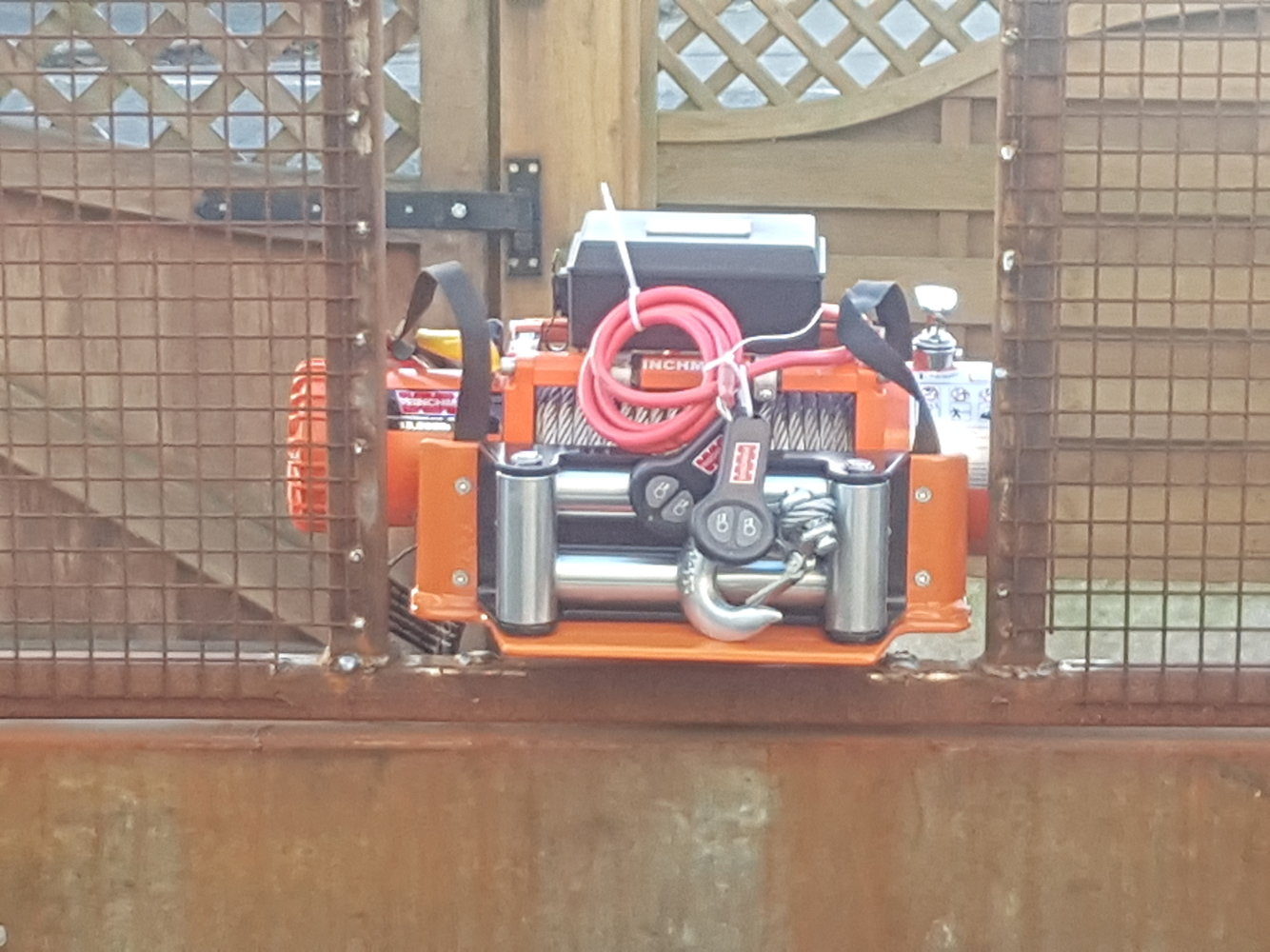

Here's my winch mounting solution.

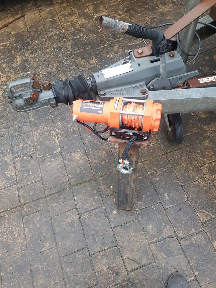

The first few pictures are of my lash up of a winch mounting post a quick afternoons work, built about 9 years ago, for the following days use.
The small winch is 3500lbs line pull, I've already stalled and burnt out a 4000 lbs winch about 7 years ago so the winch post has been tested so far..
The tube on the bottom of the 3500lbs winch is a bit of 80 x 80 x 3mm.

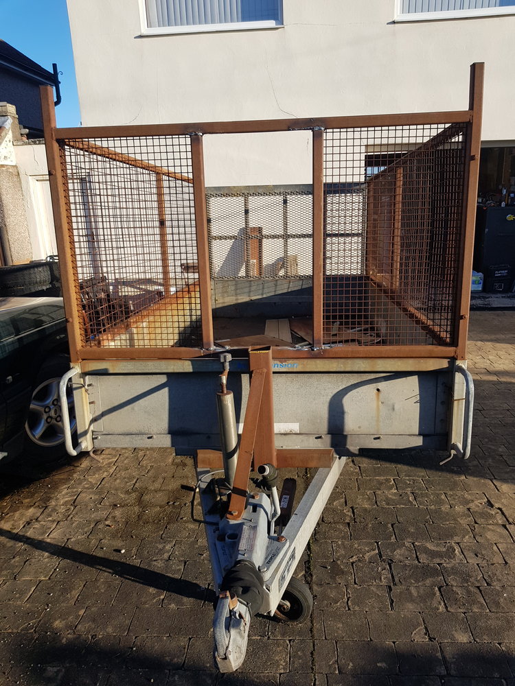

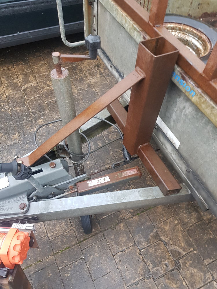

The trailers A frame mount
The bottom cross tube is 60 x 60 x 4mm, upright tube is 90 x 90 x 3mm, diagonal brace to tow hitch is 50 x 6 mm flat bar. Its never been a problem.

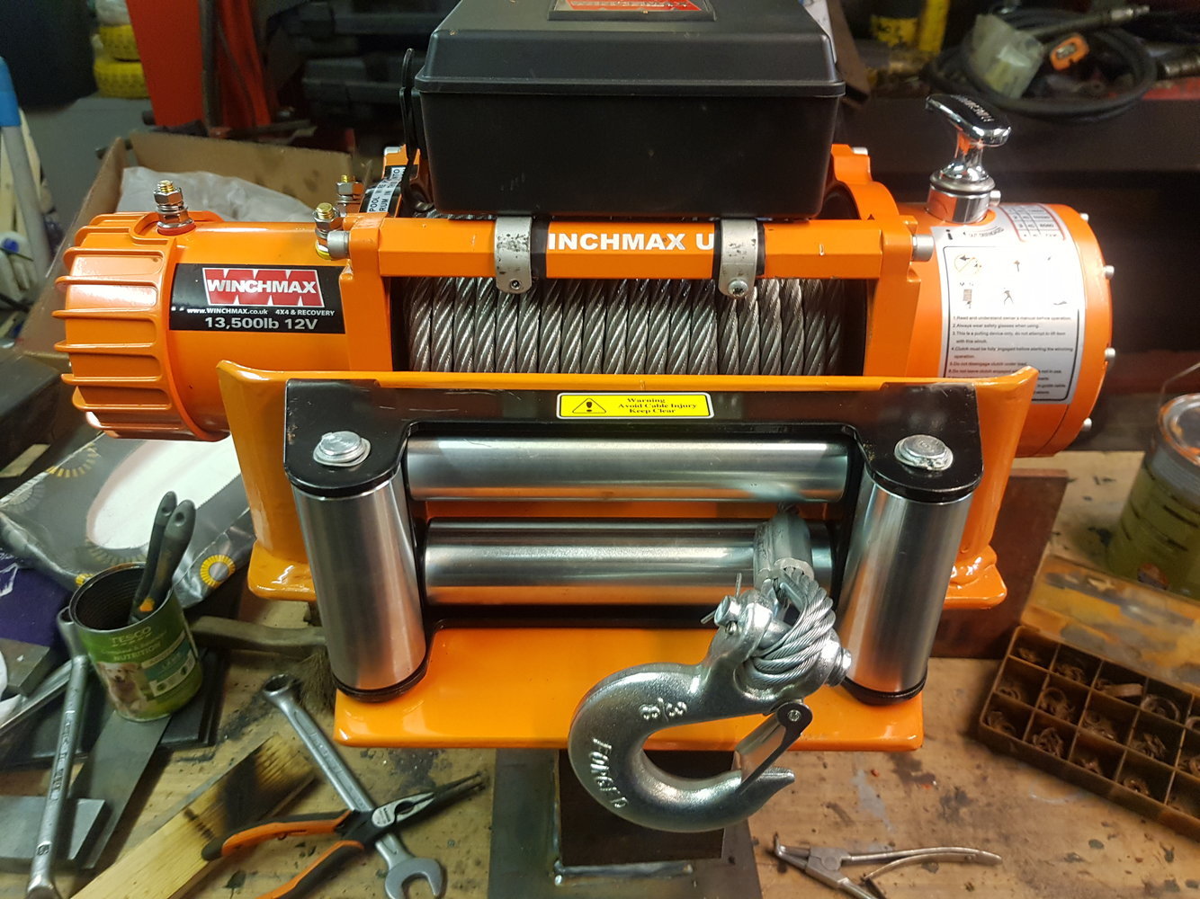

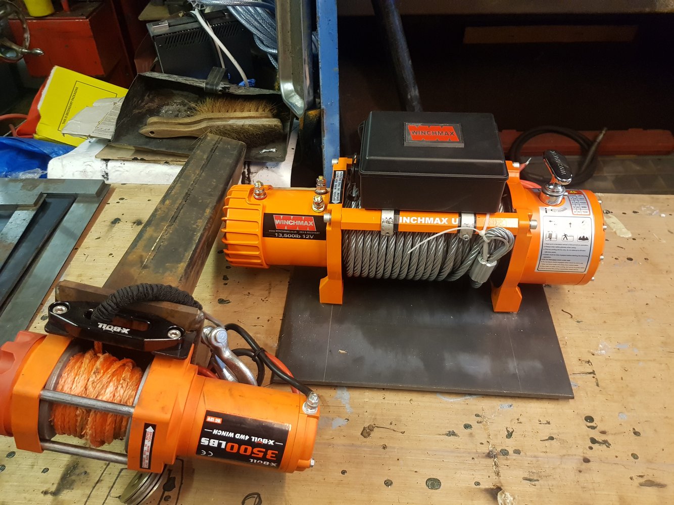

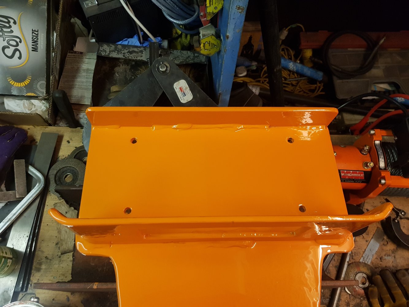

The new winch is 13500lbs so I'm expecting the original post to bend possibly at sometime....

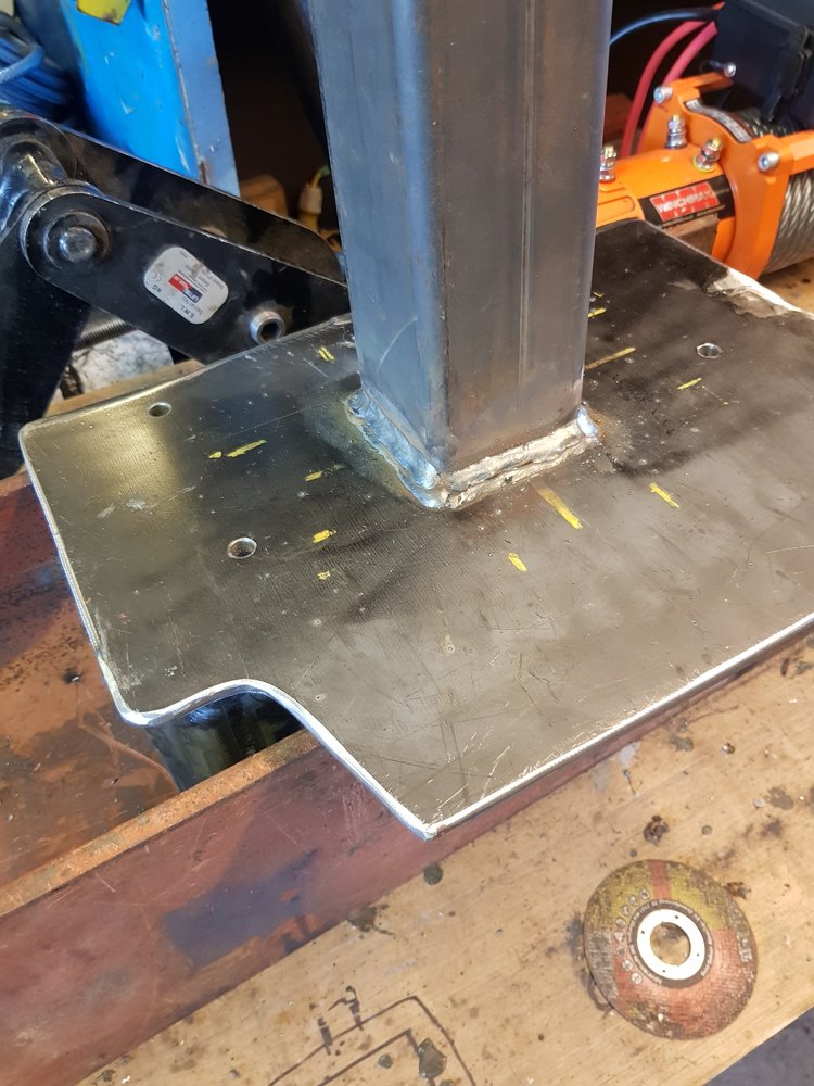

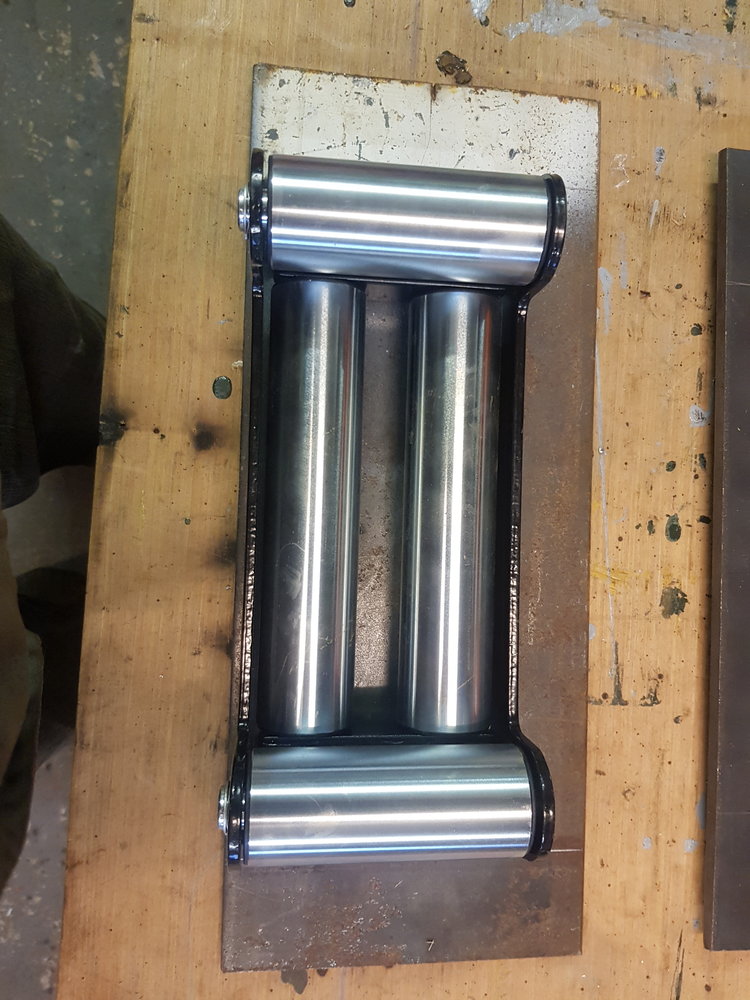

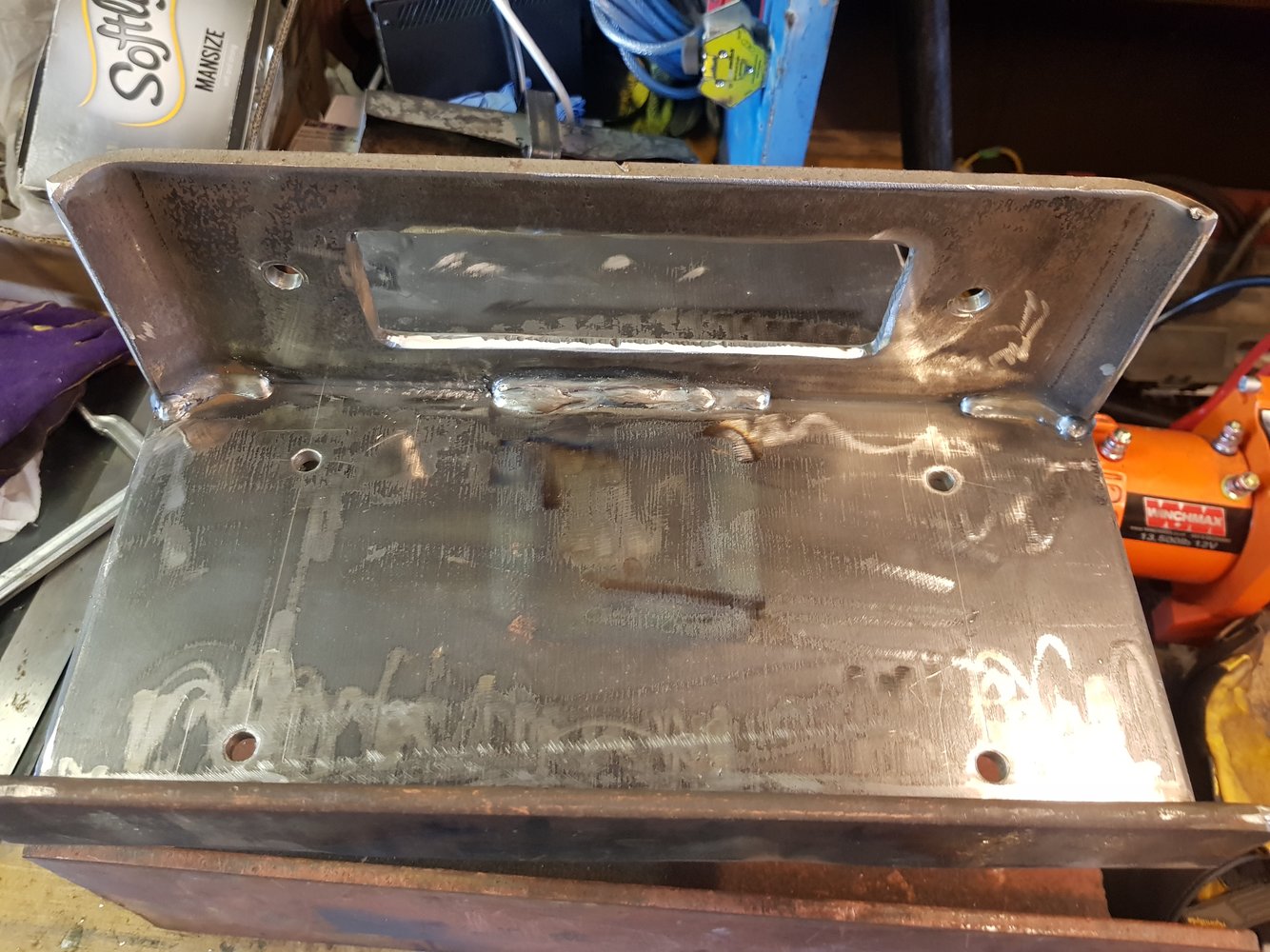

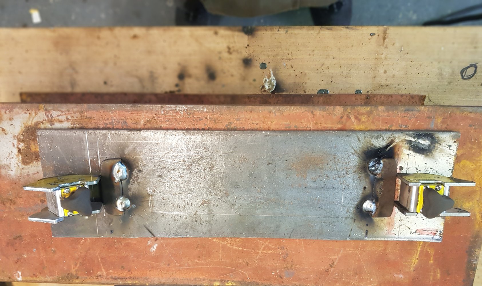

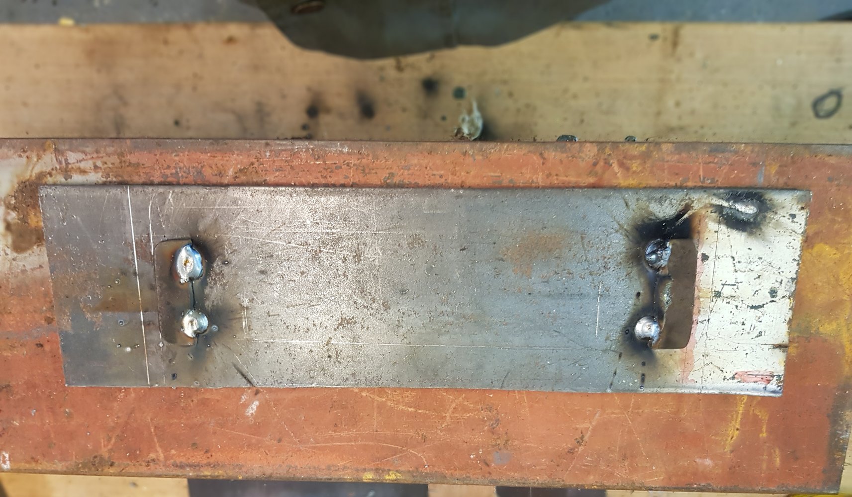

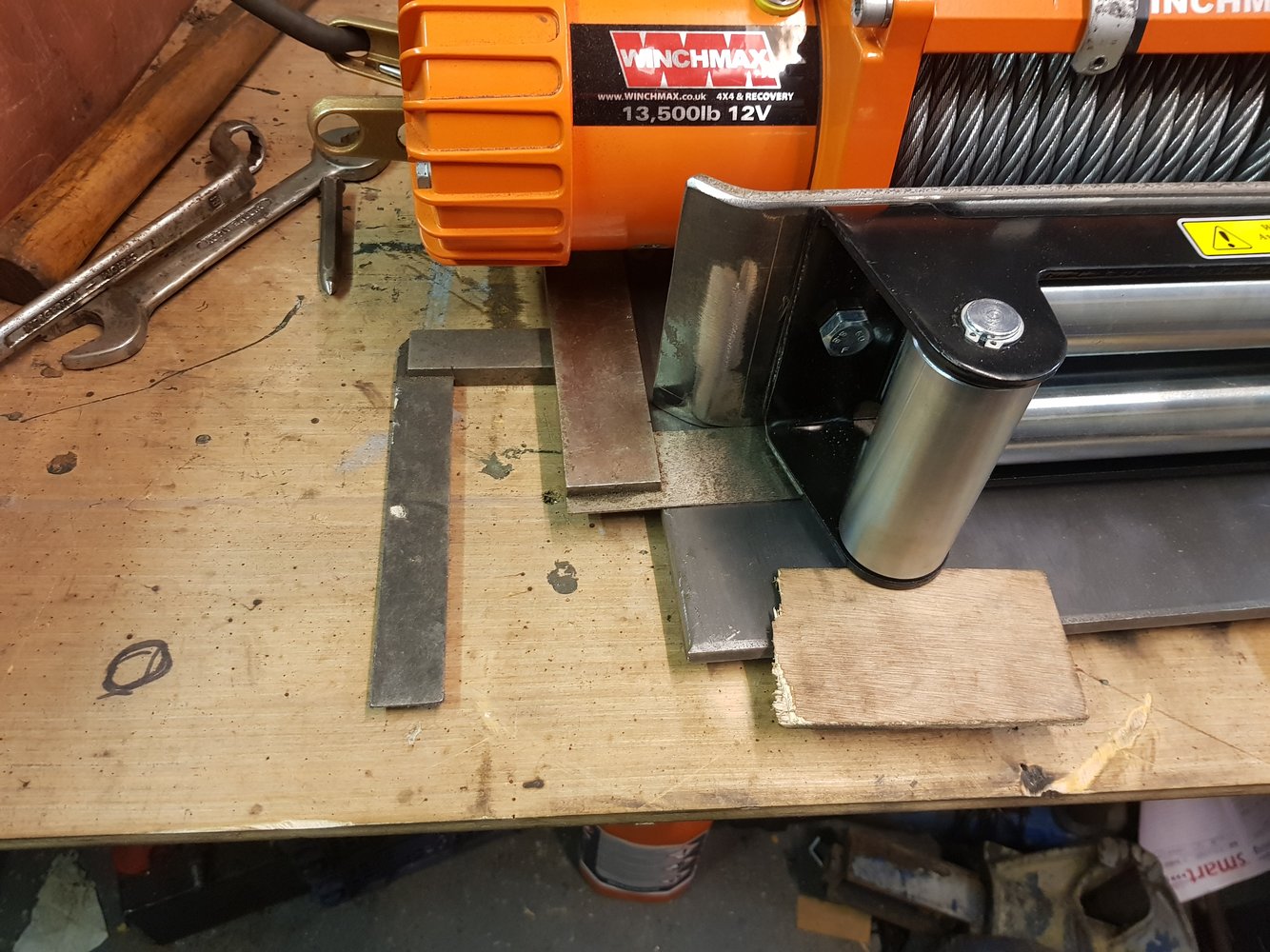

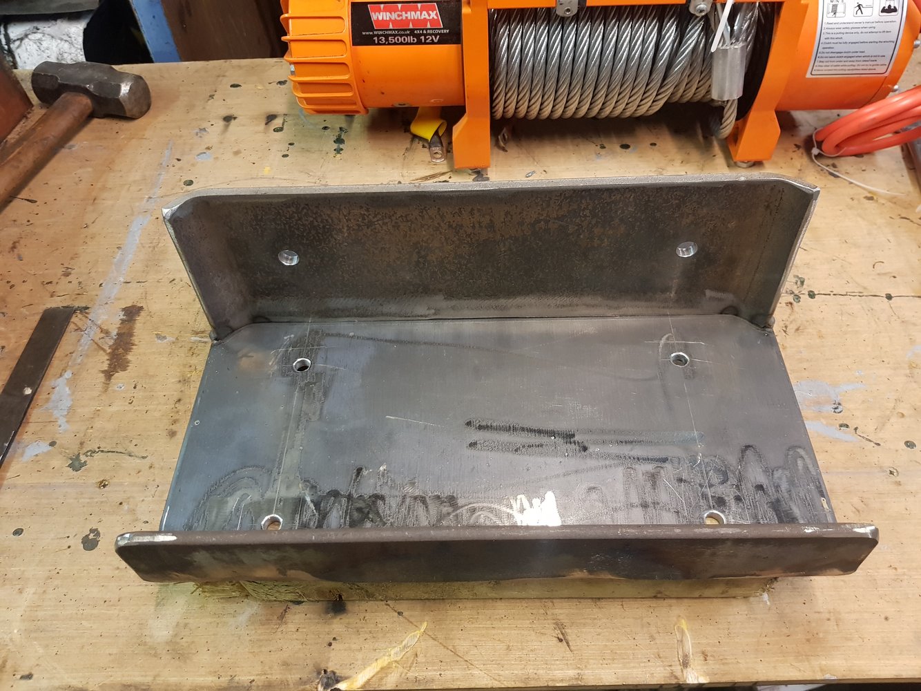

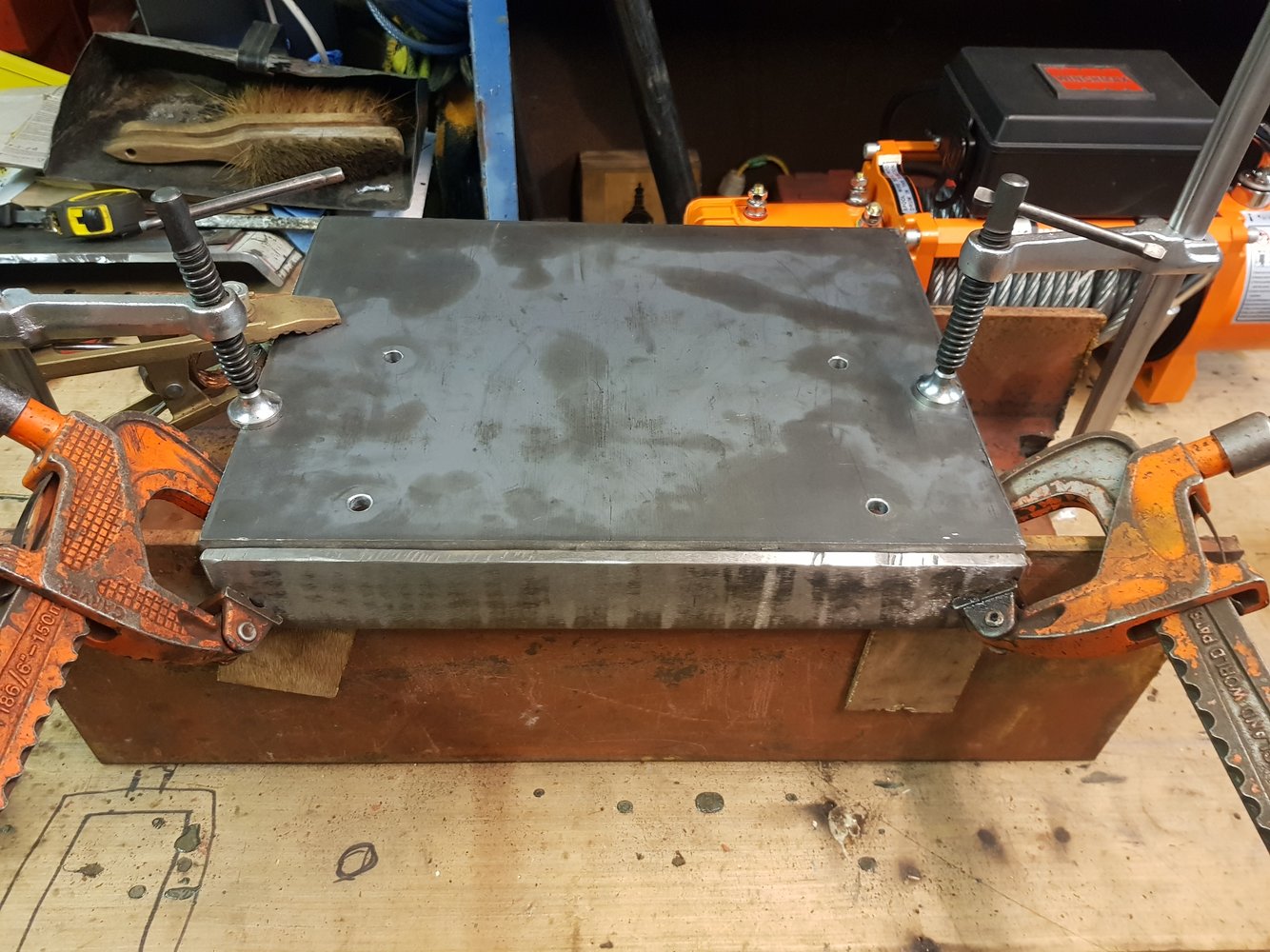

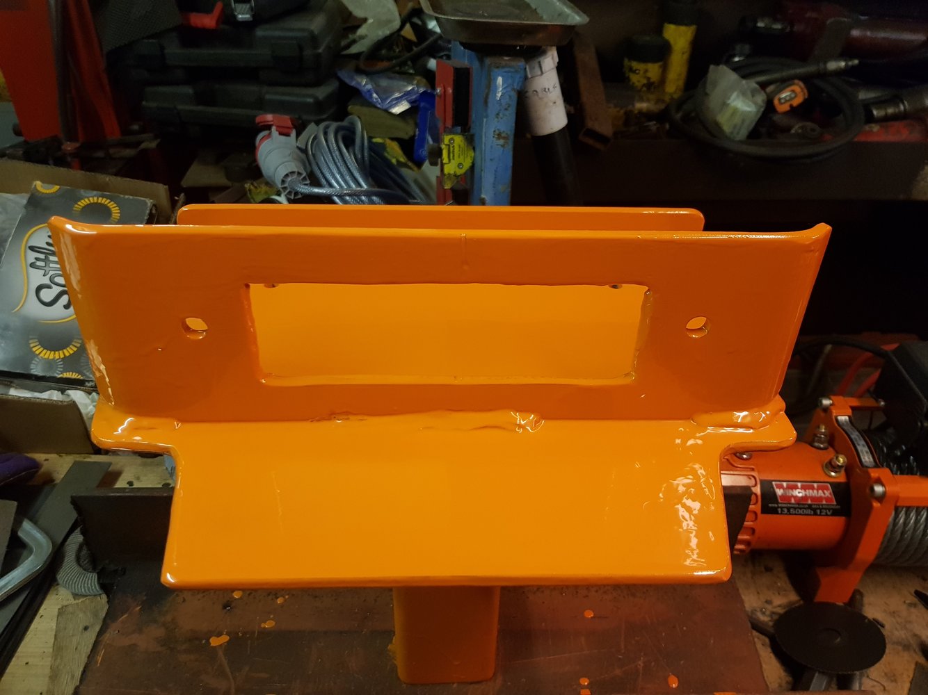

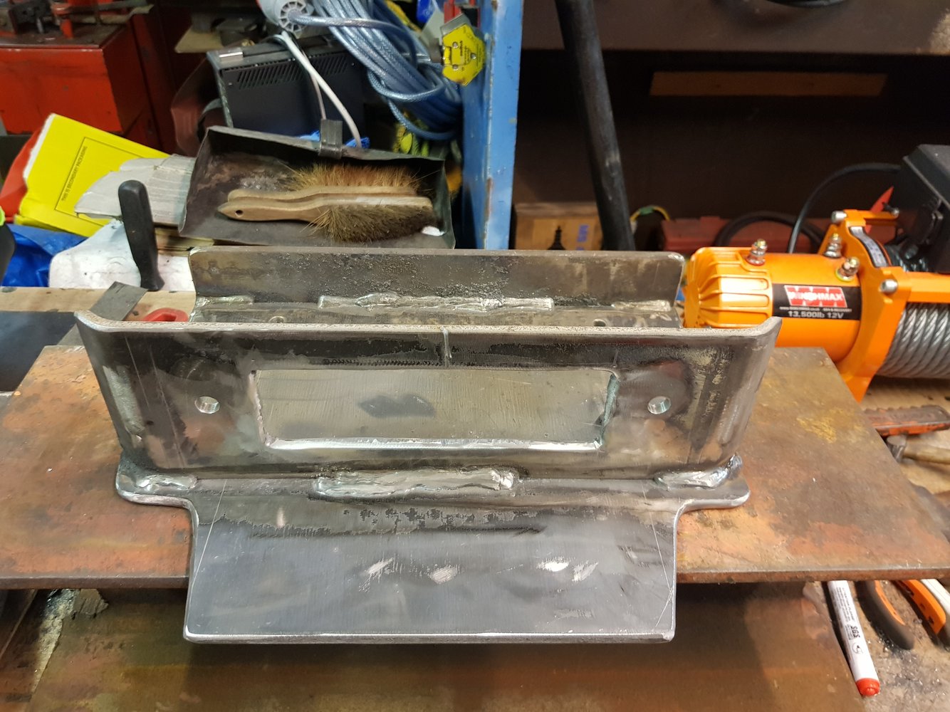

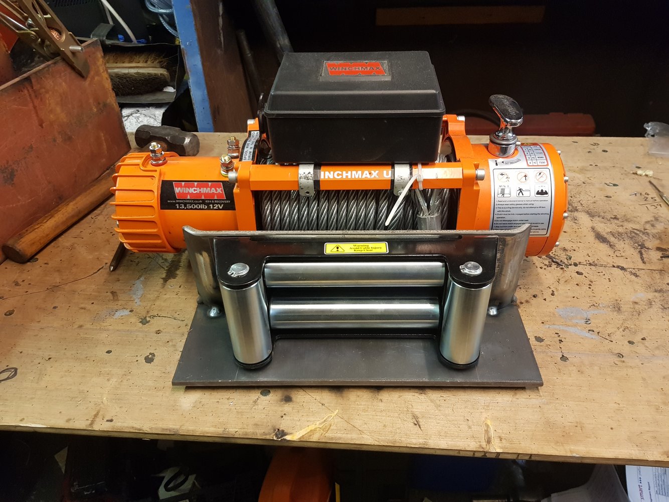

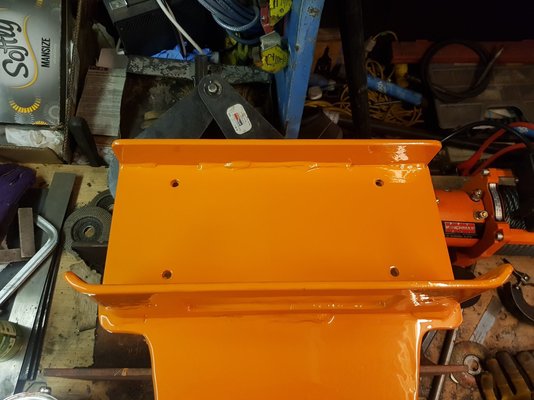

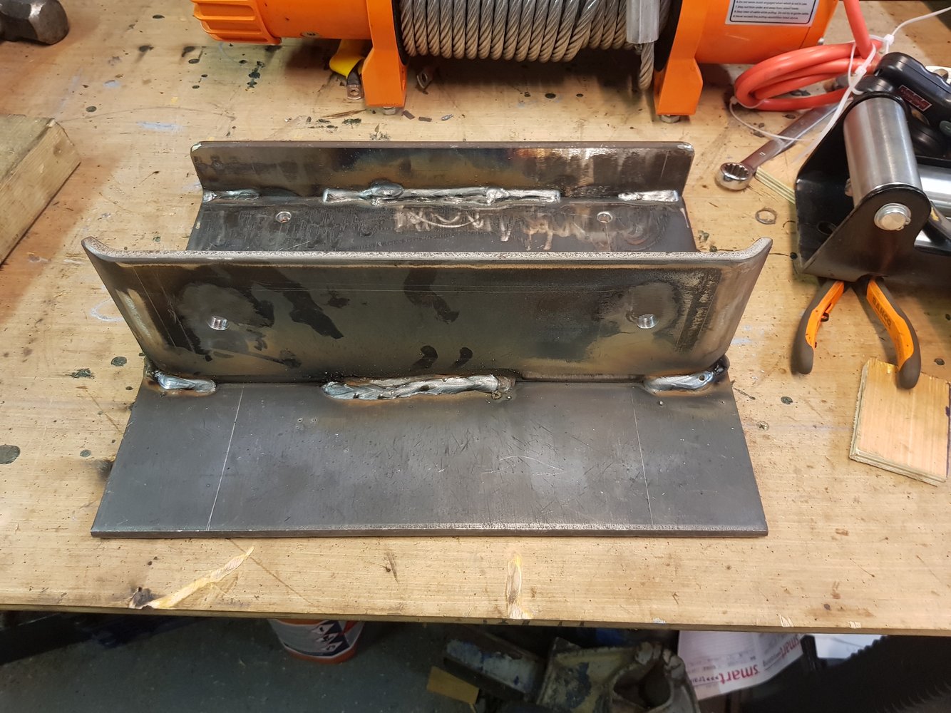

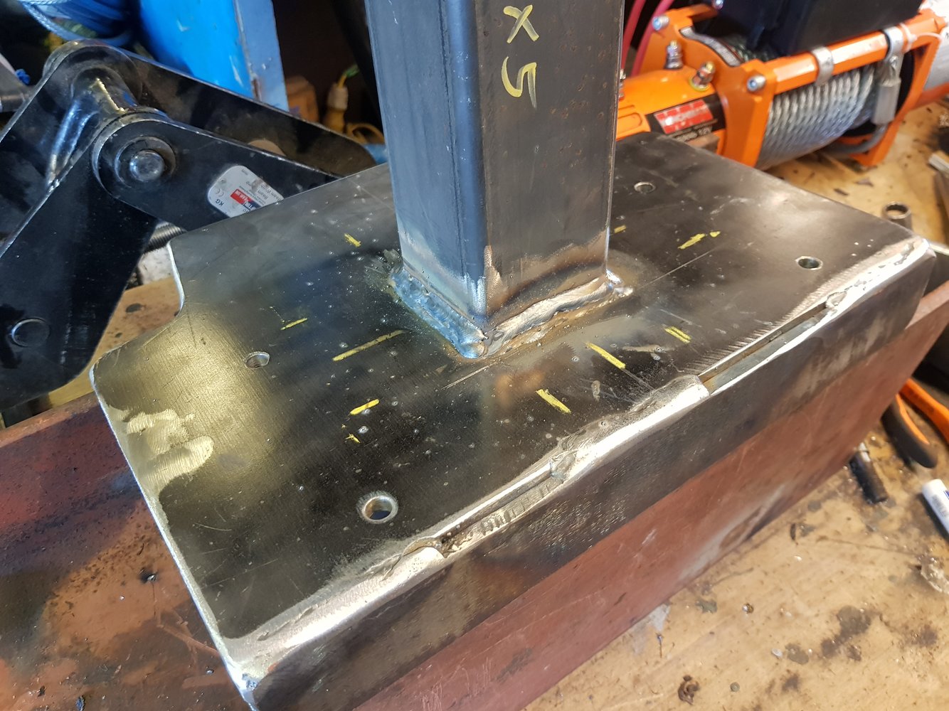

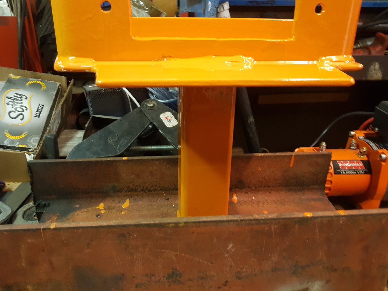

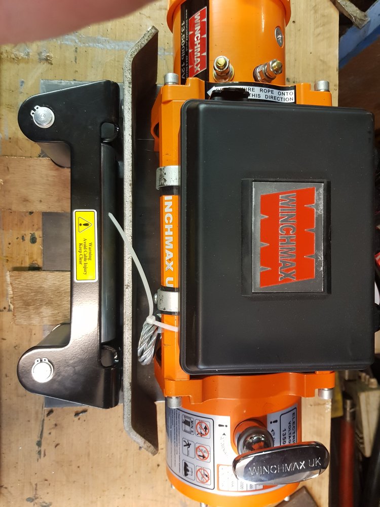

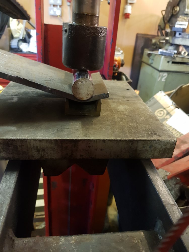

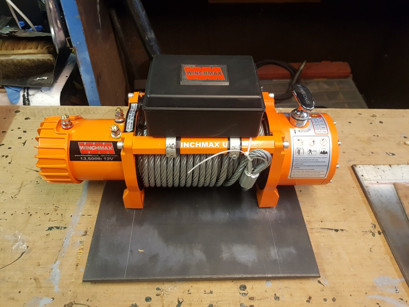

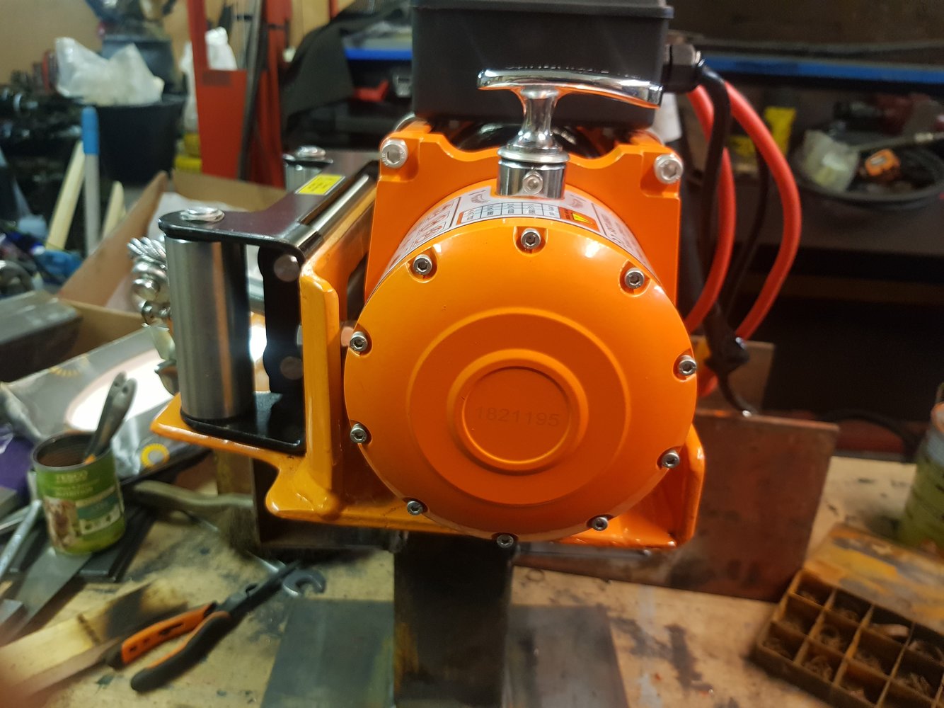

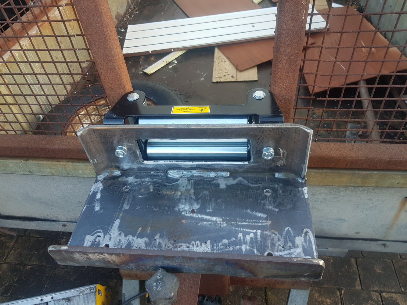

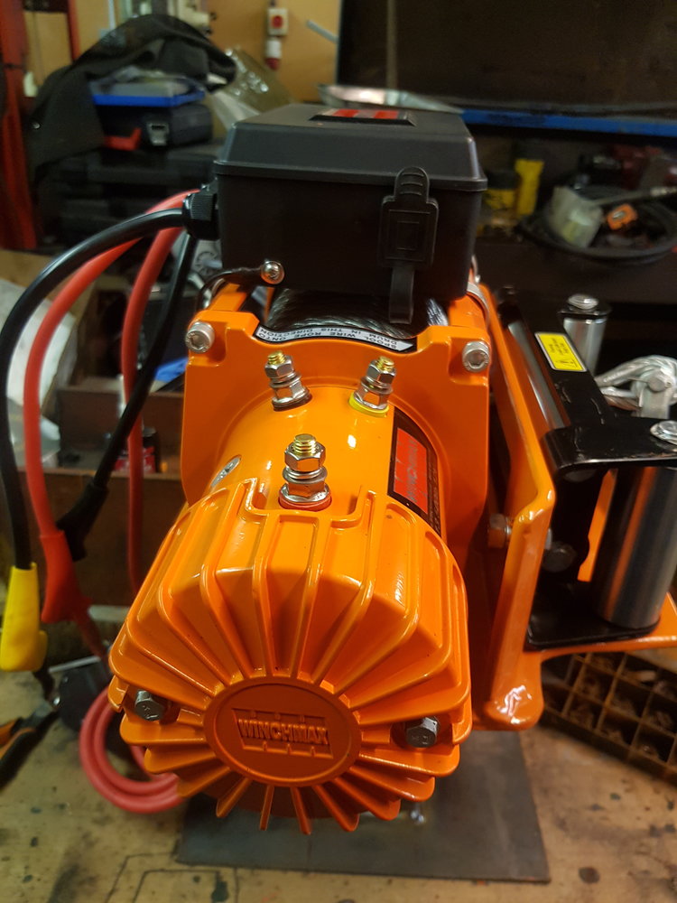

So some 8mm plate drilled for the winch base plate and the fairlead roller.

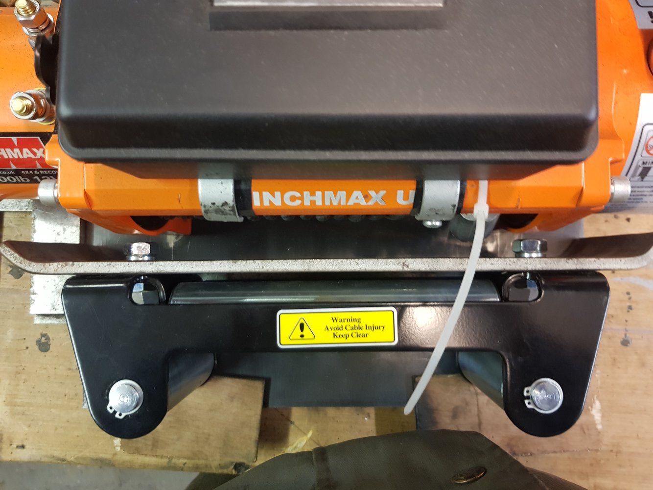

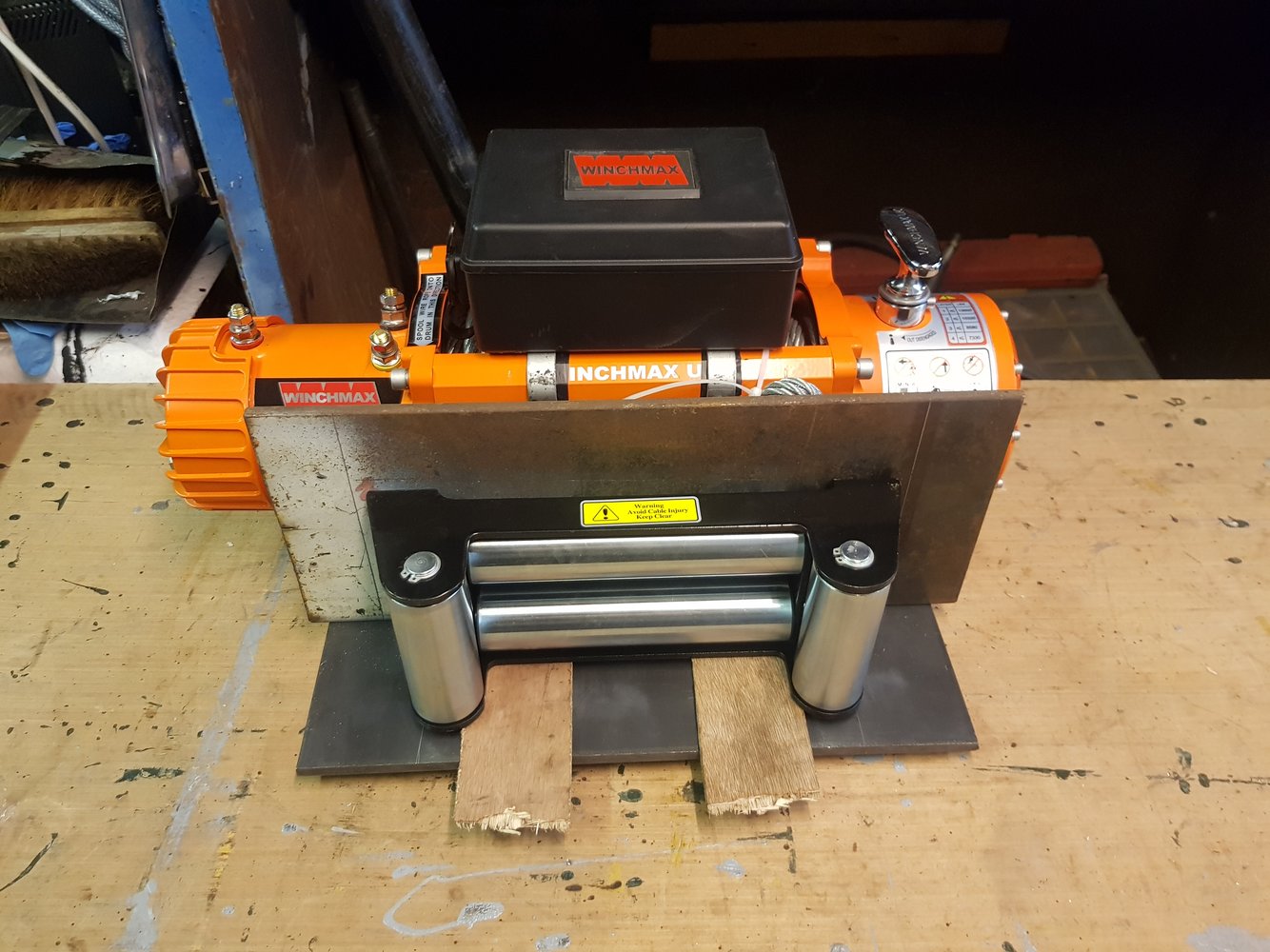

Winch temporarily mounted to position the fairlead support bracket.
