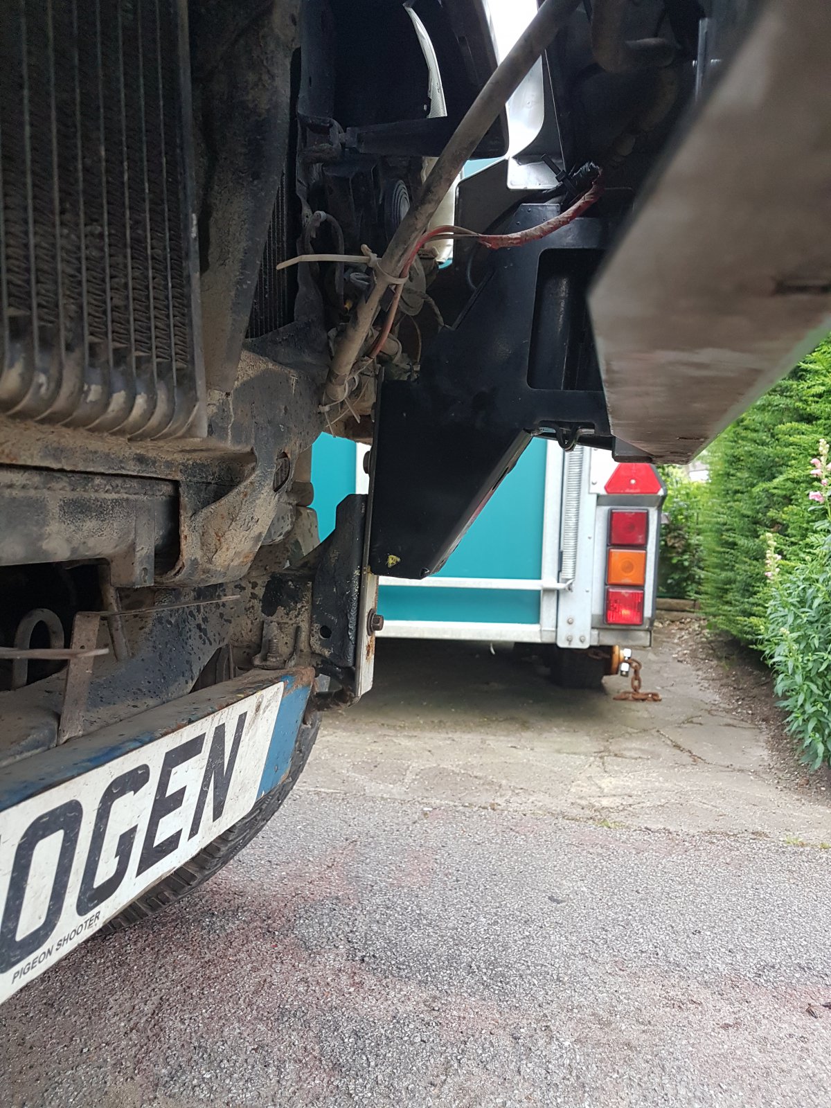

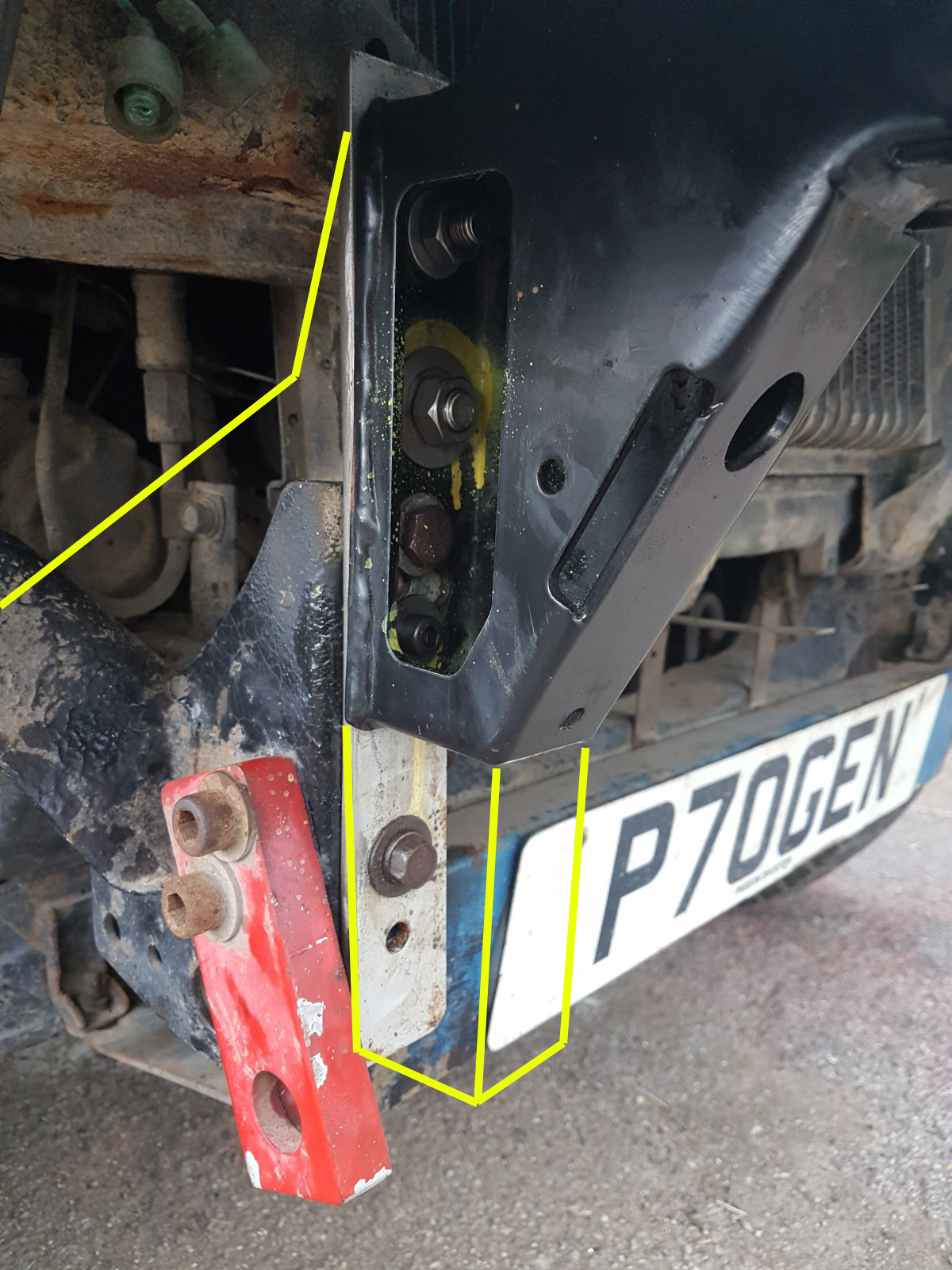

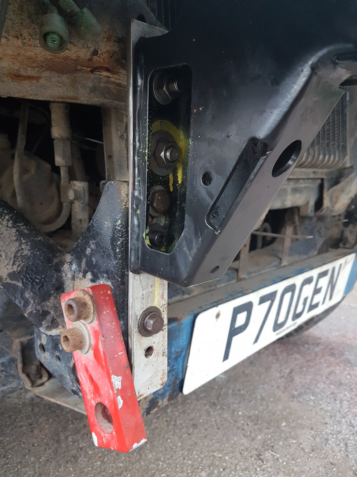

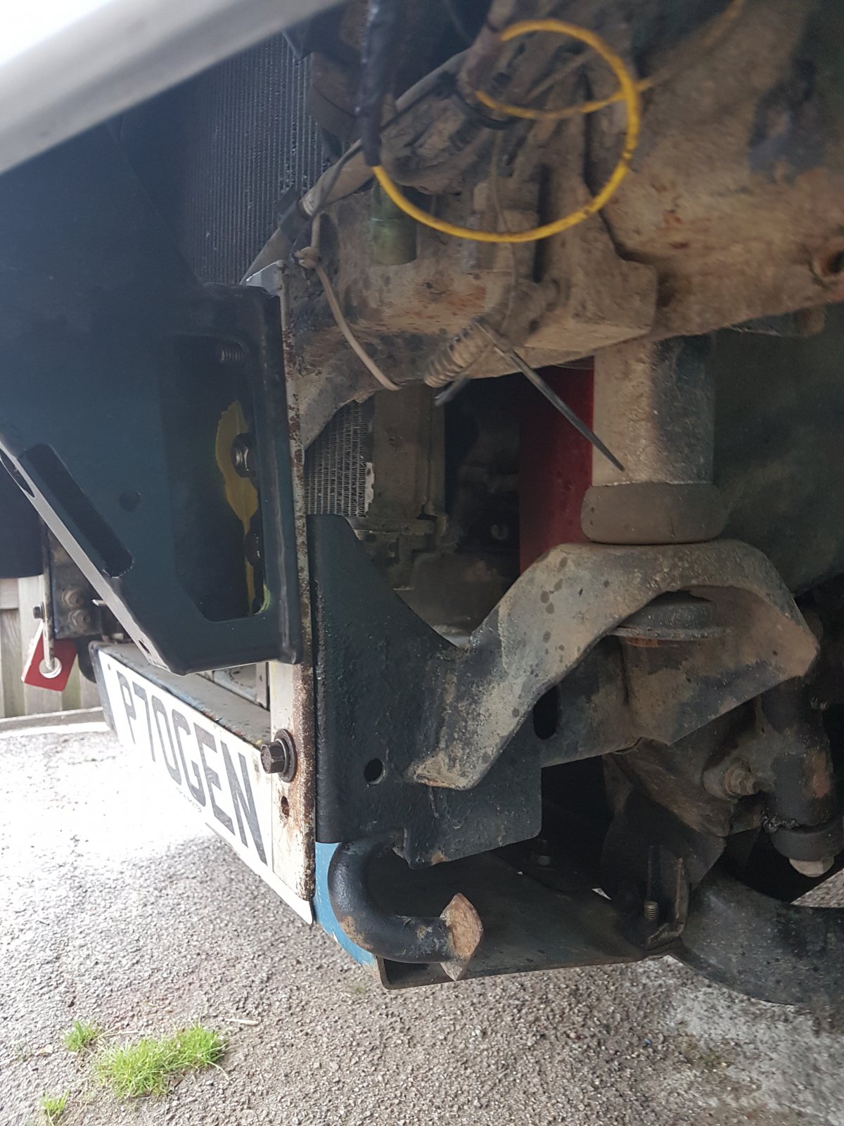

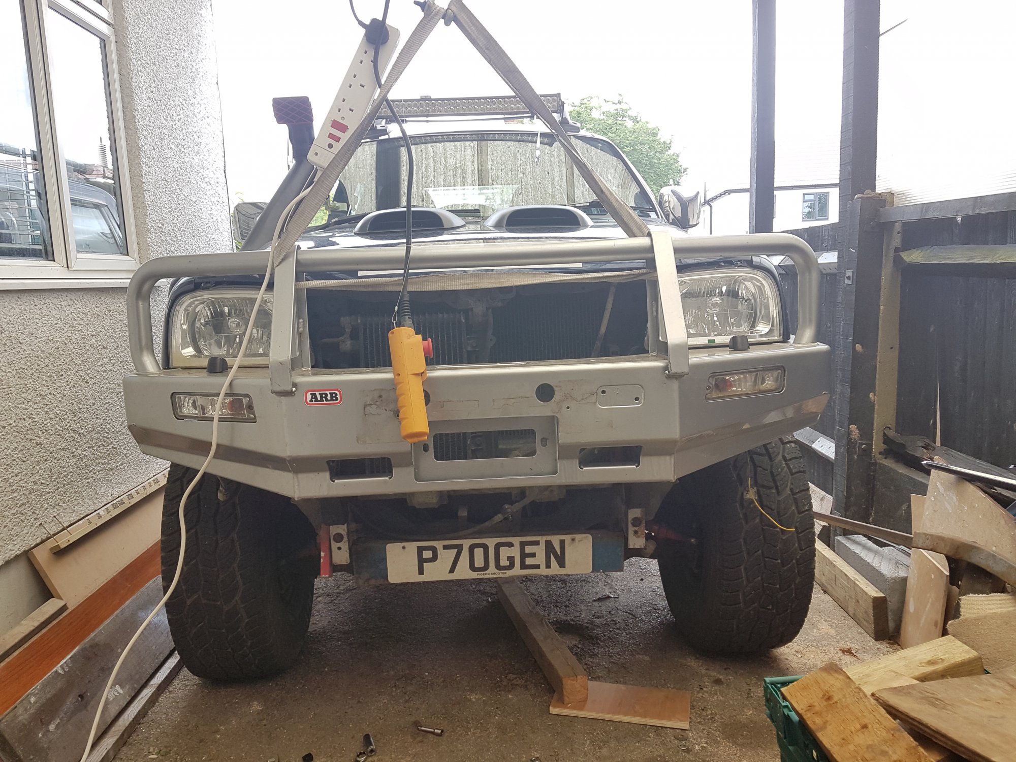

I picked up a nice ARB bumper today but as my truck is lifted the mounts needed work, I have just made a temporary extension out of some plate for now but this needs to be made from something more substantial before I even think about fitting a winch into the bumper.
I was thinking of replacing the plate/bar with angle or channel steel and bolting across the chassis as well as into it.
