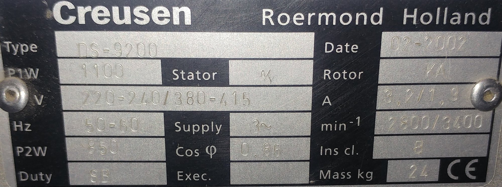

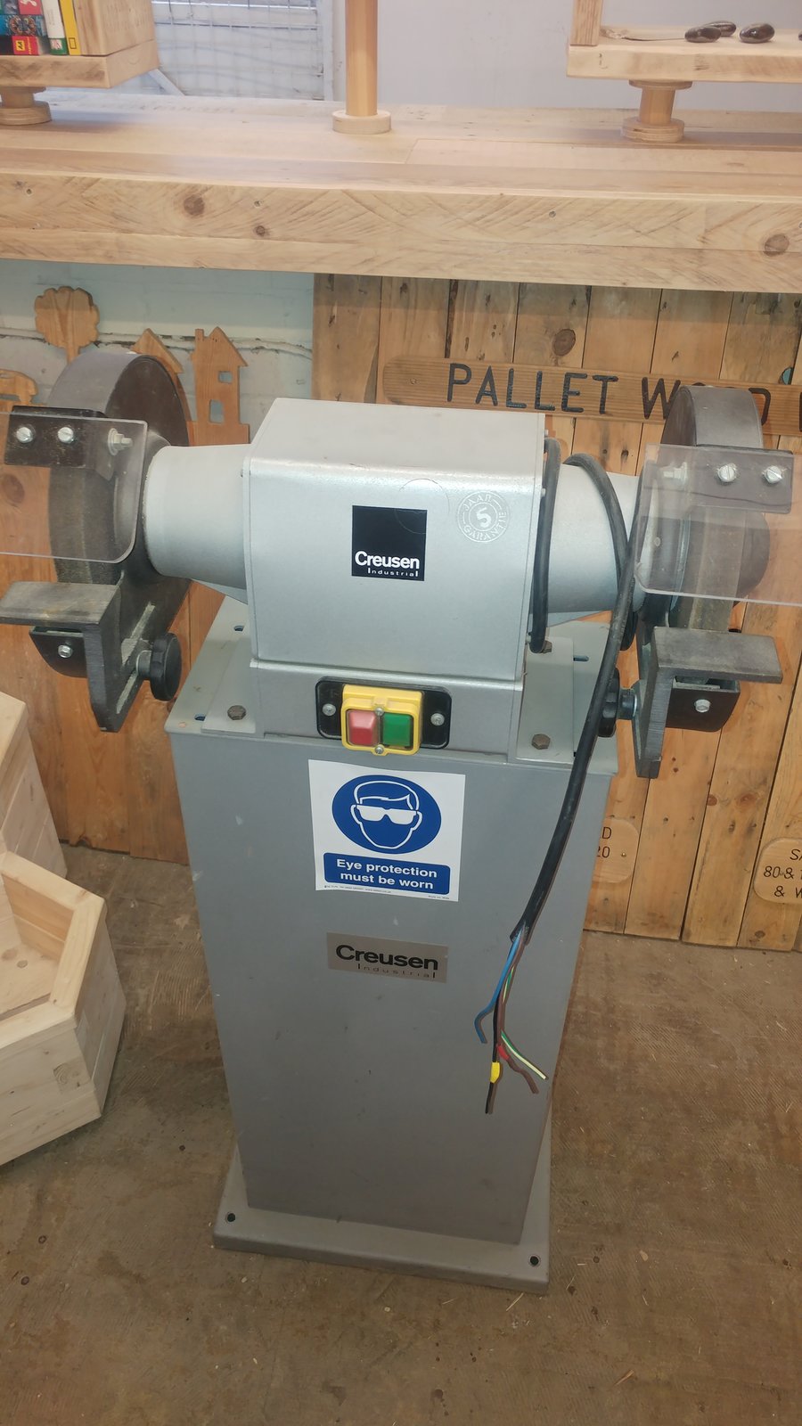

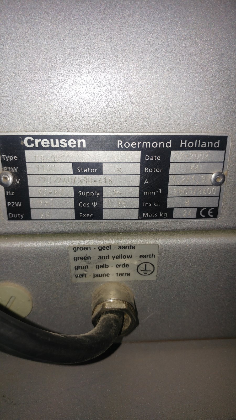

The plate to me reads as 3-phase only, but 240V in Delta and 400 in Star mode.
I've heard of these hacks using capacitors, but you loose a lot of power that way I understand. Not sure if it's all that healthy for a 3ph motor either. That's why I suggested a VFD, can be had very cheaply from china nowadays.
