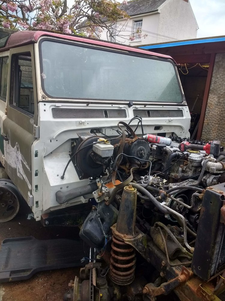

I drained the tank from the sump plug (i think the tank is one of the newest parts of the truck - every other part of the 110 is dented, but i could see no damage to the tank at all, so it must be new (there's been plenty of other bits bent underneath the vehicle, so there's no chance its the original tank at all).
I dont have a good plan to flush it, beyond what ive done - drained it, then poured jugs of fuel in, and let them drain again, and carried on doing that (they keep coming out again brown, so im certainly flushing something).
At the end of the day, i put the plug back in and a couple of jugs of fuel in to try and soak it a bit, and then ill drain again, and see what its like.
The front hubs are in bits at the moment, and all the wings etc off, but its not so very far off an MOT now for the first time in years. So not a bad days work.
