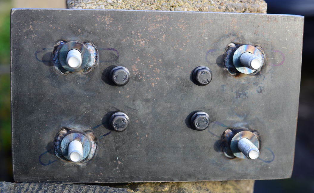

And this is what it looks like. First off, the plate with stand-offs welded, mounted to the engine stand with mounting bolts where they will be used:

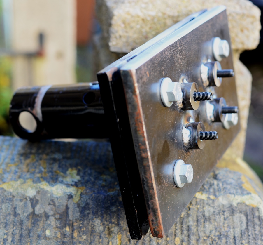

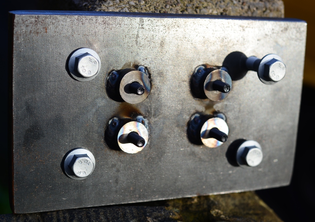

Back view of same:
Adaptor plate off the engine stand, side that bolts to the stand:
And the side that bolts to the block:
Plate is 250mm x 150mm x 12mm (same dimensions as engine stand mounting plate)
