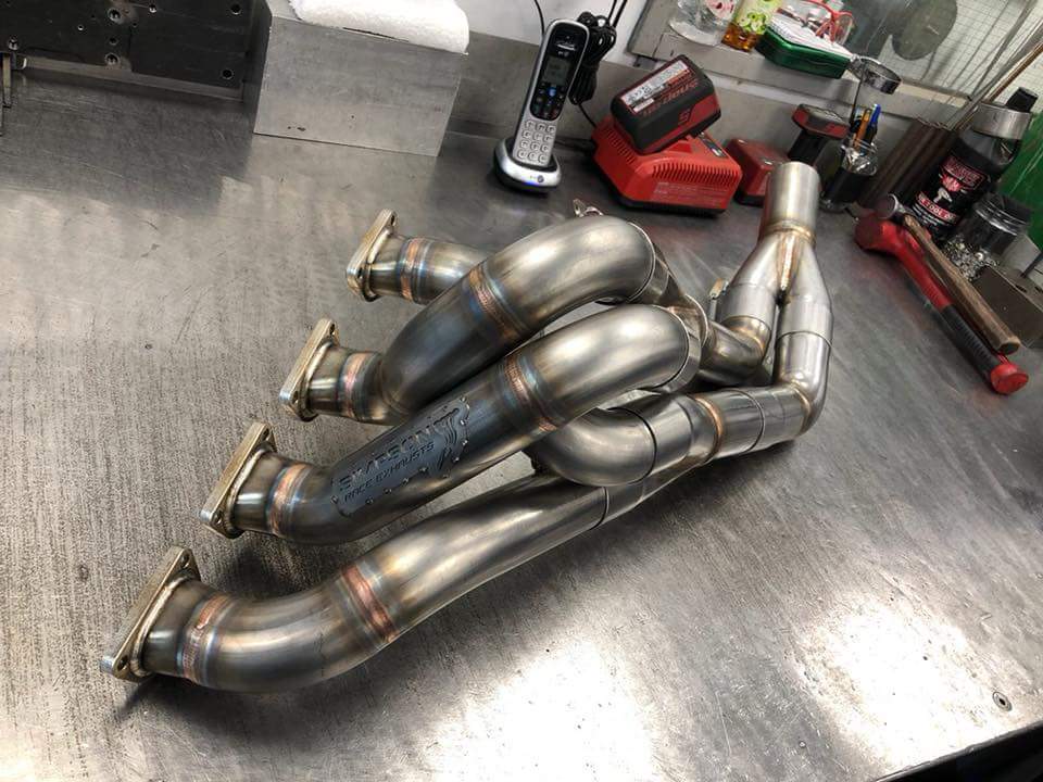

seen this pic of a beautiful Simpson manifold. Noticed it hasn’t very wide weld beads, how is this achieved? As all the thin wall stuff I’ve done is very small?

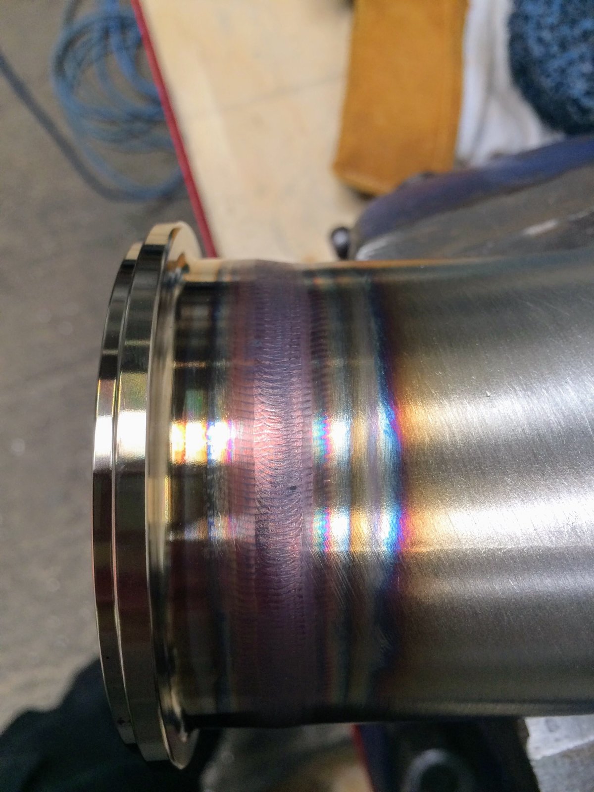

Almost certainly looks like it’s walked.Walked the cup I think?
100%, you can see the zig zag on the cap!Almost certainly looks like it’s walked.
