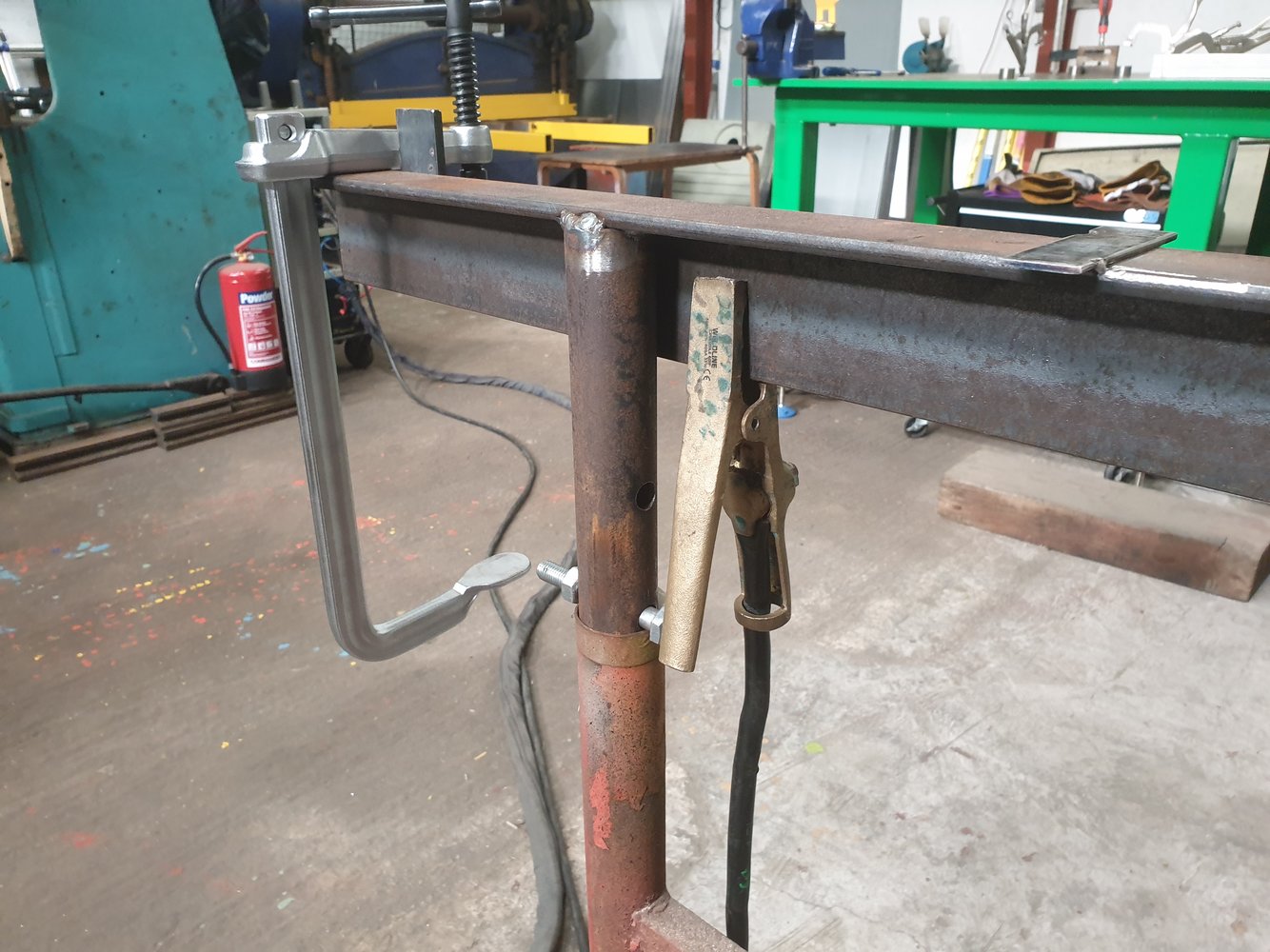

or bolt the cable straight to table ,end of
or do what i have welded a bolt to a pair of molegrips and fastened a crimp lug on it and the cable no loss of current and overheating thereor bolt the cable straight to table ,end of
