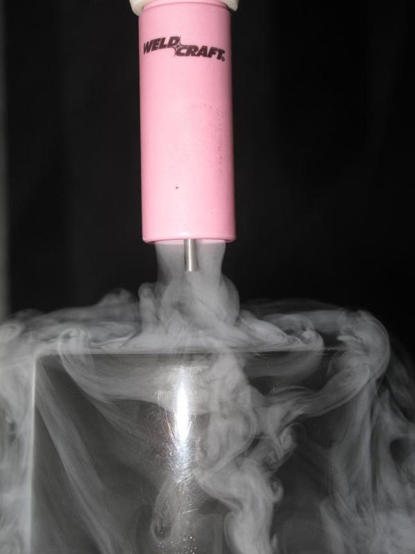

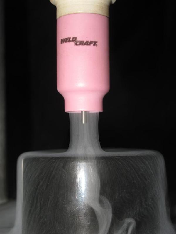

I found I needed slightly more gas flow with the lens than the standard ceramic set up.

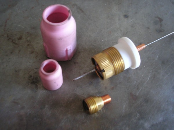

they all have there uses and i use mine all the time.
I have a few different size's and find using the smaller ones are better when working round tube work.
pics of the ones i have.
If you had to choose two sizes to get you started which two would be the most useful. Hobby use and DIY not production.
1.6 & 2.4mm, they are very cheap to buy
