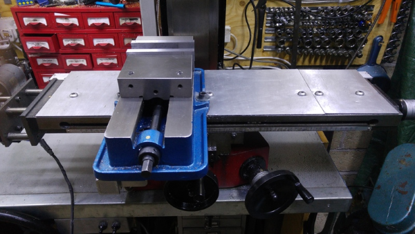

- I hate cleaning swarf out of t-slots on the milling machine, so I got a few odd bits of thin aluminium sheet out of the drawer, trimmed them down, drilled some holes and bolted them to the table. Now the swarf is much easier to deal with.

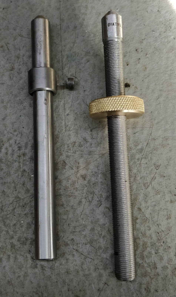

- I always found it very hard to get a consistent flat finish when dressing the grinding wheel with my diamond stone. I'd tried a little sleeve for adjustment (pressed up against the rest), but it was hard to move it in small enough increments. I chucked a diamond dresser in the lathe, turned the 1/2" OD down to 12 mm and put a thread on it. I went for 1 mm pitch, but it would have been fine with 1.75 mm and then I could have just used a standard M12 nut. Took less than half an hour to do and makes dressing the grinding wheel SO much easier.
