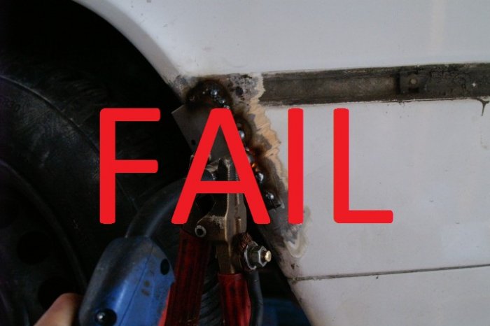

Hi!
I do a lot of work on cars, and sometimes it's difficult to get a good earth connection. I usually weld a tab next to the area I'm welding to attach the earth clamp. But quite often I find some smal gaps between tacks after grinding and have allready ground away the tab... One hand for the welder, one for the shield - who's presing the earth on the panel!? So I tried this and it worked very well
Oh, and please ignore the actuall welds, the welder at work has some serious problems with the wire feed...
Also I'm wearing see-through gloves, I promise!
Cheers!
