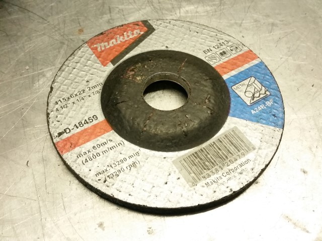

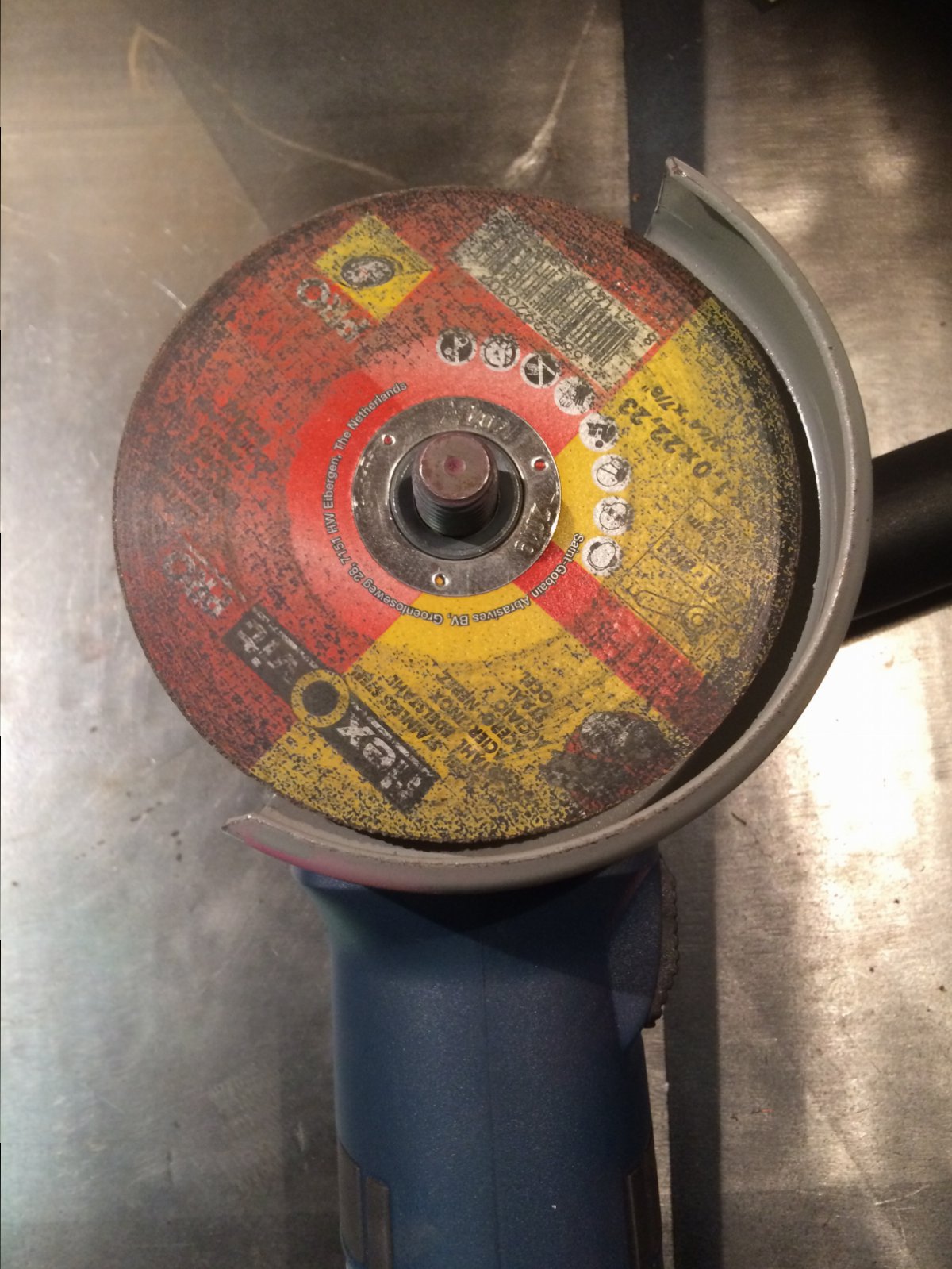

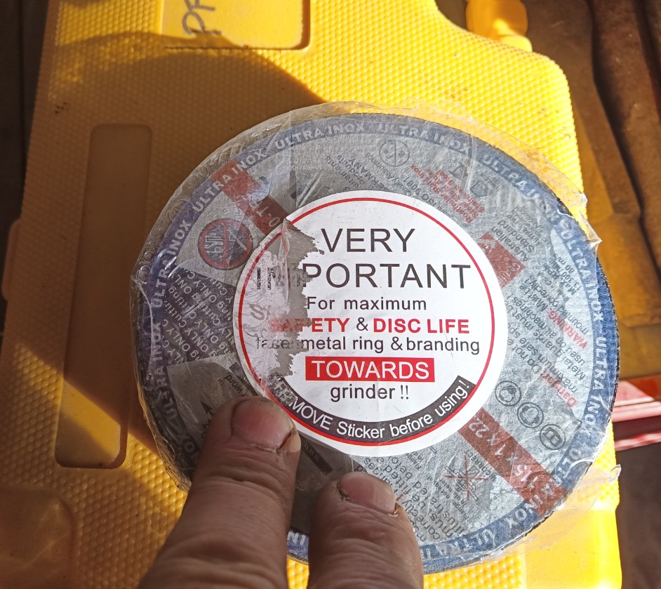

I've stolen the picture to show the numptysJust wakening up this ancient post as the last day I saw this on a pack of discs. As said earlier it is the way I always fit them as I think it is better to have the nut against the rough disc rather than the steel washer as it will tighten better in use but at the same time make releasing easier.
