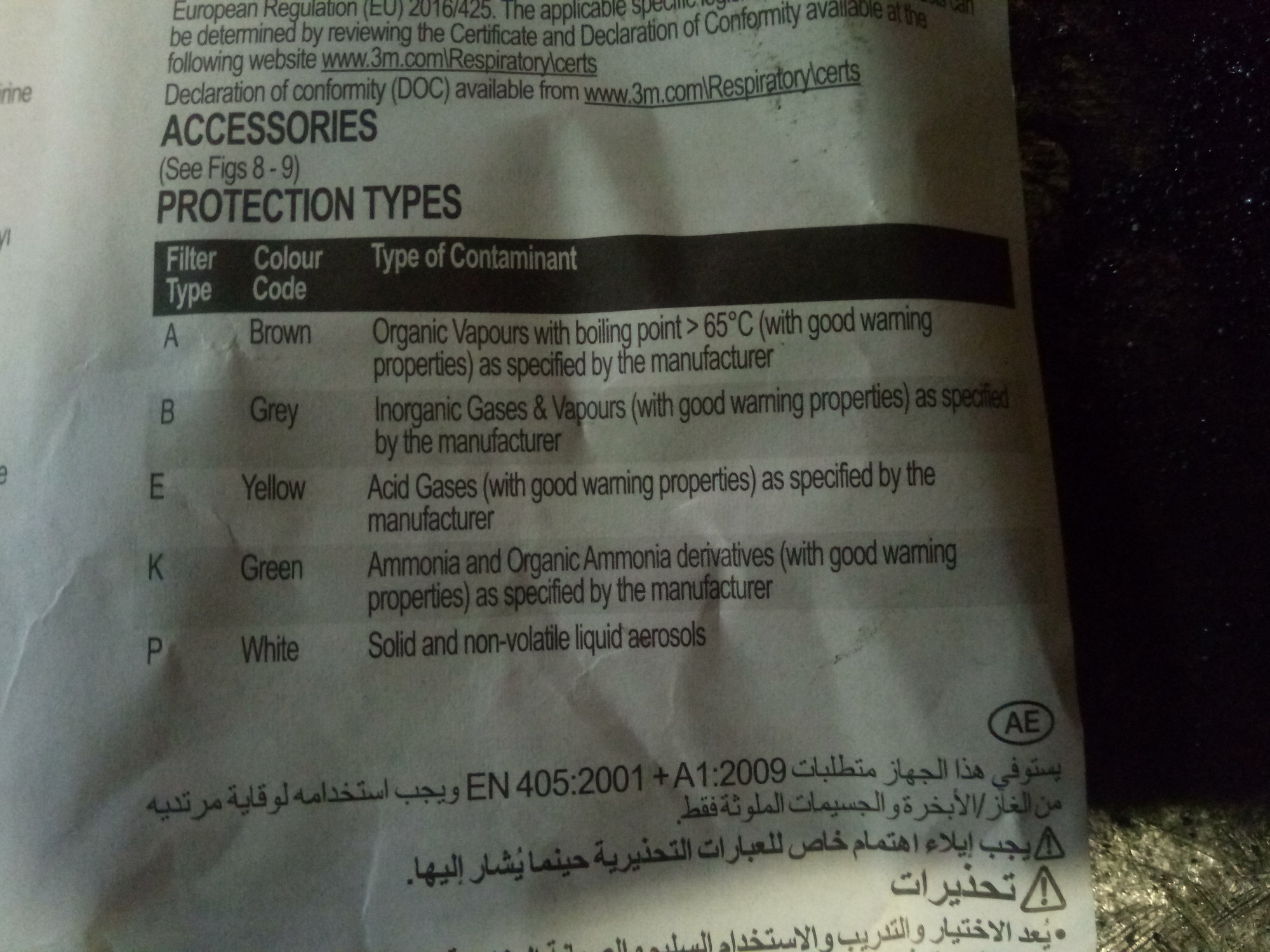

Lordspectre If it aint broke, tinker with it anyway Messages 213 Location Ireland Apr 11, 2019 #1 Well folks. I get the workplace to buy these in for me, just wondering which colour grade should I be using for mig welding only....I use a more basic dust mask for grinding. IMG_20190410_080955.jpg 394.9 KB · Views: 73
