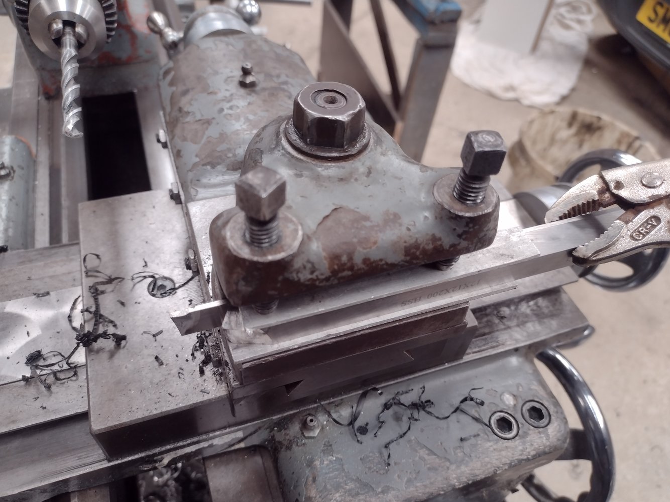

No ? But if it cuts clean to the centre why do I need to raise the tool?Oh, so your lathe is perfectly rigid?
Because during parting the workpiece exerts a large downward pressure on the tool and will force it down slightly. If it goes below centre height it will reach a point in the cut where it could get sucked under and then, depending on the power of your lathe, either the motor will stall (thinking minilathe here) or there will be a loud bang (my M300) and you'll be disappointed.No ? But if it cuts clean to the centre why do I need to raise the tool?
...if it cuts clean to the centre why do I need to raise the tool?
As above.

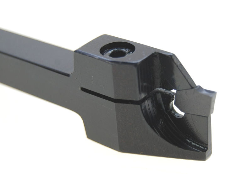

HSS blades like to shatter and go flying when they get overloaded. Theres a very real risk of injury with them! If a carbide lets go it is normally just the tip. The holder and blade are somewhat more flexible, although they can still be damaged.
GTN2 are good for a small lathe, generally they are sharper and slightly less durable than others, which suits a small lathe - lower cutting pressure and less rigidity required.
The wider 3mm inserts take a lot more force and require rigidity, they dont work too well on mine.
How much down force is being applied as the centre point is approached? Very little would be my (well informed) guess.Because during parting the workpiece exerts a large downward pressure on the tool and will force it down slightly. If it goes below centre height it will reach a point in the cut where it could get sucked under and then, depending on the power of your lathe, either the motor will stall (thinking minilathe here) or there will be a loud bang (my M300) and you'll be disappointed.
What happens at the centre isn't the problem. It's part way in, when the diameter is large enough to exert a big enough downward force and the curvature is small enough for the tool to dive downwards. By the time you get close to the centre your troubles are behind you!How much down force is being applied as the centre point is approached? Very little would be my (well informed) guess.
if I'm understanding the logic here, allow for the downforce at the start of the cut to enable it to cut on CL. So by the time the centre nib is reached its cutting above the CL. Or am I missing something? Not trying to argue, I just can't see how you can satisfy both conditions.What happens at the centre isn't the problem. It's part way in, when the diameter is large enough to exert a big enough downward force and the curvature is small enough for the tool to dive downwards. By the time you get close to the centre your troubles are behind you!
That's possibly why it's worked OK for me so far - my precision fitting probably has it cuting EVER so slightly high - perhaps more by luck than skill - but I'll take the win, and ensure it stays that way going forwards.That is why I wrote “Then raise it a tiny amount”.
