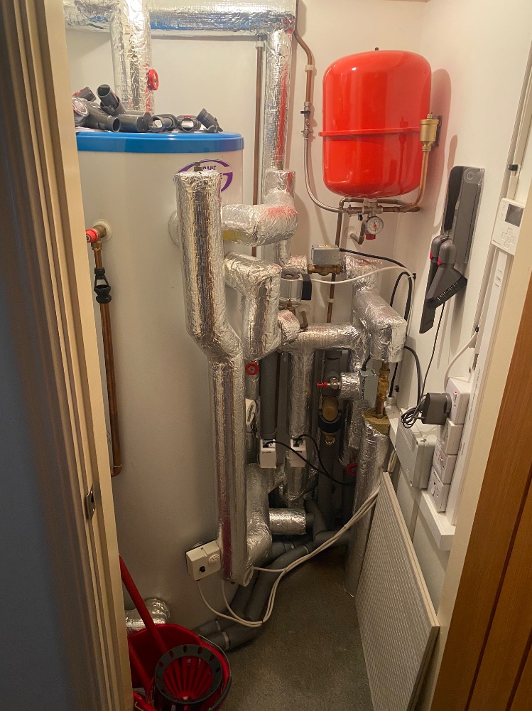

Do I use to turn off the domestic hot water?
The one that installed it ?Which knob Do I use to turn off the domestic hot water?![]()
What Agroshield said, though the red knob at the top of the tank looks like a gate valve, so may not cut off the water flow entirely. Some labels on the insulated pipework would have been useful.Try the red one at the top of the tank. You would normally draw off the hot from the top (as hot rises). The black ones on the flexi near the red tank are the filling loop, so can be eliminated. The red one on the side of the tank is likely the heating coil.
Look up the connection diagram for the tank that is there (cannot read the name in the photo).
The blue stoptap in the street is a last resort...
Edit: there is not much harm you can do by trying each in turn, but clearly do not turn on something that is already off (like the filling loop).
That's an over pressure valve isn't it ?Try the red one at the top of the tank.

"Lagging" and it looks like a professional/industrial job they made of it.Someone got a bit carried away with insulation there.![]()
