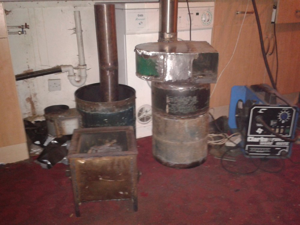

I have been looking for a woodburner design I can use to heat my workshop but I'm not sure what kind of burner to use, what's best a rocket heater or something more traditional ?
Gaz1. They look fantastic. Mine is of the pocket rocket design, nothing at all like these! Mine draws so much air it vibrates and sounds like its going to take off!. I use a heavy steel plate to cover most the feed tube to regulate it.... this causes the wood to burn further up the feed tube. If its unregualted just the end of the wood burns..seems to run better on 2x2 sections, and smaller, like this. When gagged down with the steel plate I can burn proper logs like yours.
