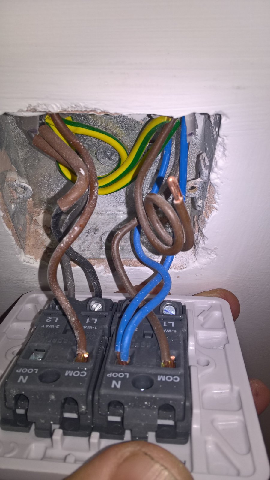

Switch on the right...one of the wires has been left out because there were no lights on the end...there are now...which terminal should it go in?

L1 is the one you want but check the others are still tight before putting the switch back on.

wouldnt be that difficult to work out what should go where
crossed switch wire probably. did it ever work
