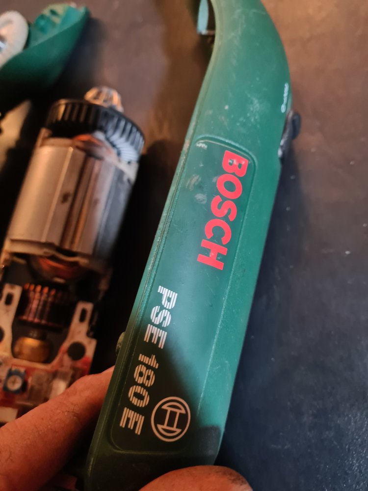

Was using its stoped

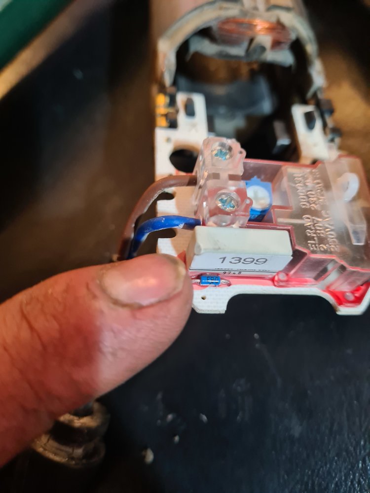

im expecting that but if it just provides 240 to the brushes can i just put solder a cable to the brushes and put in an in line switch its a tool thats rare used and only ever used for a clean up of tile cement floor tile adhisive etcmine knacked up it was a combined speed control and on and off switch its a chuck it in the bin job if it isnt the mains lead bust or carbon brushes worn

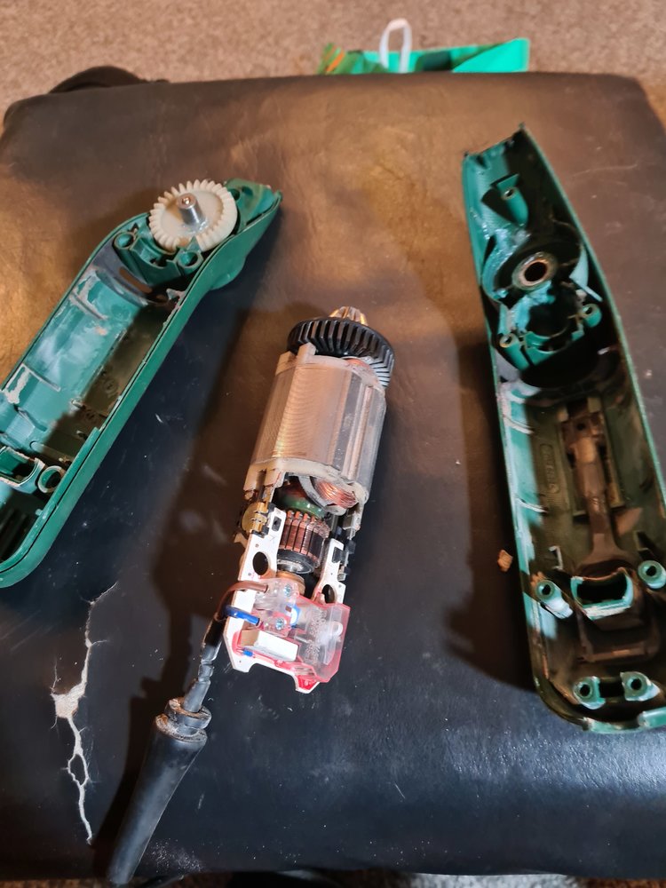

no but to be fair im not even sure i can get near the board plastic cover over the big stuff paint over the other sideAny components on the board which look like they might have let the smoke out?

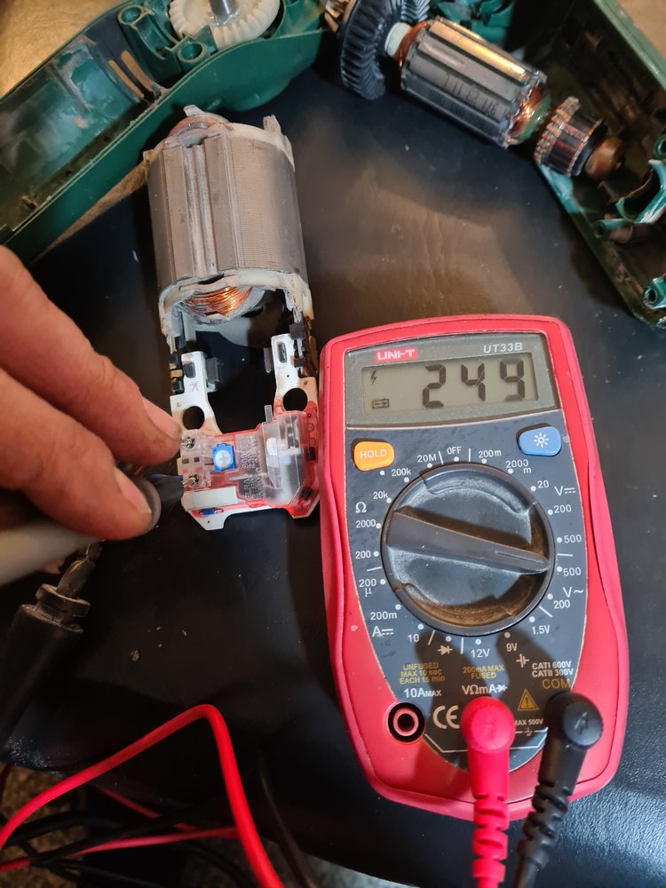

Brushed motors will run on ac and DC normallyI'm assuming this convirts to dc so 240 to the brushes is out View attachment 322229
and what would happen id was dc and then changed to acBrushed motors will run on ac and DC normally
dont think i can just unplug it soldering in to the boardunplug the windings and check resistance through them
