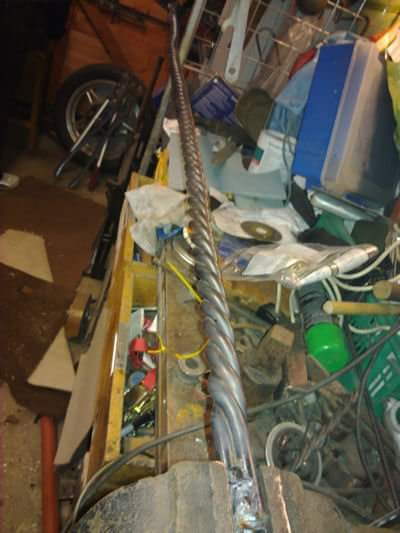

I have a length of 40 mm id x 2.5 mtrs long thin walled stainless steel tube that I want to bend to about 35 % near to one end . I've made a shaped tight fitting 30 mm thickcork block to force down in the tube & have a long batten of wood with a turned up wooden plunger that fits the tube nicely to put in from the longest side to support the cork should it feel like trying to move . it
I have a 12 tonne hydraulic jack type bending press and formers .
Over the last week or so I've done a couple of hundred miles visiting all the builders merchants and roof tilers suppliers in a 15 mile radius to try & get a 10 or 15 kg block of pitch or bitumen to use as a heat up pour in former so I can try and do the bend without rupturing the pipe /tube .
Unfortunately none of these locals have any nor do they know where to get it .
Do any of you guys know of anywhere to obtain some or where I can buy about 4 litres by vloume of it ?
Faiing that ...
Have any of you used anything else as a pour in former on a failry large bore thin walled pipe that can be easily dissolved or melted out. ( I have fire in the form of a large gas fired propane torch , a 2000 PSI power wash and a smallish true steam generator )
I looked at some new lead roll , my scrotum shrank & hid at the £75 plus vat price being displayed for almost the same 4 litre volume
I have plenty of candle wax to try it but feel that he wax will simple part & move outwards inside the tube once it gets a bit of pressure across it .
Any suggestions ?
