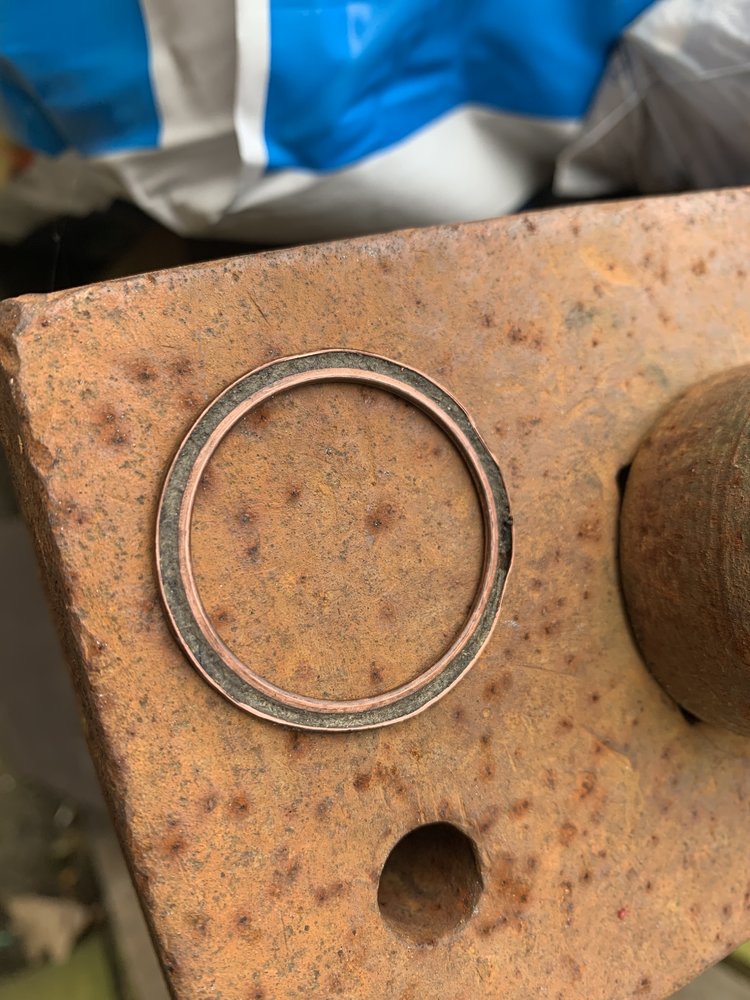

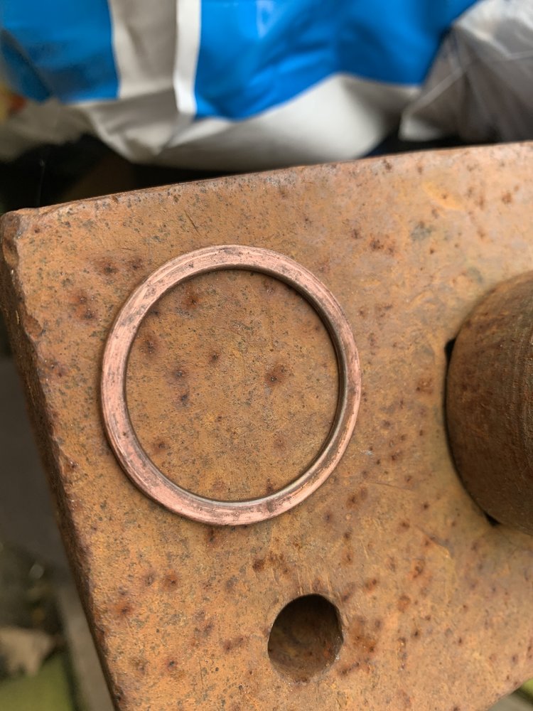

I would but it’s knackedAnneal that one

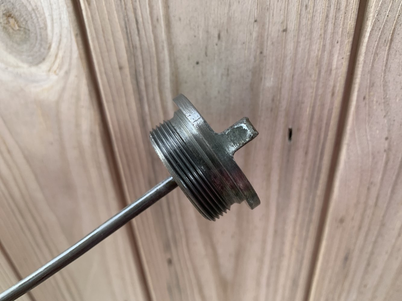

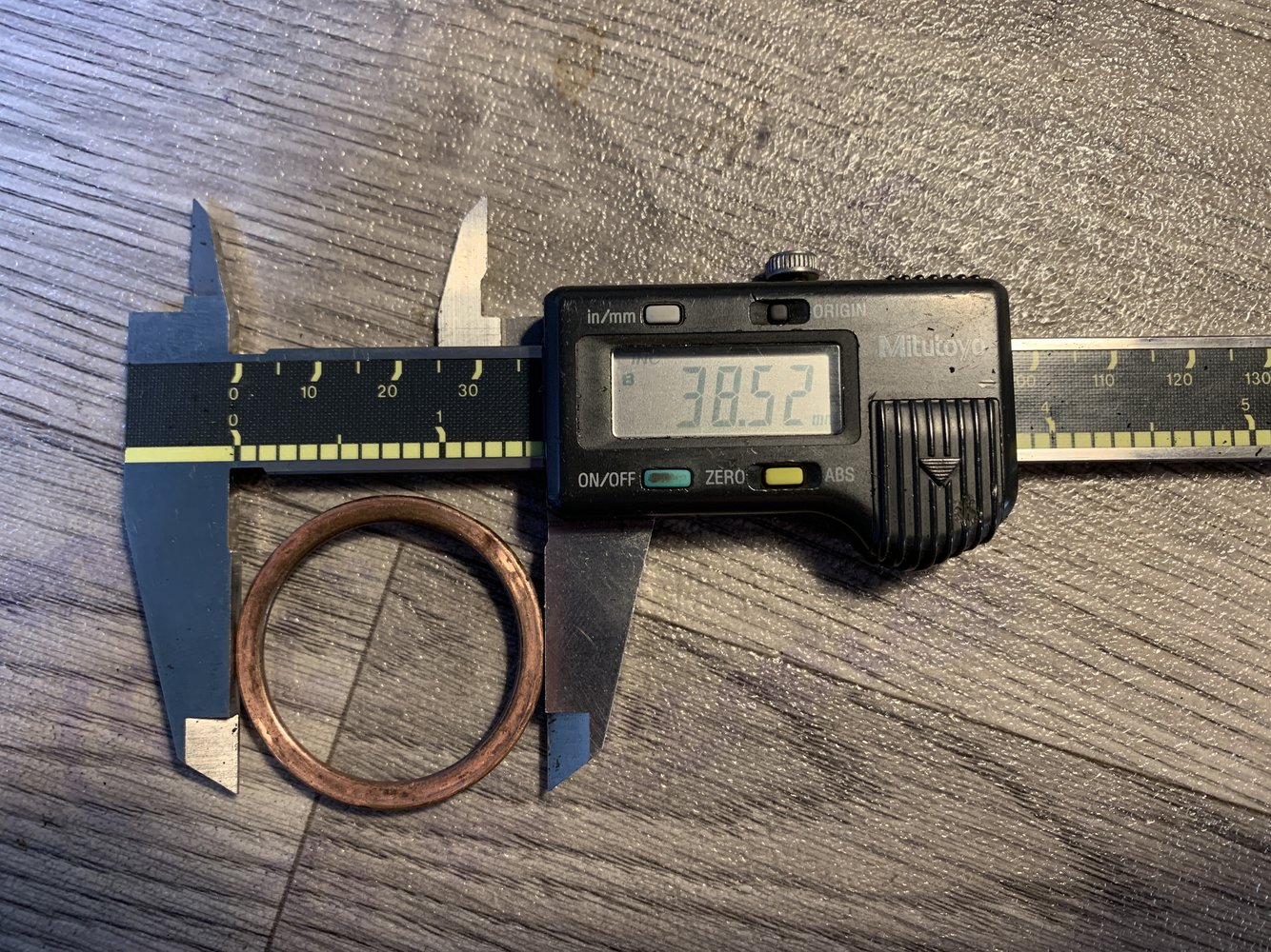

No it’s for a motorcycle oil tank / dipstick, it needs to be a pretty good fitIs it an exhaust gasket? If so what is the inside diameter of the pipe? You may be able to go for a smaller ID then you should be able to find something metric that will do the job.

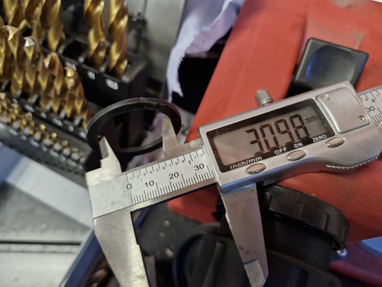

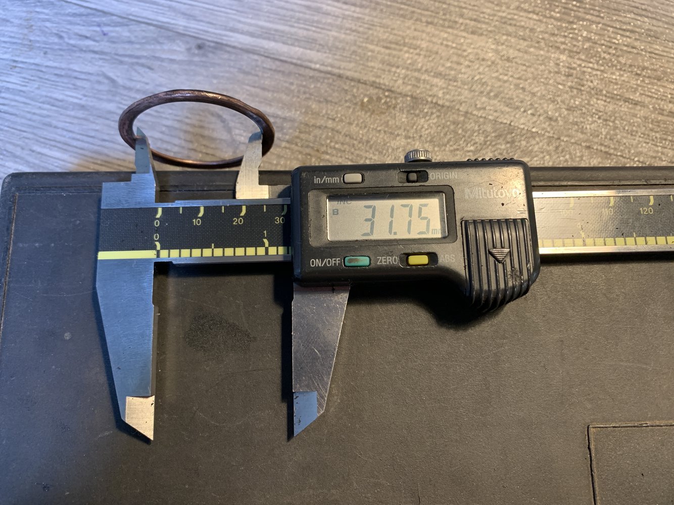

Bearing factor?Any ideas? Looks like 1 1/4” ID which I thought would be easy but can’t find any
there doesn't seem to be, but thanks.
Yes it looks like it might have to be 32mm, can always glue it in placeBearing factor?
32 x 40 x 2 mm
High Quality Annealed Copper Sealing Washer 32x40x2mm Simply Bearings Ltd
simplybearings.co.uk

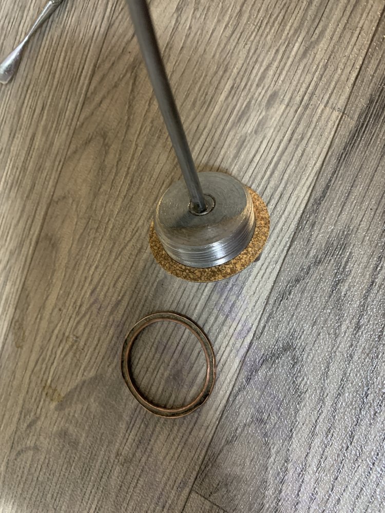

Wouldn't stay put, good shout thoughOring!
Yes, I don't see why not, but I couldn't find a fibre washer in my stash either.I have similar on some of my old engines and use fibre washers, would that be an alternative?
just use an o ringIs a flat rubber washer any good?
Otherwise maybe cut one from quality gasket paper?
