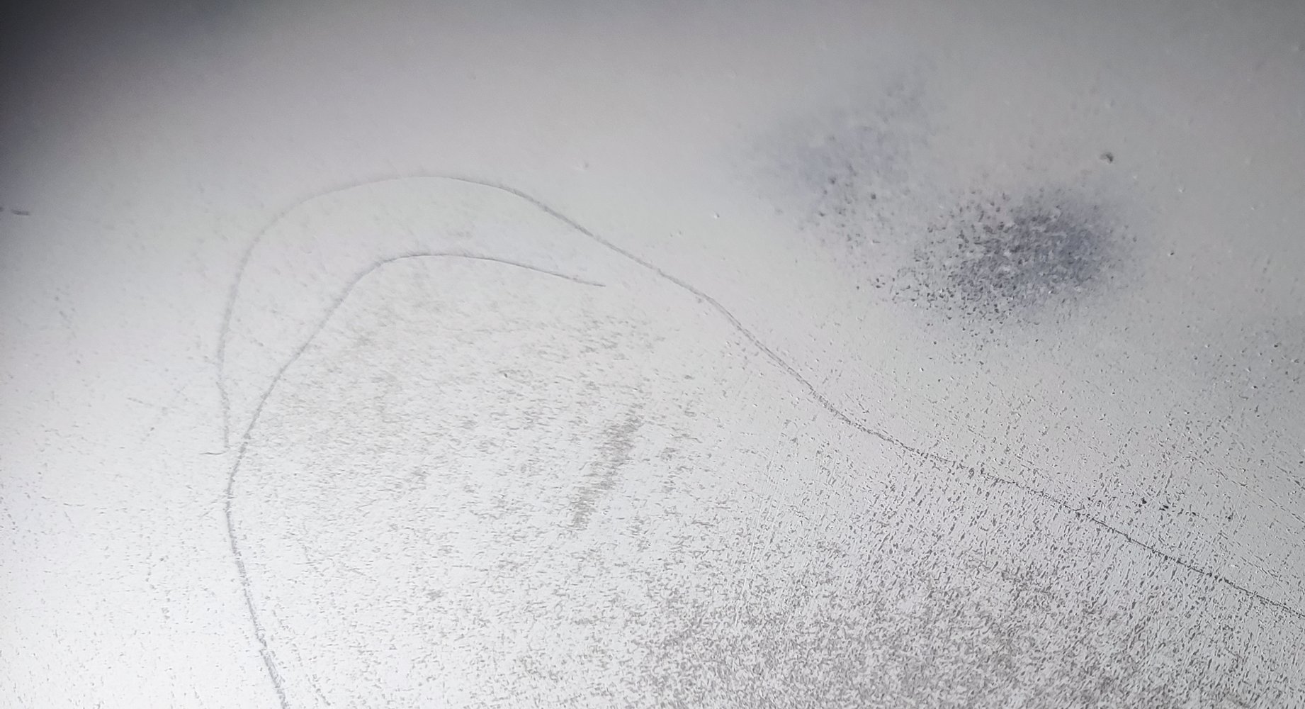

working on the camper roof that was bare metaled then given 2 coats of epoxy. guide coated and sanded with 180grit. The van is 60+ years old so far from straight.
In the photo the area outlined is obviously low, I stopped sanding as starting to rub through.
I cannot feel the low with a flat hand. Should this be keyed up and filled or would high build get this area flat (never shot high build)
