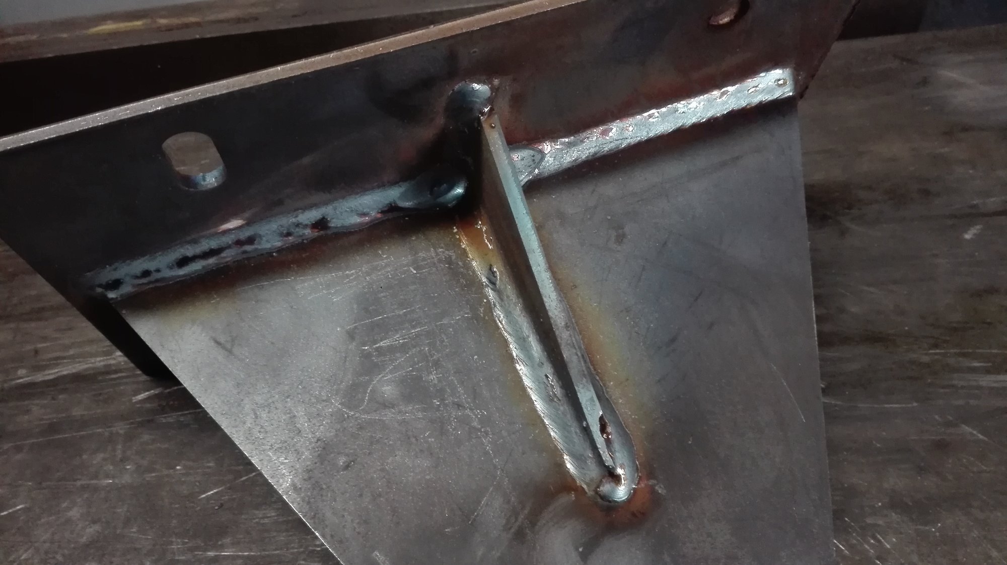

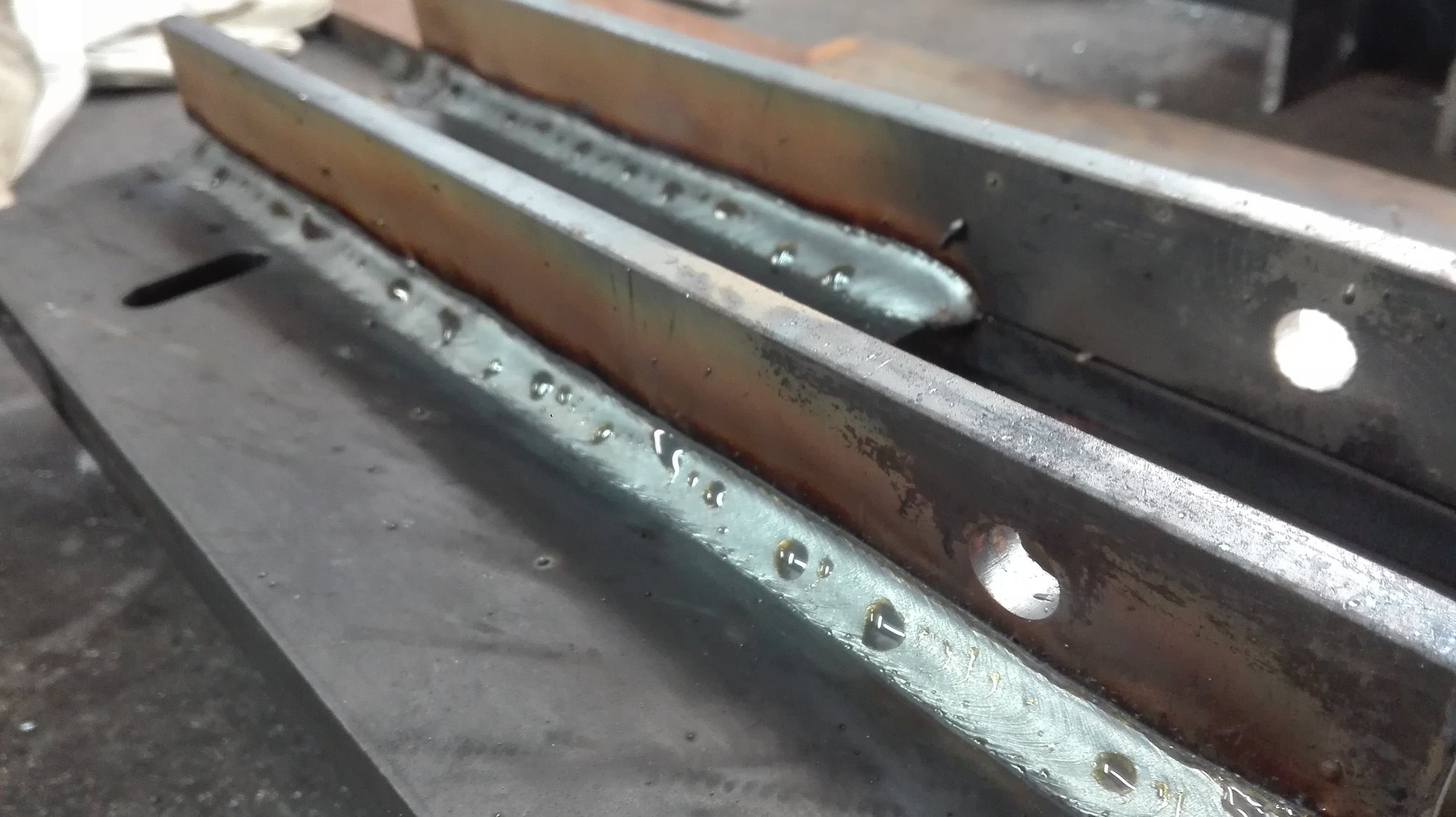

i do have my "own" unit at my work place, its 500A CV.
i can see the benefits of pulsed arc when it gets to weld a lot of thicker aluminum (i mean 6-8mm), and thats the only material im pulsing recently, because i dont see many benefits of welding with pulse steel starting from 5-6mm up to 12mm. maybe at 12mm it doesnt make that much difference but the thinner it is, i think spray arc is a lot better.
first and the most important, penetration - as good as pulse.
time to weld an item, if its 6mm thick i can weld 2 items and starting third at the time someone who's pulsing finishing the first one. why is that important? i can do what i want when i finish earlier and still getting paid for doing nothing instead of breathing the fumes.
good appearance, spatter free except some poor starts at rusted plates but same with pulse.
i can enjoy the songs played on the radio with that magnificent sound of spray arc (even on rusty steel) in the background - instead of that annoying buzz, lol.
haven't tried pulse for out of position welding, but once had to fill a quite big gap in 1G position and pulse has done a great job, doing it in one hit but slow, looked like there was no gap.
also it provides more heat input on the work piece (as the whole process takes more time than spray? at least from my experience with it), so i want to hear your opinions.
