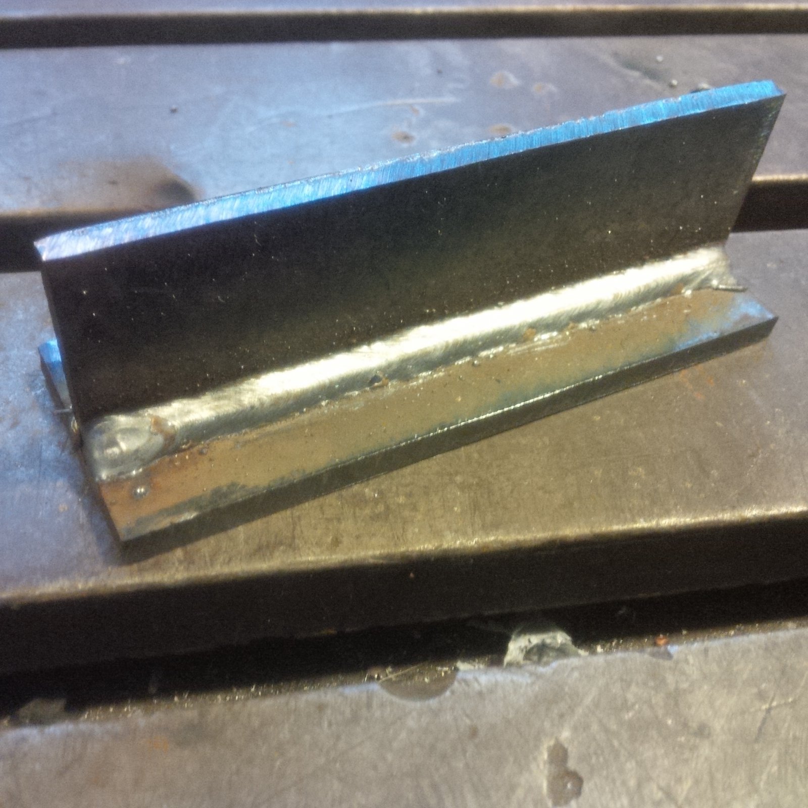

I was welding (Successfully) 1.2mm with 1.2mm wire today![]()
How fast were you running?!good stuff,you forgot to mention breed of machine...Good morning gents.
Several weeks ago I welded .6mm S/S exhaust bellows to a 12mm S/S flange using .9mm steel wire. Not the prefered way of doing it but the original welds and tacks had cracked so it was a patchup. Gas was 93Ar 3Co2 2O2 light. Had to get it back on the plane and to the job. Finish was, and supprised me, spectacular 'good'. Even the customer, when he received it commented why was it not like that in the beggining. I told him that I didn't weld it in the first place, it came from the manufacturer like that. Mind you it had already done about 50000hrs on this boat
Welding is about machine setup and machine capability. Some machines can run thin wire and weld at high voltages (mig) due to the capability of the drive motors. The new toy I have has the capability to go astronomically high in wire feed rate (something like 25m/min). Now it lets you know that this is outside the operational limits of the wire diameter, but it will do it none the less. Even makes me look like I know what I am doing, which is why I got it in the first place![]()
. It came from Supergas here in Au. Here BOC has the same just called different. The machine is Fronius TPS320Ic.Interesting I'm newish to Mig, I've been doing courses on and off for the last year,Universal and heavy have more co2 so you stay in short circuit for out of position work at higher voltages. If everyone ran 95/5 then you'd be in Spray at too low a voltage to have puddle control on thick positional work.
If doing mostly tinwork, get light, otherwise get universalInteresting I'm newish to Mig, I've been doing courses on and off for the last year,
