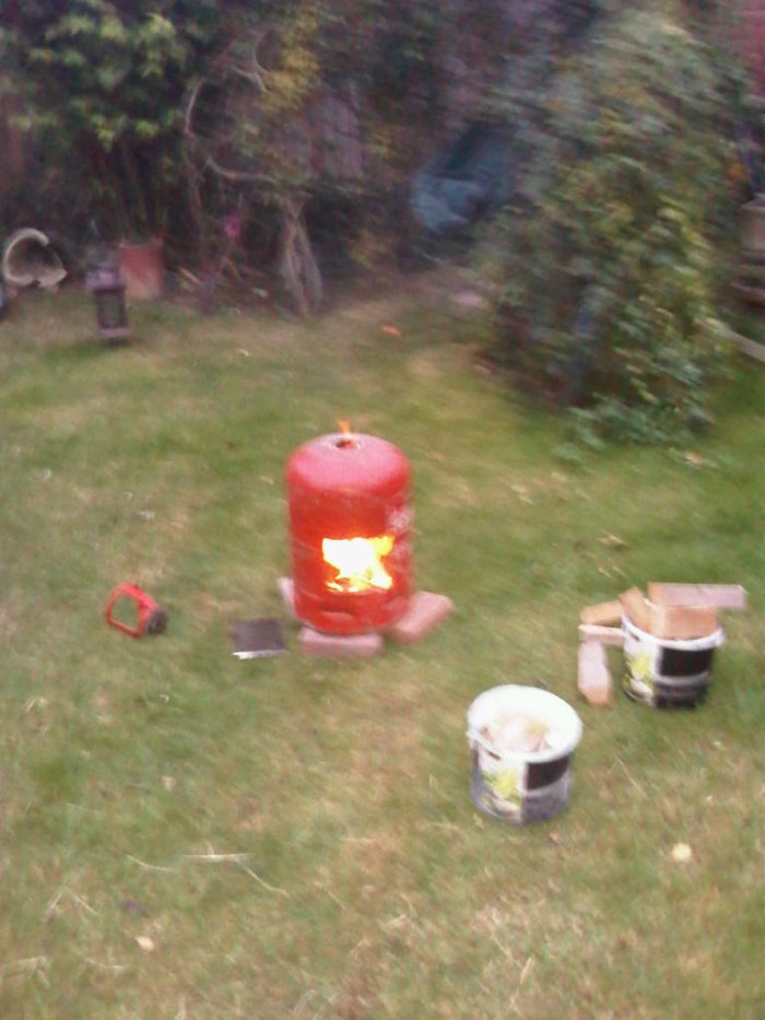

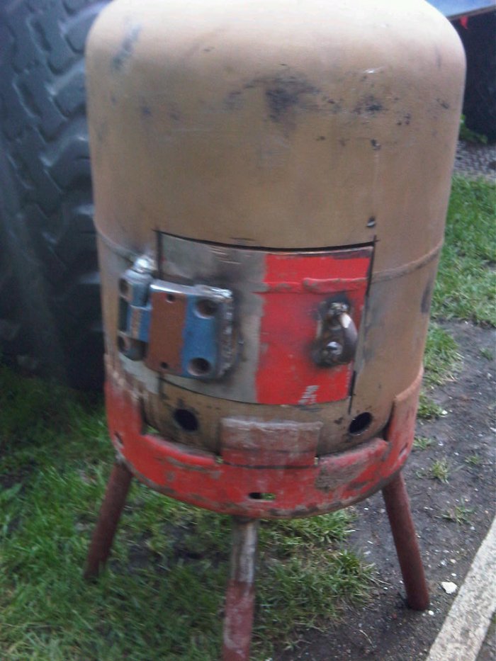

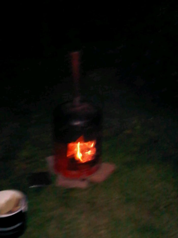

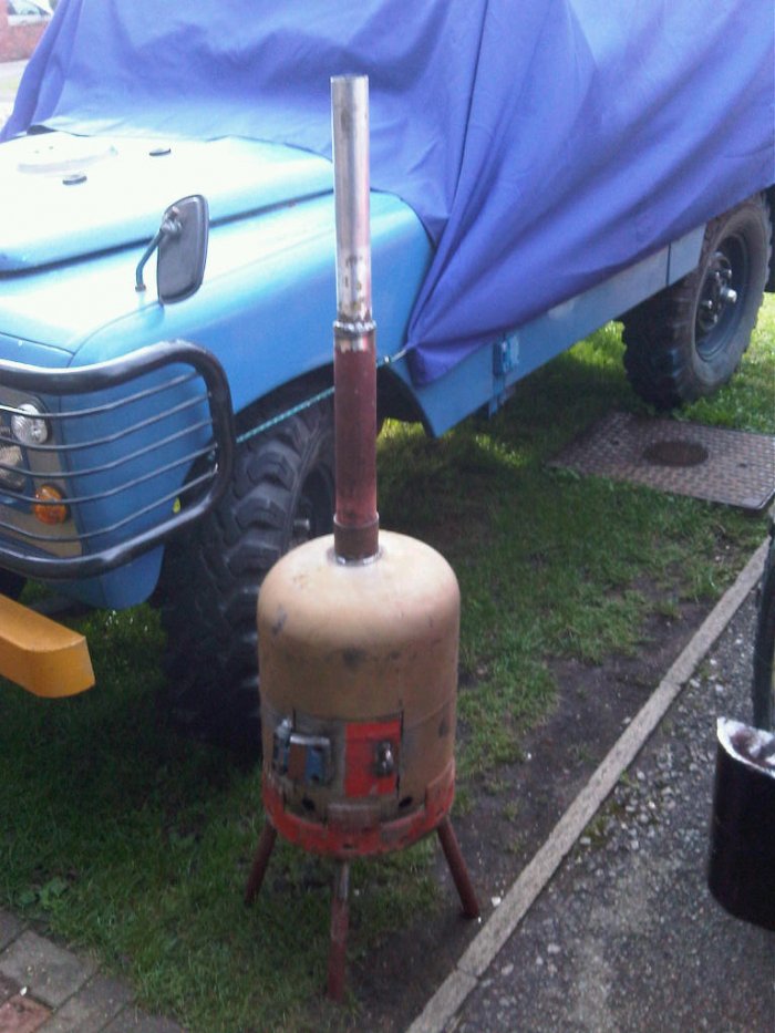

hi gents, been a busy little bee today, decided for ideal bit of heat when camping just slung together a nifty little log burner, works quite well me thinks, have a look and let us know what you think
relatively simple to make, Old (purged for 2 days) 13kg propane tank, bit of old gas barrel, 4" grinder, 9" grinder, mig set, cutting discs and flat wheel, and approx 1" drill (depeding on sive)
