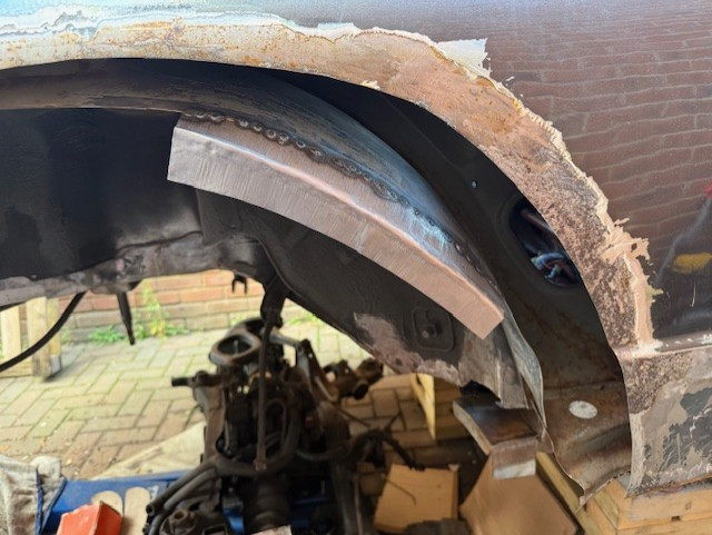

I have another thread on my R32 GTR restore but I think this question deserves its own thread/attention.
I started remaking the wheelhouse but stopped as I'm not sure the right way to do this, although I'm sure there is more than one way to achieve it.
The main issue is that no inner wheelhouse parts can be purchased, either official Nissan, 3rd party replicas or 2nd hand. The same goes for the outer arch which I find quite mad considering most other classics of this age have these replica parts available!

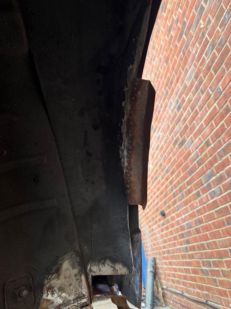

So I have to make it myself. Now, the main question I have at the moment is about the wheelhouse structure and if I can do it the way I started or if I need to add the extra lip I've omitted at the moment.
Originally, the inner wheelhouse had a right angle at the bottom of this piece marked and the same goes for the outer arch, this then joined together with, I presume, seam sealer and spot welds. The old wheelhouse and arch were so badly corroded with a botched repair done before that I've got nothing to work from.
If I need this extra lip, I'll do it, but if not, I won't as it adds extra work and complexity to an already time-consuming job, not to mention my lack of skill with metal fab at the moment. My other thought is that my current way may be a benefit for rust prevention in the future as there will be no seam for moisture to get trapped in which was the reason this failed the first time around.
So, can I do it the way I started or do I need that extra lip on the inner arch? I will of course have the lip on the outer arch...
Sorry if I've explained this badly but hopefully someone gets what I mean!
