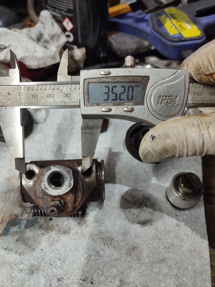

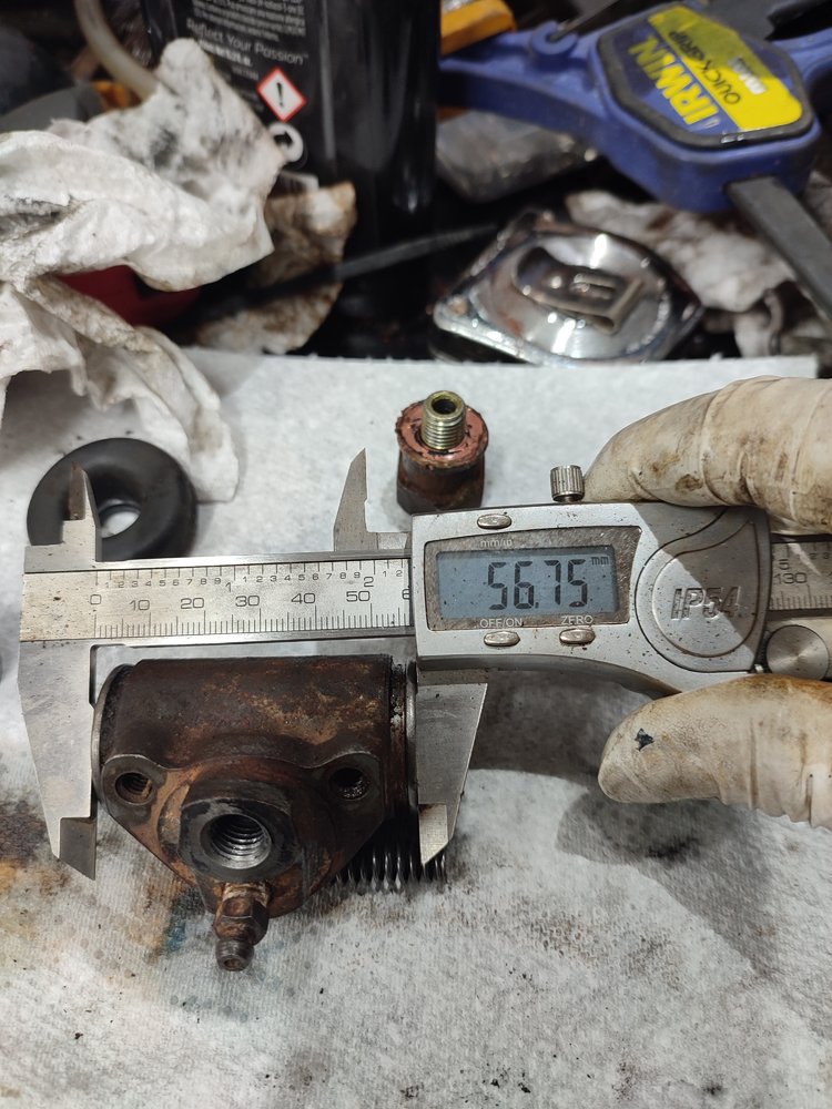

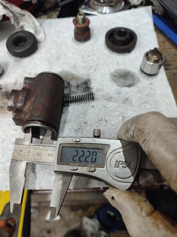

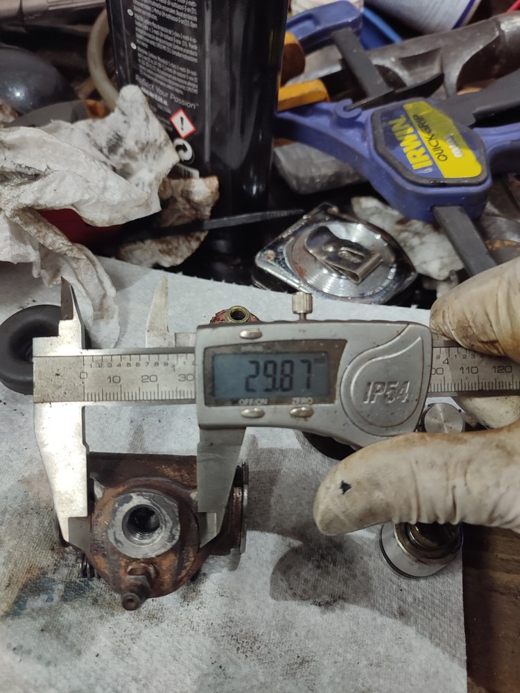

Have a slight conundrum trying to find either seals or a replacement wheel cylinder for a dumper, is a thwaites sprite 750 for what it's worth. Thought I was into a winner with one website but is discontinued and he didn't have anything suitable.

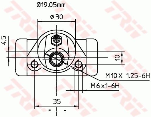

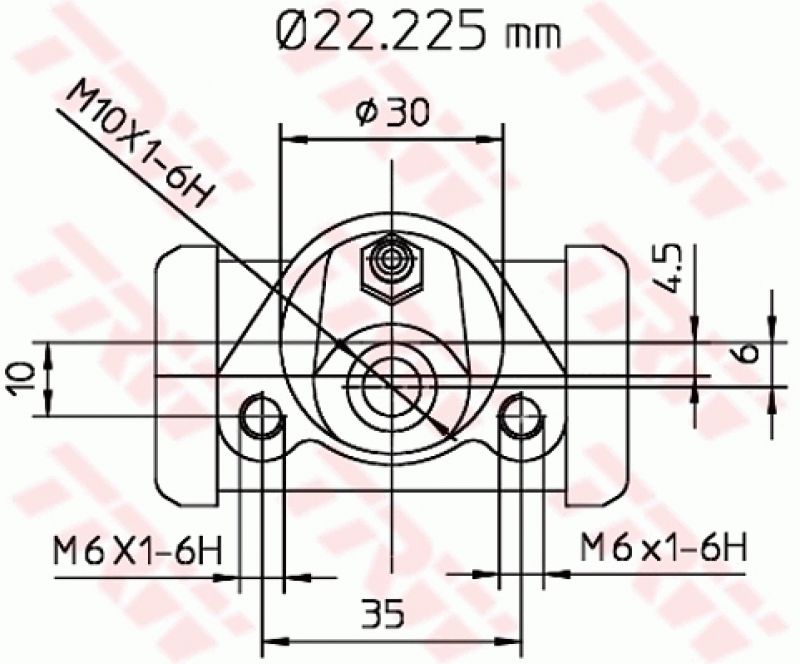

I can modify the backplate if holes are needing redrilled or whatnot but nowhere seems to give dimensions of the cylinders, only really important dimension is the width. If anyone knows somewhere or a parts book that lists the dimensions of cylinders that would be very handy.
Transit Mk6 looks similar but absolutely no idea how big it is
