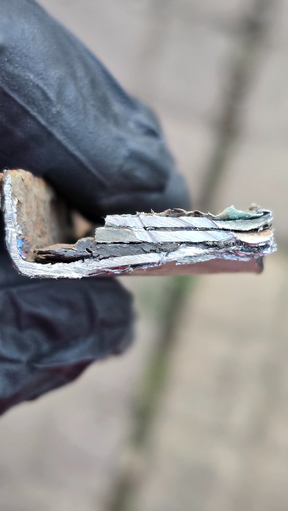

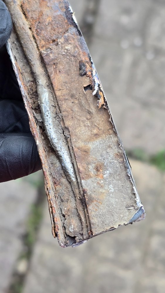

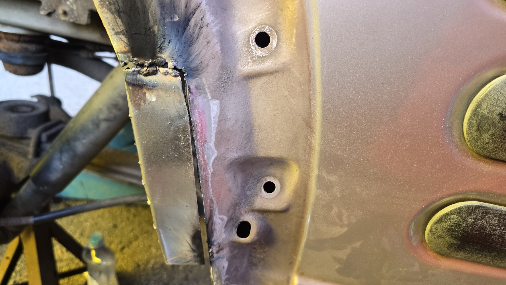

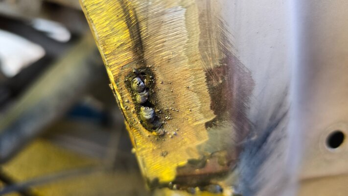

I've hit a hurdle in my work van welding on the wheel arch. I actually think I know what's causing the issue, but not entirely sure on how to sort it. I figured some of you may have encountered this as well and may know a quick solution.
For perspective and reference, I'm using 0.8mm flux core, 55 amps and 1.2mm replacement mild steel metal.

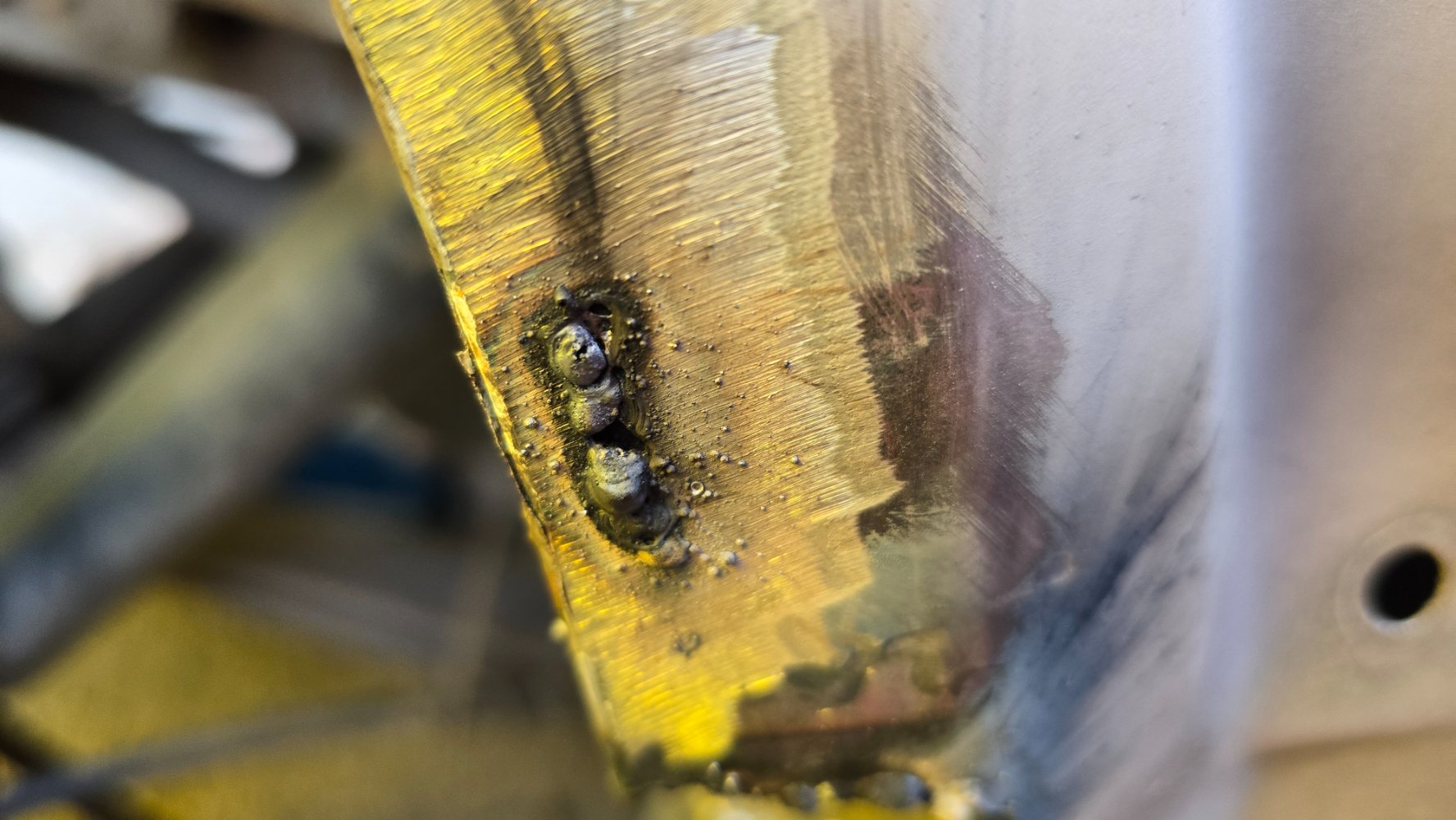

The problem is that the new piece won't fuse to the original wheel arch metal I'm trying to weld to. I've ground the mating surfaces on both sides, back to shiny metal. What's happening is the arc keeps "blowing out" and it's leaving black marks, smoke, a few little flames, and hardly any welds. Just to test my theory, I ground back some paint further up and tried laying a weld down on it. Guess what? I got the exact same problem!

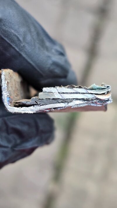

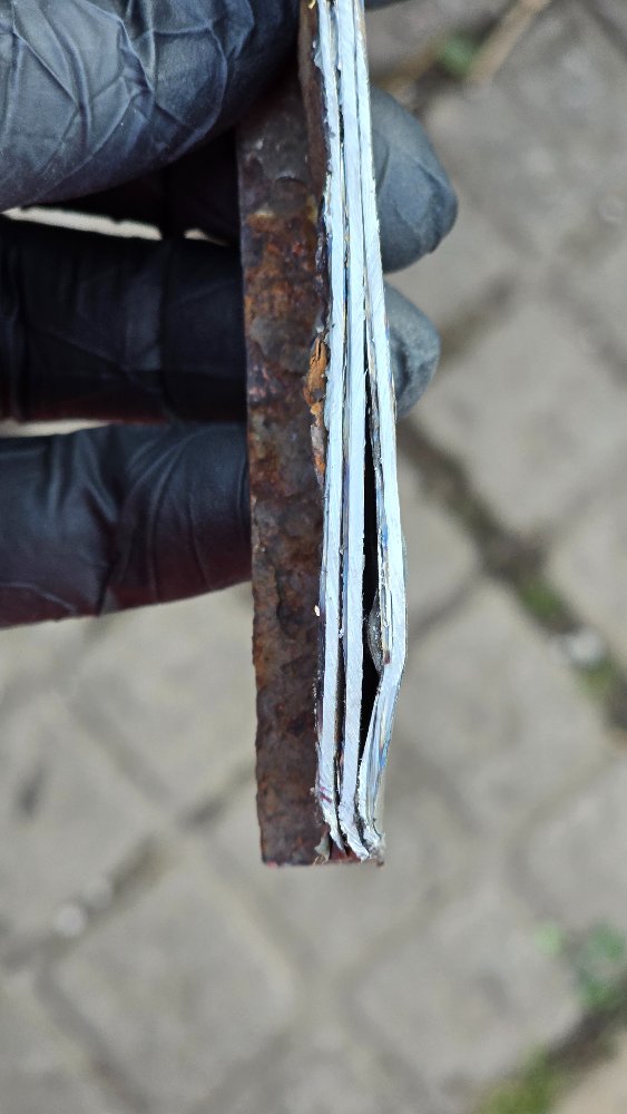

I looked at the rotten piece of wheel arch I chopped out, and it seems to be bonded in a triple layer with some kind of black bonding. I suspect this bonding is the source of the impasse because it's not allowing weld penetration, or is effecting the electrical current in some way. The earth clamp is attached very closely to where I'm welding to (or trying to).
I just wondered if I'm missing a trick here, or whether it might need the inner 2 metal layers ground away, a different type of welding (TIG, or MMA), or whether I'm genuinely up a creek without a paddle and it'll need a complete wheel arch.
Thanks for any tips.
