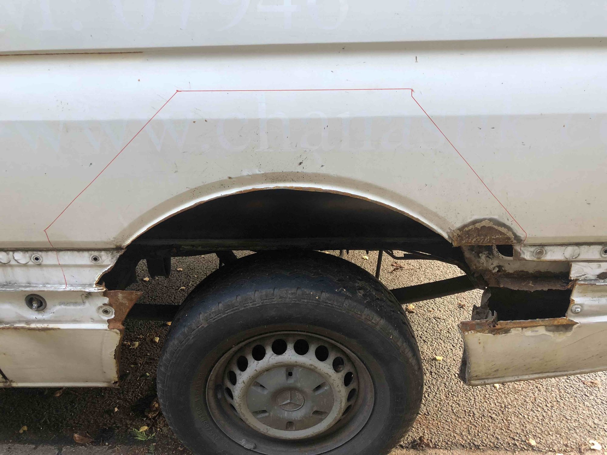

I am currently 'rebuilding' the rear wheel arches on my 2007 Sprinter, which have essentially rotted away.
I have a patch panel for the outer skin to weld into place, and am planning to do this with plug welds, by cutting out the existing good metal and leaving enough to form a lip with an air joggler. If necessary I can also seam weld the join, but with less risk of burning through. So this bit I think I have sorted......

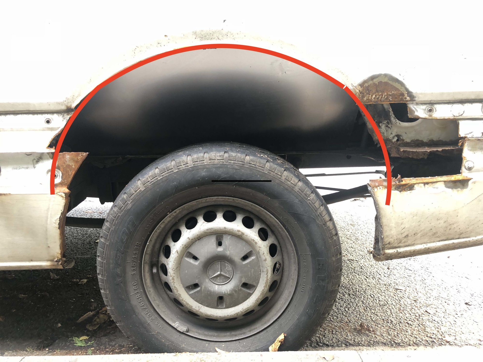

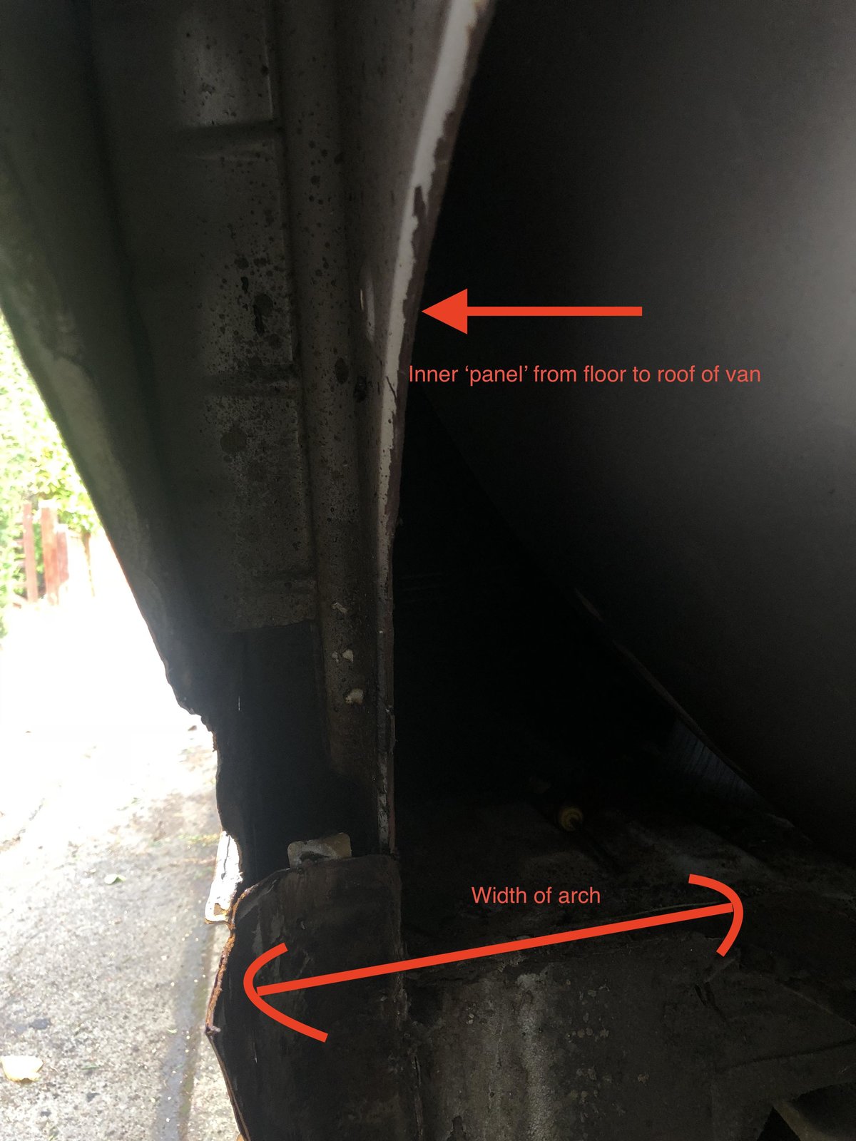

For the inner part of the arch/well, this is made currently of two sections, a crescent shaped piece that sits between the outer skin and the inside 'panel wall' of van, and then the inside 'tub shaped piece.
I am finding it difficult to work out what the 'rules' are on replacing this - it would be a lot easier to form a single piece to make the 'cresent' shaped piece and the inside tub to weld to the patch panel that I have sourced, but from an MOT / roadworthyness point of view do I need to recreate exactly what was there originally?...
