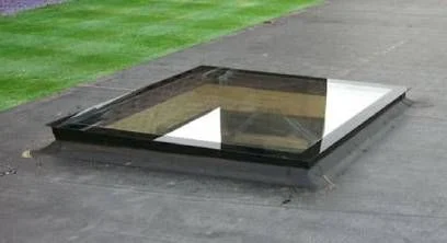

I'm thinking of taking the easier and slightly cheaper way out of this problem by replacing the lantern with a flat skylight pane like this one. I'm wondering what people's experiences are of flat skylights. Are they noisier than a lantern? Need more cleaning ?
These are available on eBay, bit dearer than a flat pane, and could be more prone to leaking:

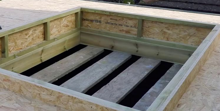

This is what the upstand being made is in case you don't know what I'm talking about:
The house is semi detached 1930s with 1970s extension. The external dimension of my upstand is approx 2200 x 950mm so it's a fair old size.
