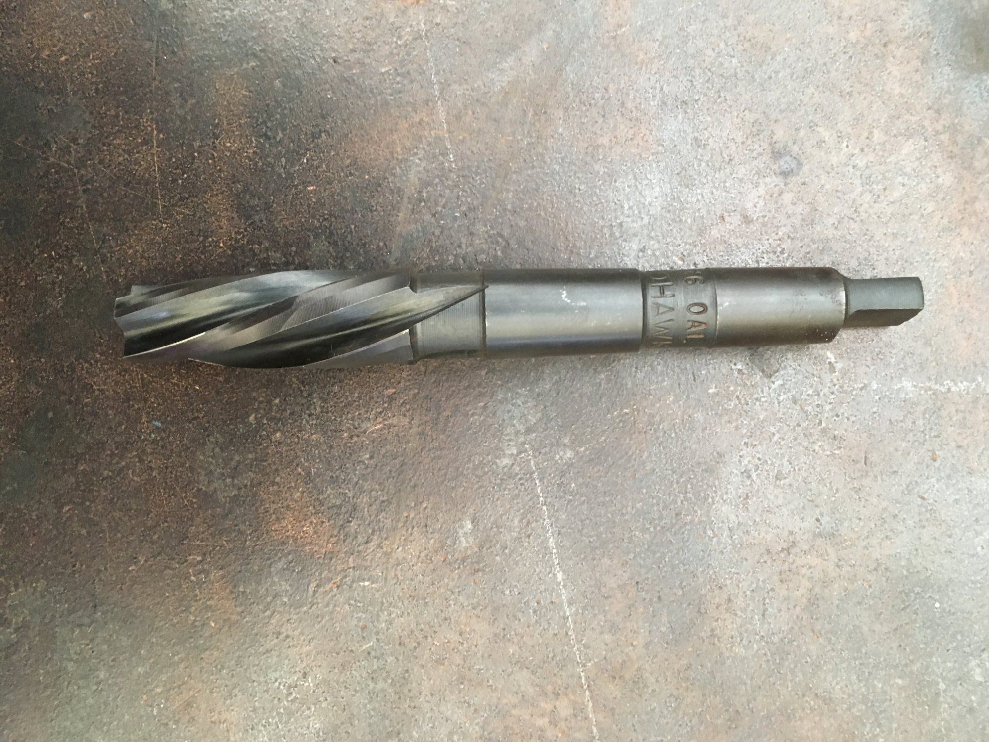

Robben77 Member Messages 126 Location England suffolk Oct 25, 2016 #1 Hi does any know what this is please? IMG_0112.JPG 525.4 KB · Views: 82
Spark plug Member Messages 4,062 Location Durham, England Oct 25, 2016 #2 It is or was, a drill bit. Looks like a 3/4 flute and had the end ground flat to drill flat bottom holes.
Hood I am obsessed. Messages 17,750 Location Carnoustie, Scotland Oct 25, 2016 #3 Looks like a chopped off spiral reamer, flutes are left hand to push the cut material ahead of the reamer and out of the hole so as to give a better finish.
Robben77 Member Messages 126 Location England suffolk Oct 25, 2016 #4 Got a bit more info off it, its make is Mohawk and it's got .790x6 OAL written on?
Hood I am obsessed. Messages 17,750 Location Carnoustie, Scotland Oct 25, 2016 #5 As said it looks like a spiral reamer that has been chopped off. Reaming dia is 0.790 inch and overall cutting length of 6 inch.
Robben77 Member Messages 126 Location England suffolk Oct 25, 2016 #6 Ok cheers fellas, not worth sticking on eBay then?!
Hood I am obsessed. Messages 17,750 Location Carnoustie, Scotland Oct 25, 2016 #7 Someone might wan't it, if it is sharp then may sell even though it has been chopped. Just have to hope someone needs a hole reamed to 0.790 inch.
M Mee Banned Messages 1,435 Location Here and There Oct 25, 2016 #8 Its a counter boring tool for boring flat holes into thicker steels.
