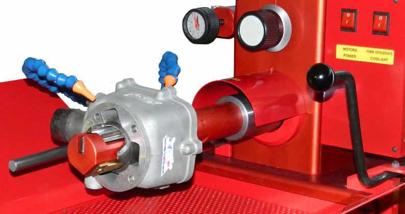

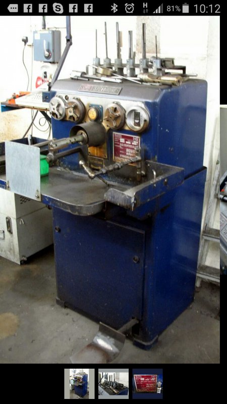

Yeah it says honing machine but I do not know how it's used. It would have made more sense if it was vertical to me.It looks like a cylinder honing machine.
At first glance I thought it was a hemodialysis machineJust wondering what this is used for. View attachment 79219
generally cylinders are supposed to be cross honed ie the hone moved up and down the bore regularly as it rotates to create a cross hatch effect, to aide with the cyl/piston ring interphase.
Well there is----- gravity---- I would not like to try and hone a multi cyl block on one! and move it up and down the bore. whilst trying to support it.
