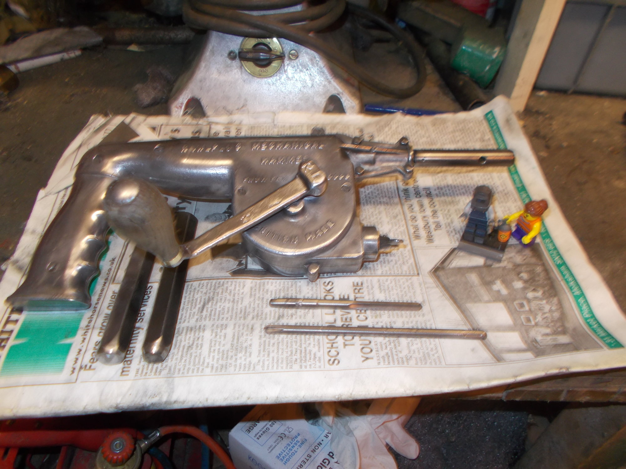

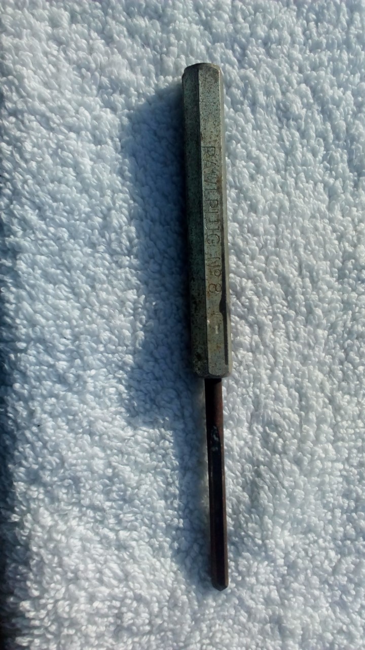

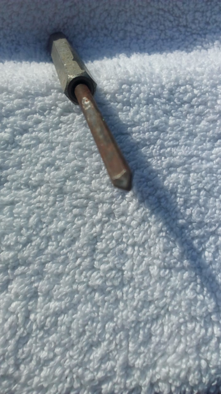

It doesn't go in a drill, it goes in your hand !
As said, hit it, turn it, rinse and repeat. Excellent at the top of a ladder before battery drills were invented, and even now has it's uses, as you don't have to push hard as with an electric drill, pushing the ladder away from the wall.
I've sunk MANY holes with Rawl Drills !
You literally whack it with a hammer and then use a spanner to turn the body and then whack it again. You need the fat hex to get a decent sized spanner on to get enough purchase to turn when deep.
