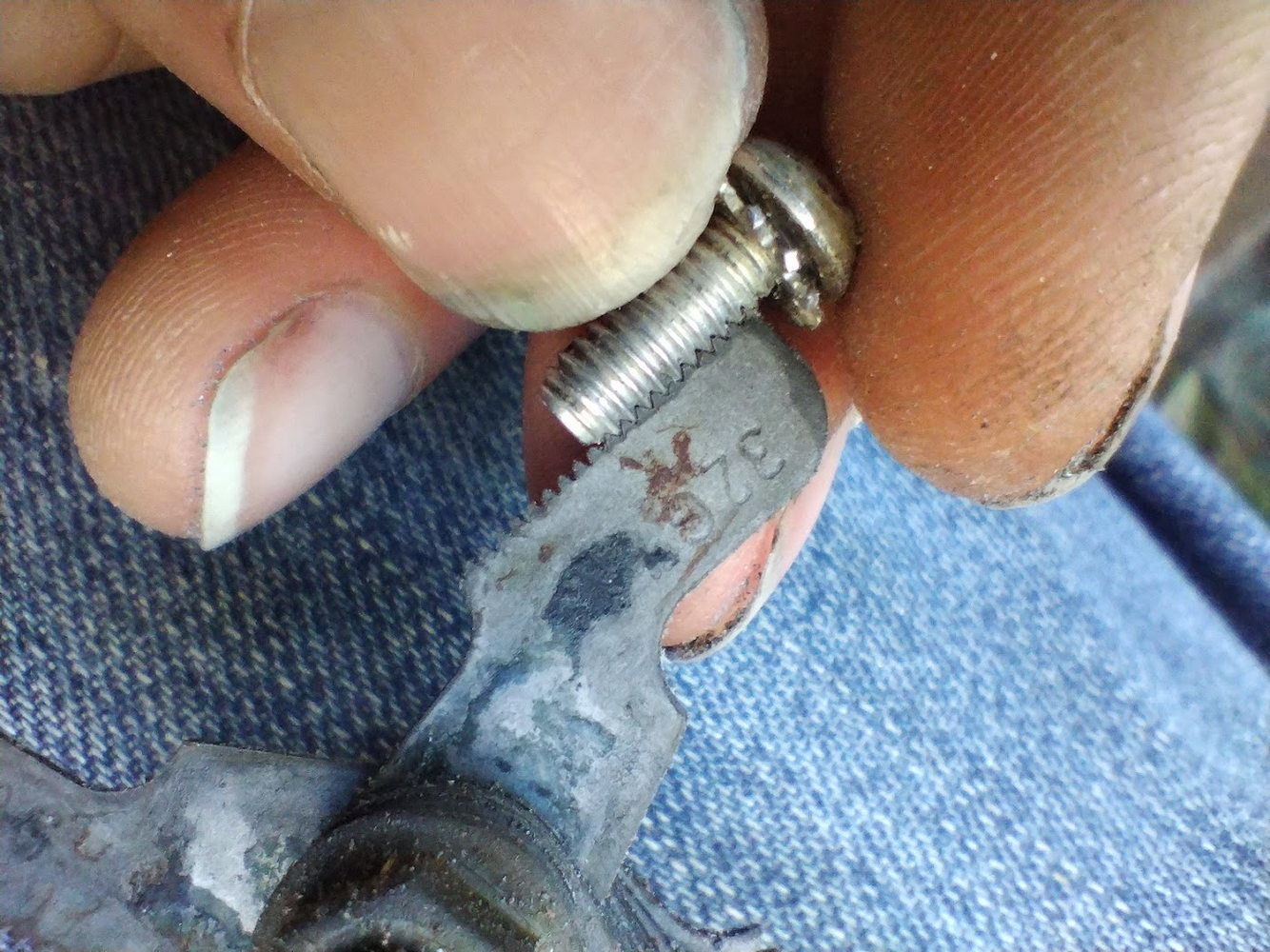

From the style of fastener (I've forgotten the name), I'd say that it's an American thread.
Maybe a 10-24.

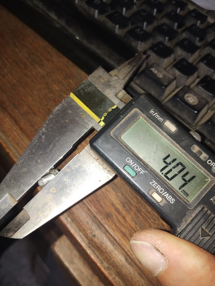

The '24' in 10-24 is the tpi. Given that it is a 32tpi thread gauge in the picture, some other option from the UN-series (perhaps 8-32) might be better.
Yes, it's #8 x 32. Very typical in American made stuff.
I have a few in a tin. Do you need one or just trying to identify what you have?
8/32 unf would seem about right.
If the gauge hadn't been covered in so much crap I might have noticedThe '24' in 10-24 is the tpi. Given that it is a 32tpi thread gauge in the picture, some other option from the UN-series (perhaps 8-32) might be better.
