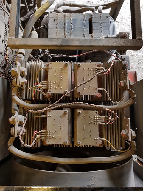

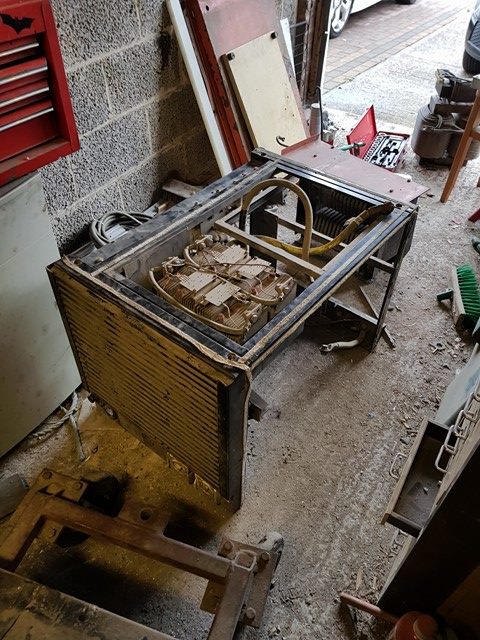

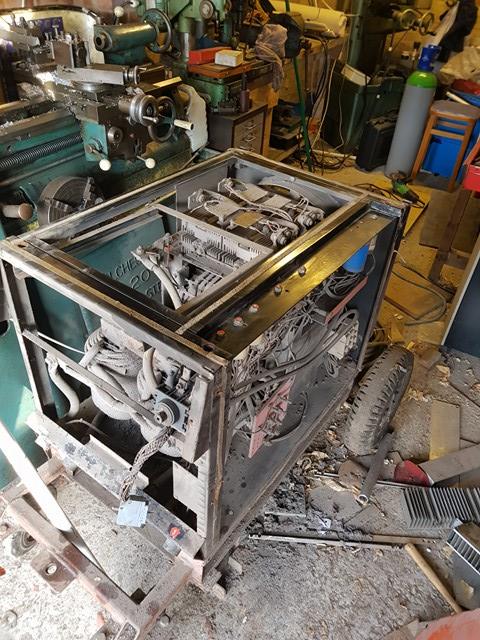

I've taken the case off my Kemppi to blow the spiders out before I test/sell it but there's a few interesting things inside:
First off:

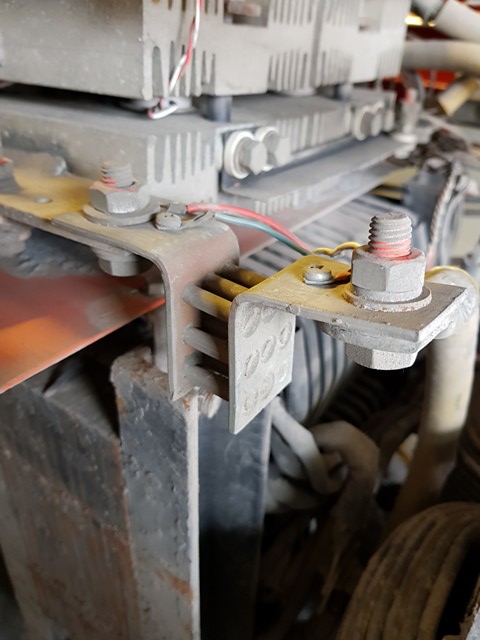

There's nine pieces of round, about 1/4" diameter, connecting the two haves, one side is welded to the heatsinks with the SCRs and the other side is bolted to a 95 square mm cable
. Some kind of weird fuse?

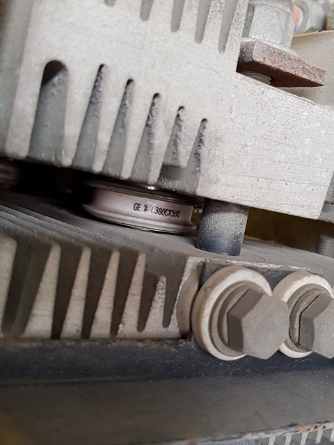

Here's an SCR sandwiched between two heatsinks, there's 4 in total. I was going to ask what they were but I googled the part number and found a datasheet.
That's the bulk of the weight

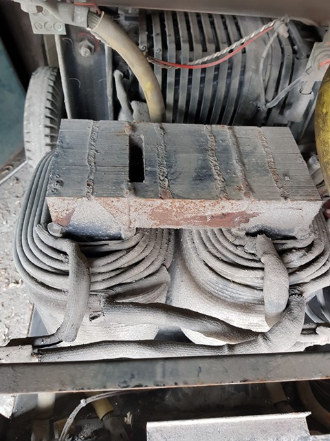

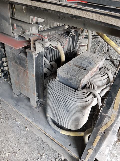

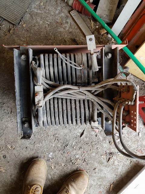

, the big transformer towards the back is where the mains input goes, haven't figured out what the secondary is wired to yet. What I'm more curious about is the smaller (Though by no means small
) one at the front. It appears to have a 1:1 turns ratio, no extra taps on either coil and the coils are shorted together?
A giant inductor? What does it do?

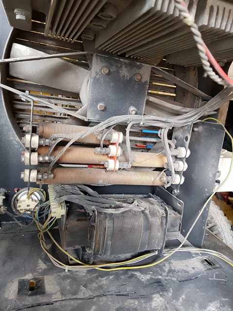

Some more random pic of its innards if anyone's interested:

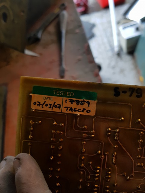

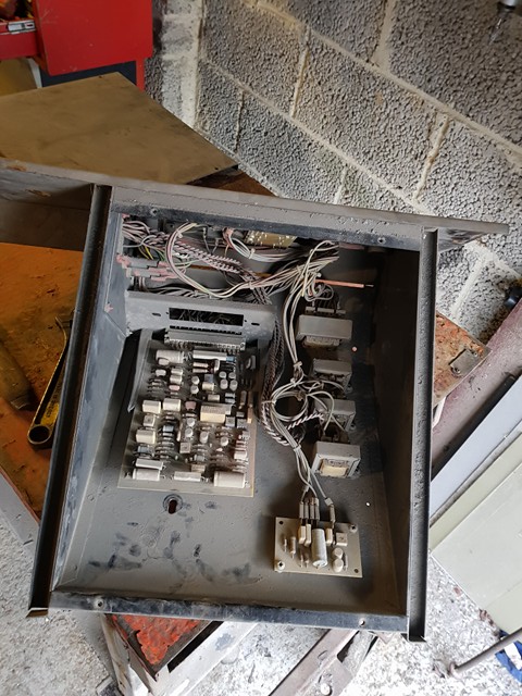

The control panel and associated circuitry all slide out the front, two screws and a big 20 pin connector. Test sticker on the back of that circuit board:
Probably due a service.

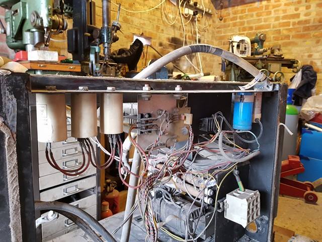

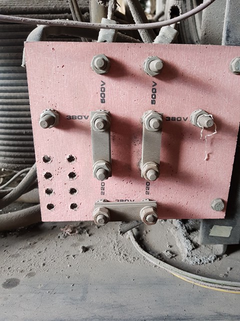

Mains supply (Through a switch on the front) goes to the middle two posts, then swapping the brass bars around lets you run it from 220, 380, 415 or 500 volts mains. Each post is connected to different taps on the big transformer.
Heat sinks and drive circuits (?) for the SCRs. They're wired side to side on top (See the wires?) and front to back on the bottom.
There's some more interesting stuff behind the big transformer but I can't get the back cover off so I can't really see it to take pictures.
