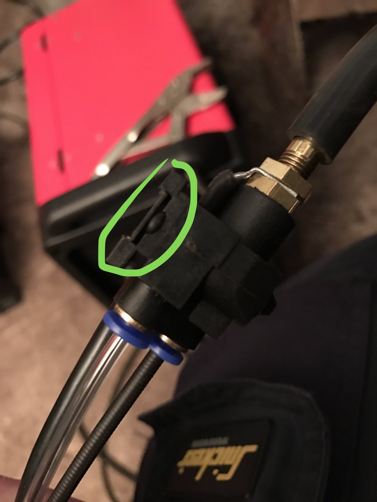

Good to find it, just too bad it happened, as far as I recall the regulator cuts
down the pressure to 3.4 bar, from a couple of thousand psi, and don't use
an oxygen regulator either as they do not cut down enough.
I can't emphasise enough to get a quality regulator, some of the cheaper
ones pulse and you can see it in the arc, some people may never see it
but those who weld a lot will.
