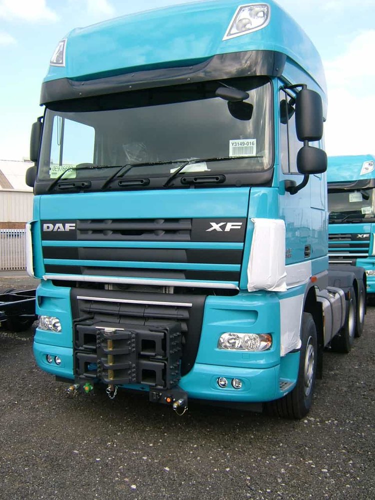

Tractor drawbar pins are normally EN8 if it helps, and not heat treated either.Been asked to supply a pin 35mm round bar 250mm long it's for a pin between a lorry and a trailer , what material would be best or can you buy such things somewhere
Thanks in advance
