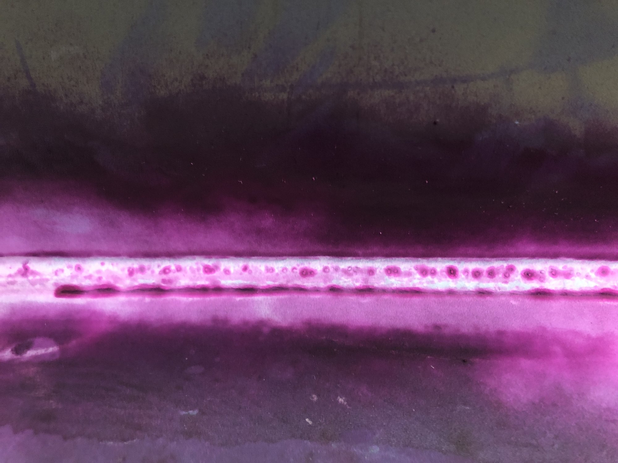

looks like that crack test sprayNot familiar with the purple stuff you've put on it. I'm assuming it's a t-fillet joint, mild steel.
Looks like a lack of fusion at the bottom for most of the joint so either insufficient power or you may have biased the upper portion of the plate. Also looks like a lot of porosity; was this MIG? If so, perhaps a gas problem.
As others have said ^^, more information and perhaps pics from a better angle would help with answers.
Thanks everybody ! Indeed it was a case of surface porosity , as FOR the lack of Fusion im not so sure . The guy doing the dye penetrant testing didnt care to explain to much
NexT time i will have more information on the matter
. The area should be cleaned, the dye sprayed on, cleaned, then sprayed white which then indicates any defects where the penetrant 'sticks' The photo does make it look like dye has just been sprayed on? Dunno, hard to tell.
) then x-ray or ultrasonics would give you the best 'picture' of your weld but now you're into expensive equipment and three-year exam re-sits
As said by Paul, the dye should be sprayed on, allowed a few minutes then wiped off properly before the developer sprayed on. Not cleaning it properly will lead to the dye showing up everywhere and masking the true issue@Tinbasherdan
