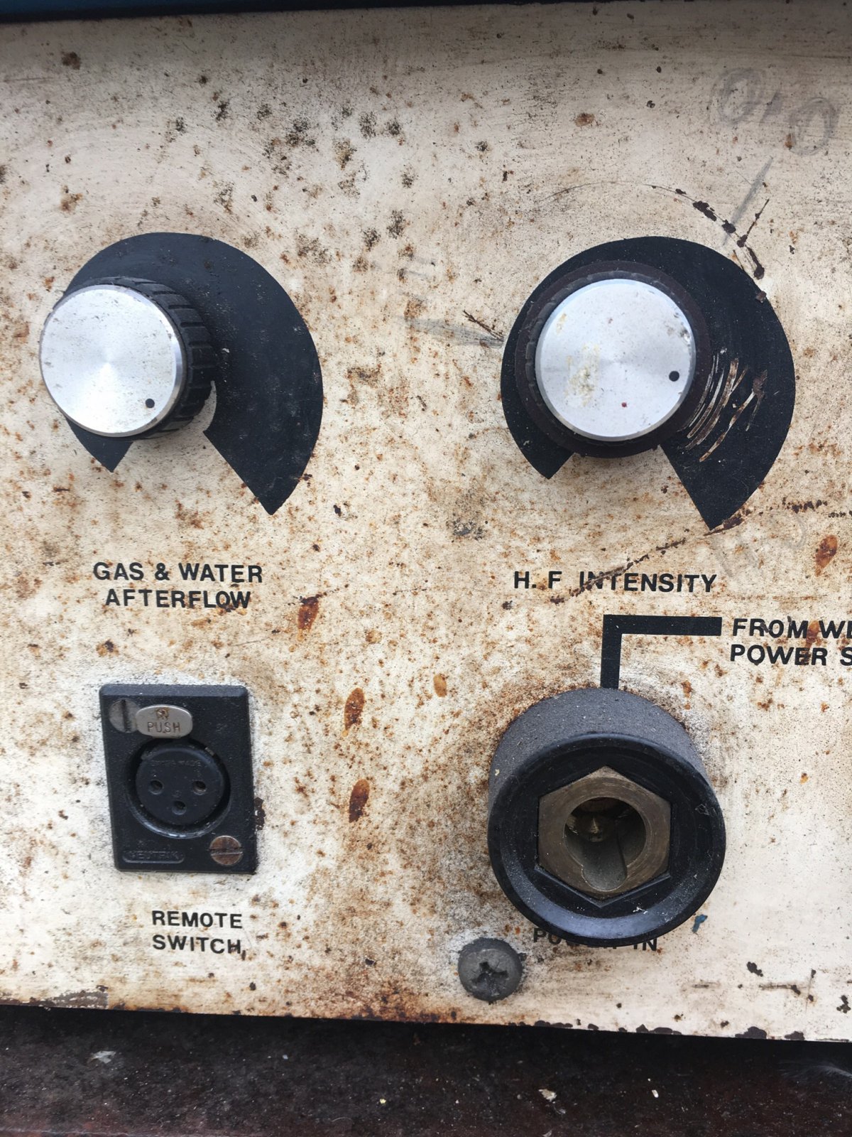

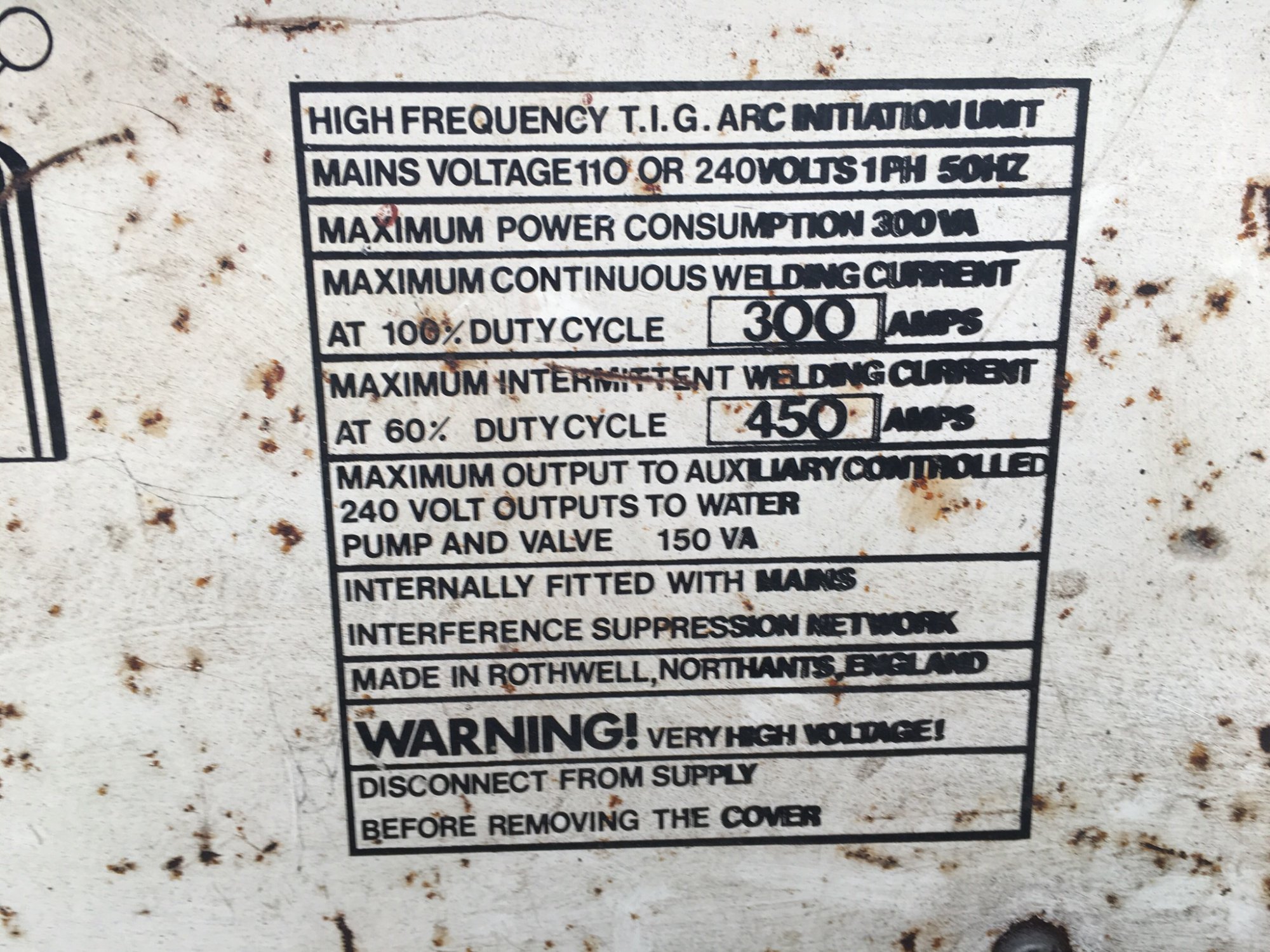

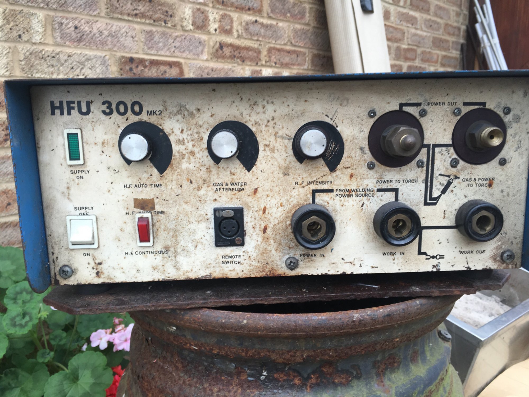

What i'm seeing is this -
To get welding current to the torch you'll need to connect a stick welding unit to the HF unit through the "Power In" & "Work In" using dinze plug cables, another earth cable then goes from your HF unit to your work piece. The torch is connected via a 3/8BSP nut to the gas connection on the right hand side of the HF unit, the power would then come form the bolt lug connecter next to the gas connection.. you'd then need that torch to have the XLR plug on it to the connect to the remote plug receptacle. As far as I know, if you got that set up done you'd be away.
It'd need to be a two piece torch with a separate gas and power line.
