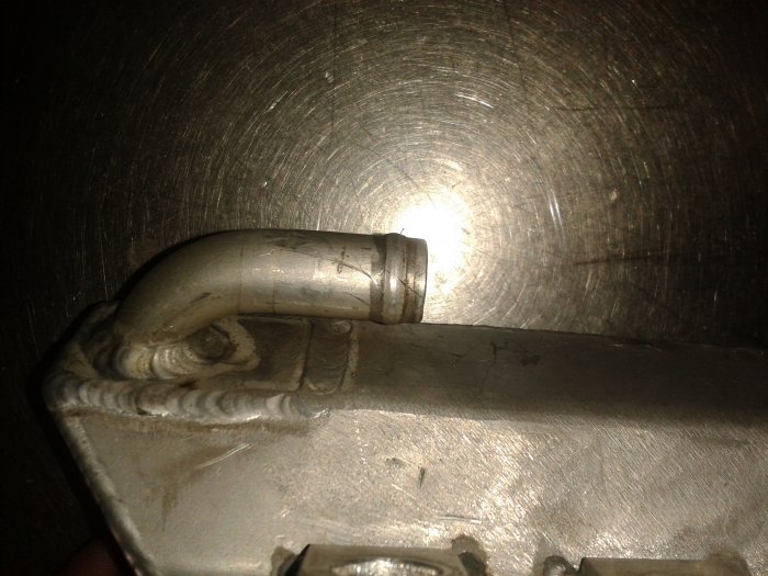

SBK Member Messages 458 May 6, 2013 #1 Hi all Can anyone tell me what the tool is called to flare alu pipe like this? I have searched for a swage kit but not sure if that will do the job. cheers Chris 2013-05-04 11.56.43.jpg 70.6 KB · Views: 426

H hotrodder Member Messages 4,539 May 6, 2013 #2 tube beader, there's a few threads about 'em on the forum here's one... http://www.mig-welding.co.uk/forum/showthread.php?t=5553&highlight=parker+tube+beading that mentions the usual brands and DIY methods
