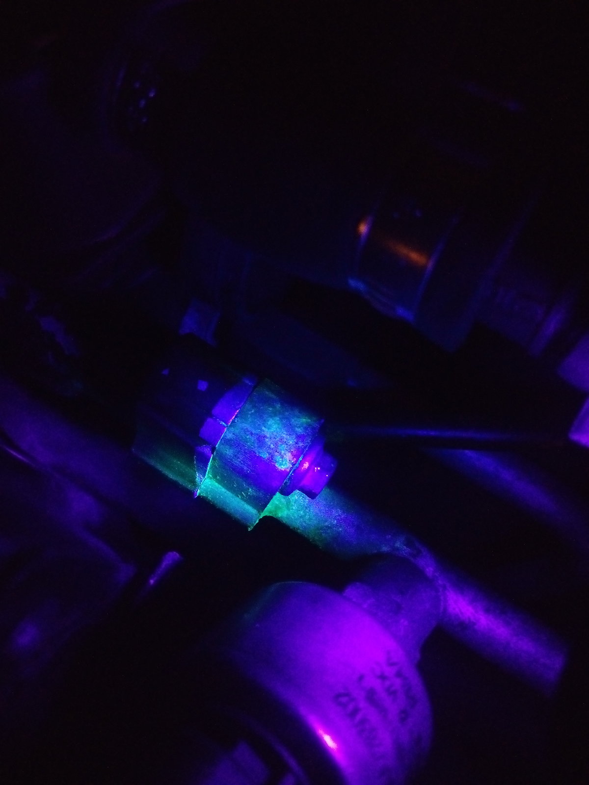

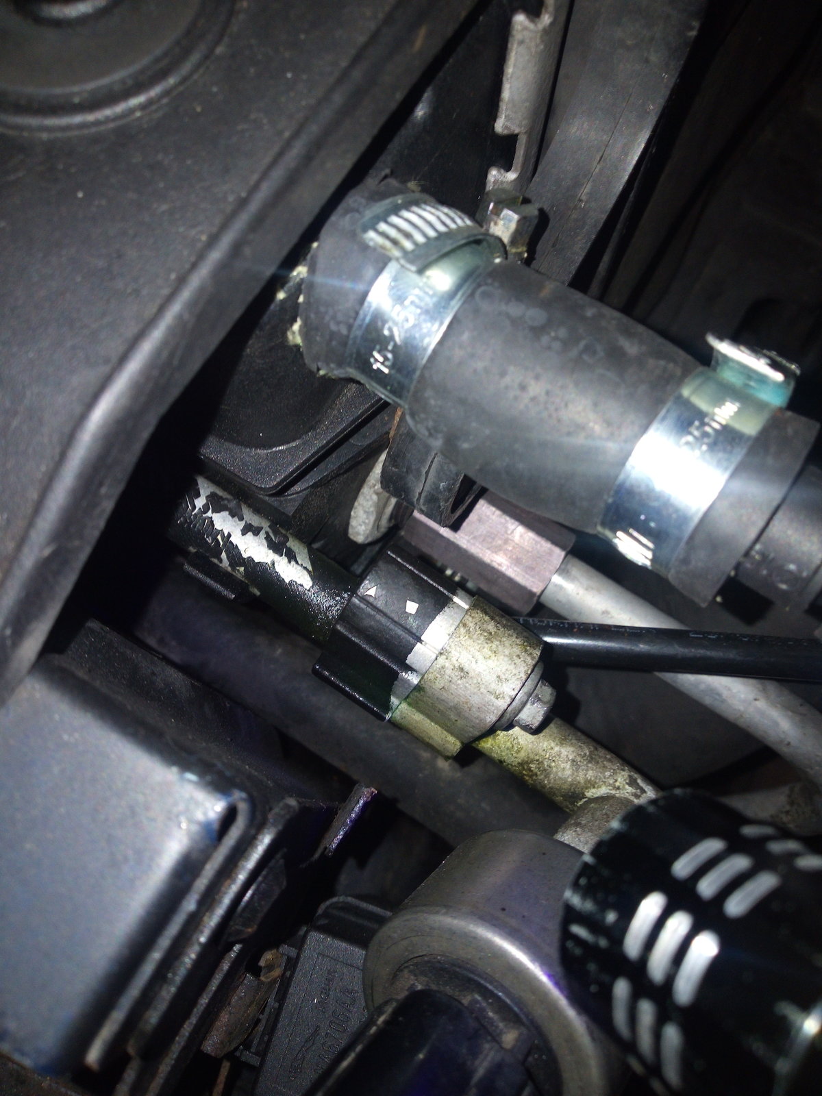

Other thing to check is the clamp for wear some allow the pipe to vibrare which ruins the register where the o ring sits. If you can wiggle any of the assembely signs are not great and your never get it to seal.
Will halfords recover and re use the gas then? Many places will charge a disposal fee to recover.
The AC work was done at kwikfit, no idea what they do, going to just turn up on the weekend and ask.
Hopefully this has the correct size
https://www.halfords.com/motoring/e...lSVYWKzzso4_lWYVNLzoslqNmWt9PB4hoCP0MQAvD_BwE
I'll just change it in the carpark and tell them to fill it back up
