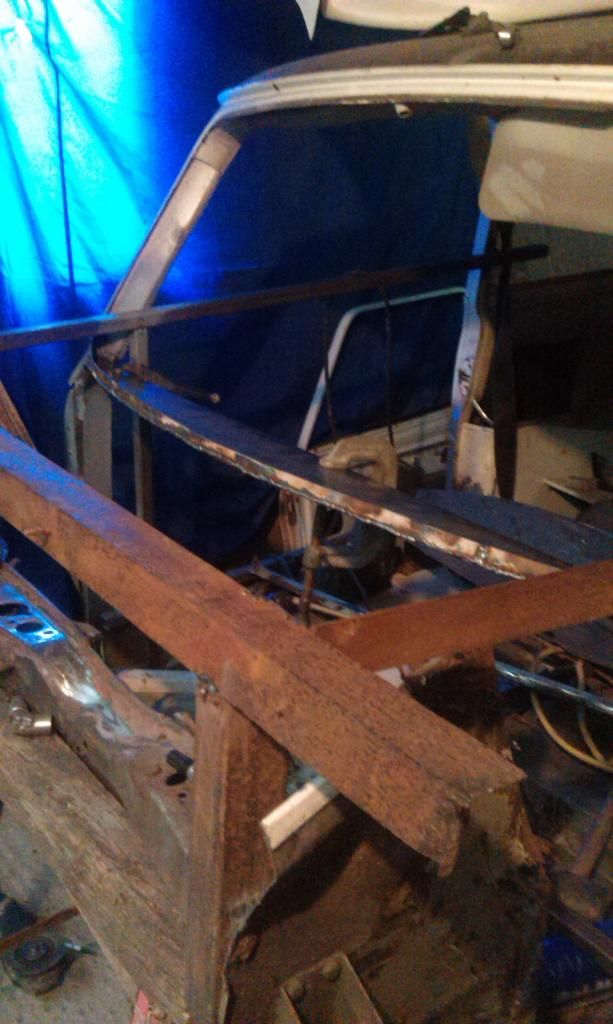

stumpy75 Member Messages 47 Location wales Sep 16, 2014 #4 Pic of where the panel will be going Aldo will form a full width bulkhead box.
stumpy75 Member Messages 47 Location wales Sep 16, 2014 #7 It will need to go down to the toè board join and then fan a new forgiare ime looking to get swages put into the panel for strength ad well
