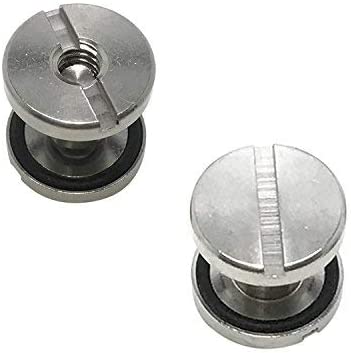

Due to the shape of the kit, the standard, low profile, fasteners used are known as bookscrews and they always have a very wide slotted head on each side. The slot is typically about 15mm long x 2mm wide.
I'm forever marring the screws as they're tightened quite frequently and I can't find a screwdriver bit wide enough.

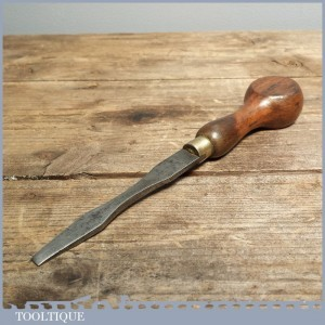

Up to now I've been using my Snap On Marine Drain plug screwdrivers which have a 13mm (1/2") x 2mm tip and do the job well. But they weight a tonne are a bit valuable to leave sitting around and I can't take them in hand luggage.

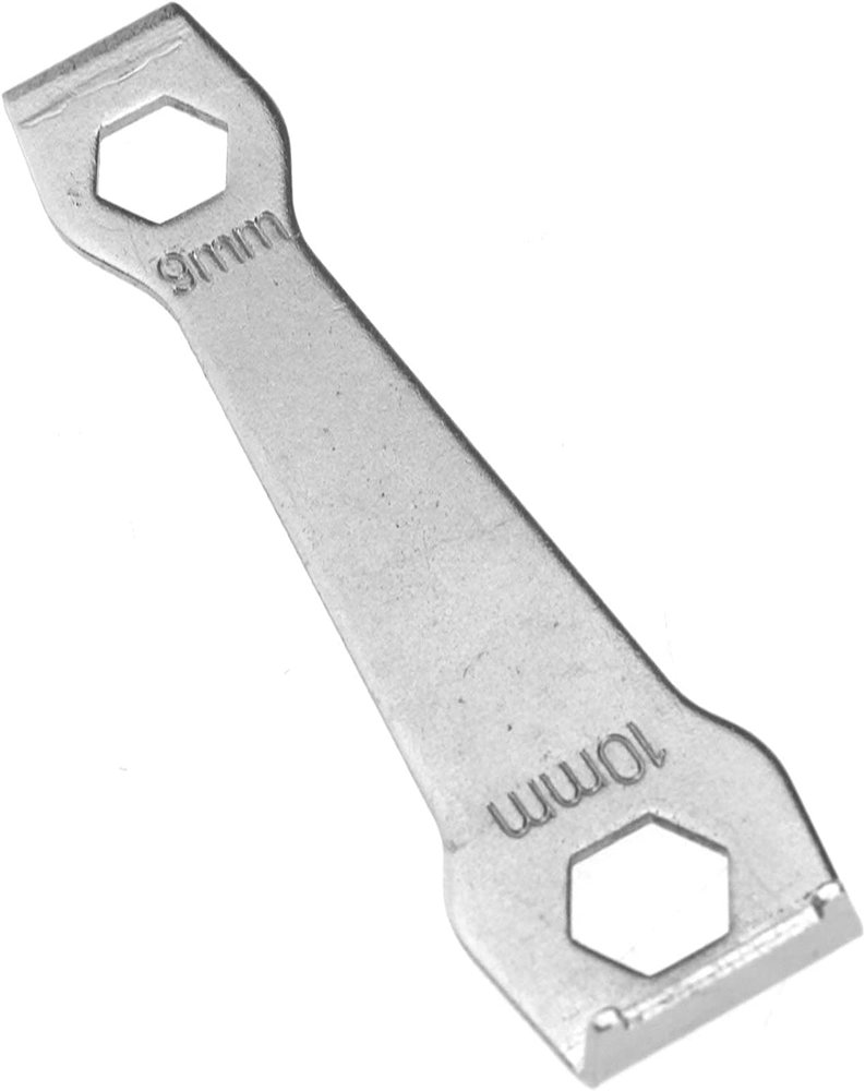

So I thought I'd make a pair of little drivers (there's a slotted head on both sides of the fastener - like a "sex-bolt") that I can put in my dive bag - I'm thinking something like the tools used for chainrings on a bicycle:
I can't just modify a chainring tool as they're usually only about 1.25mm thick and 10mm wide. But I do have a Stakesys metal folder for my vice so should be able to bend up a bit of steel.
It'll never see the same torque as a normal screwdriver (the fasteners are stainless and are just nipped up) but if I'm doing the job right I was wondering what would be the right type of steel to use? I'd ideally like to be able to fold it and still be left with a strong tip - I'm open to some form of heat treatment provided I can do it at home (have mapp gas, an IR thermometer and a domestic oven). I'd be looking for a type of steel that I could get in small quantities off ebay and that is available in approx 2mm thickness.
