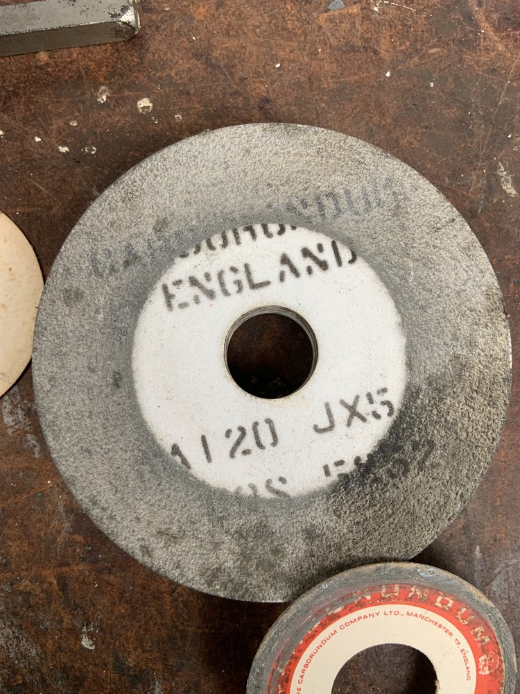

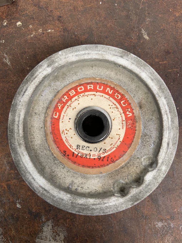

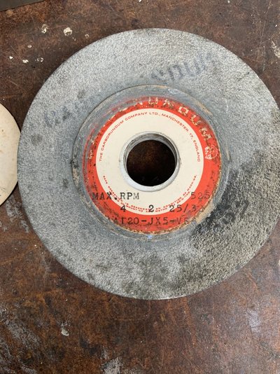

That’s one and the same wheel Pete, pictures of front and back.The first is for grinding on the side and the others on the edge. You could use any of them free-hand and 120 is a pretty good grit for putting an edge on a drill IMO. If you're doing 4-facet with a jig I'd be more inclined to use the first as setting the angles on a flat face is easy.
