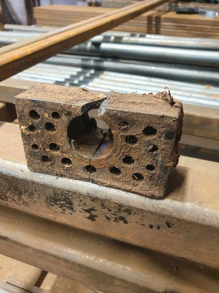

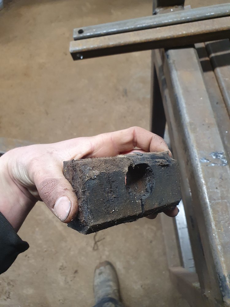

Just had a bit of a issue on my vehicle scissor lift!
Small bit of metal dropped down into the guide runners then when the lift was lowered got caught in the bush ultimately splitting it in 2
Its a 4200kg lift so fair bit of pressure on it

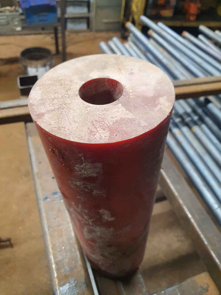

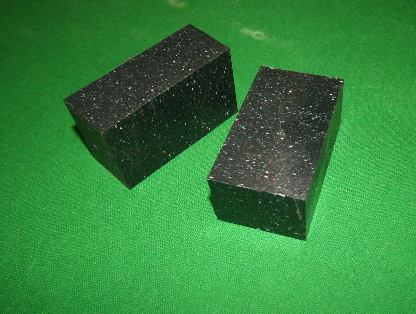

Attached a few pictures of the broken one and a few bits of plastic I've got around here but not sure if they'd be hard enough to make a new one from?

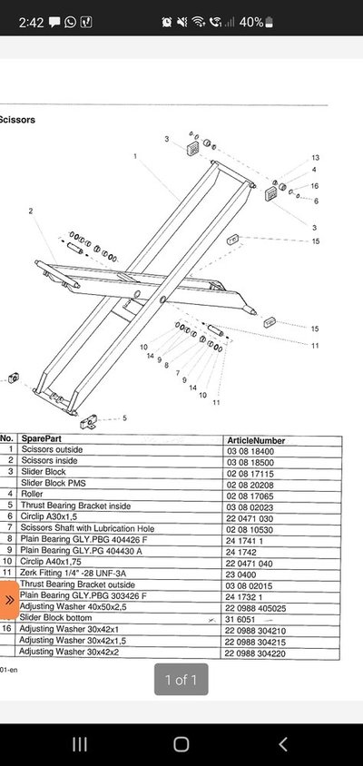

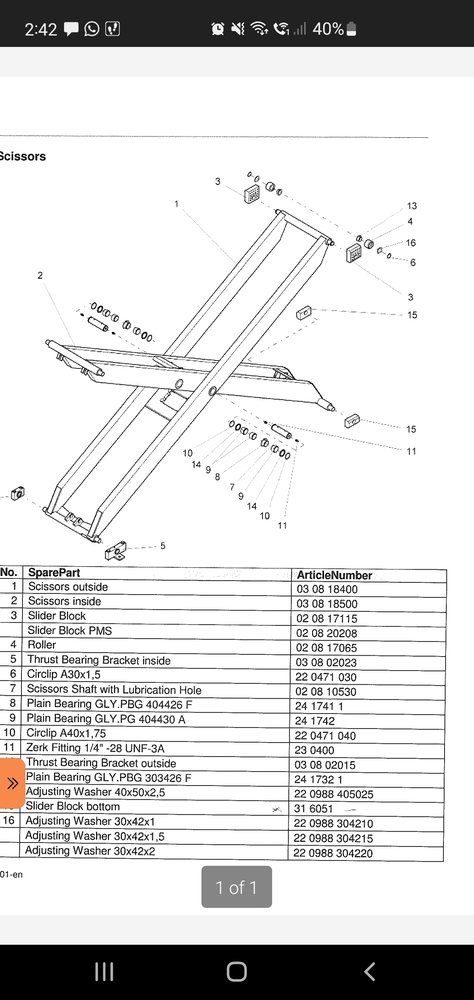

Part 15 on the attached diagram
Maha cant supply for approx 3 weeks!
If not has anyone got a small bit approx 100mmx 40mmx50mm i could buy please
