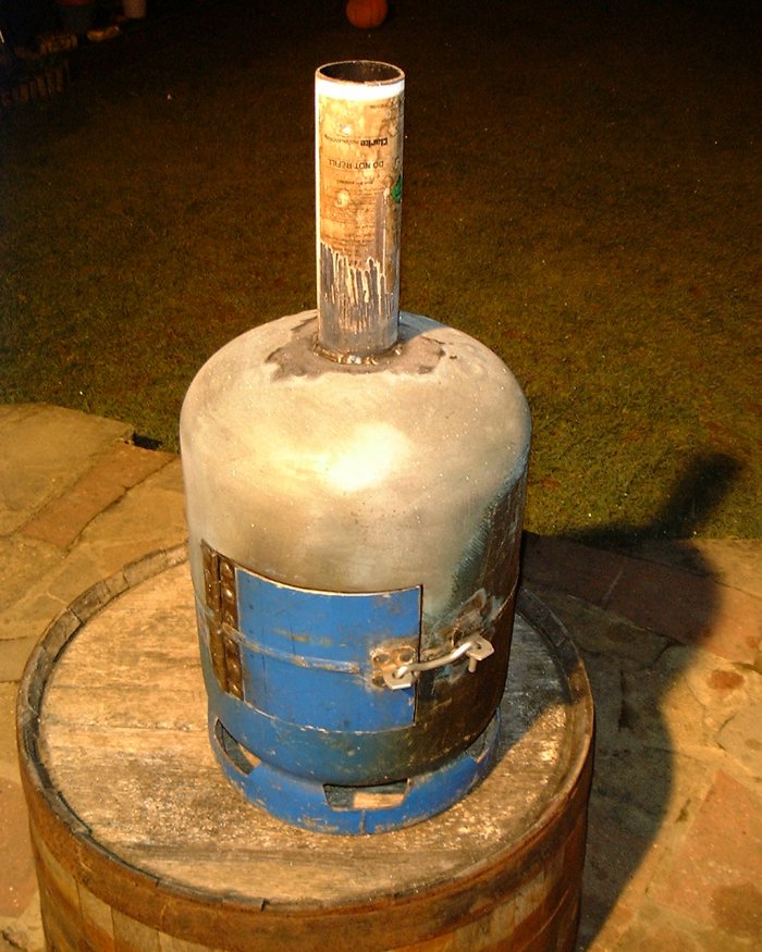

This weekend I was lucky enough to get two gas cylinders from Freecycle and so my project to build a log burner could start.
Managed to finish it off on Sunday and give it some test runs. Three times I tried it out and each time it eventually died back to smouldering. This occurred whatever the position of the door, even wide open.
What I did notice was that quite often the smoke would come out of the door and not a lot was going up the chimney. In retrospect I think the disposable gas cylinder for the chimney is too small (about 2.5" diameter). What is the collective opinion should I get some 4" pipe ?
I do intent to add an adjustable vent at some point but thought I could try it out by adjusting the door opening.
The next question would be where can I find some suitable pipe. Some of the fireplace companies sell flue pipe but its quite expensive and doesn't look very thick.
Thanks Aaron
