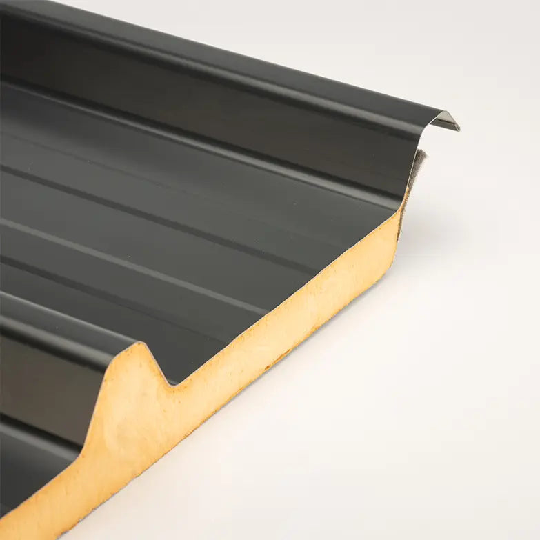

By the time you have bought insulation and decking it starts to make the £33 per square meter insulated box profile look very cheap. It would probably outlast any of the roof coverings.
40mm PIR Insulated Roof Panel – Anthracite Grey Polyester | FM Approved (1m Cover Width)Anthracite / 3.100m
Buy 40mm Anthracite Grey PIR insulated roof panels – FM approved, fire-rated, & in stock. Fast UK delivery, trade discounts, expert help available.www.colourcladprofiles.com
Bob
how do you seal the bottom edge where it meets the gutter? so the insulation isn't exposed?
need a new roof here soon and want to use those insulated sheets..... but there's a place at the other end of the road and their insulated roof is full of rats :-o
it's a garage and they don't really care... but can't have that happening here
I'm struggling to think of something that'll seal the ends and won't trap water
I want the sheets that are flat on the inside and corrugated outside...
my only real idea is cut them so the outside is an inch longer than the inside then have some trim laser cut and then bent at 90' so it overlaps the inside of the roof covers the insulation and fits around the profile of the outer sheets.... seams like a lot of faff tho
